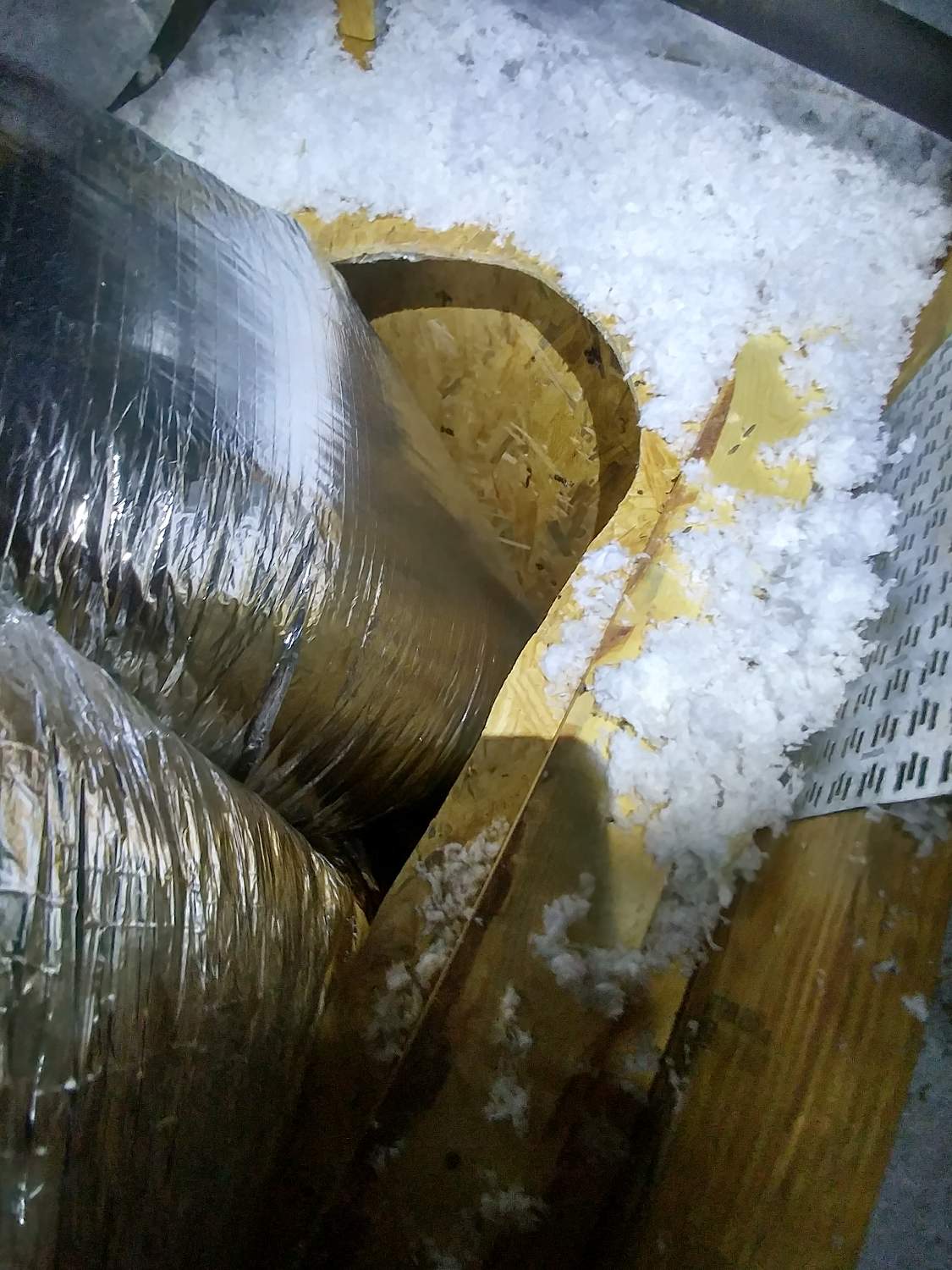

Firestopping at HVAC Ductwork in Chase
I encountered this on a new-construction inspection. Air handler in a closet with round, flexible ductwork penetrating the ceiling. Large gaps around the penetration. Some of the gap was filled with non-fire rated expanding foam.
How should this be properly installed? This kind of ductwork would burn or melt within seconds, rendering any firestopping irrelevant.
Any suggestions on how to call this out? I’m unsure of what the local codes require.
Since you local inspector knows the codes, what was his/her thought?
Well, getting through to one of them is a challenge. They are overwhelmed with work (it’s an overheated market here) and it’s nearly impossible to get hold of one unless they happen to be in the office when you call.
The builder’s response is generally “well, the local AHJ passed it so that’s all I care about”.
I’m more interested in the general practices called out by the IRC than what is locally required.
The question is really why flexible ductwork is permitted to pass through attic ceilings at all.
Plastic pipe goes through ceilings and walls. No fire rating on that stuff.
That’s a great point.
When they fire stop it’s more about preventing the air movement. The draft feeds the fire.
I recommended that the gaps be sealed and the area covered with insulation.
I hope that’s enough.
That’s perfect.
Thanks, everyone.
This is coming from an interior closet?
Is the utility closet sealed from the interior? If so, it is the fire stop.
What is the fire spread rating for flex duct? The duct must be metal if you need to seal the opening. Flex won’t cut it.

Your local code may or may not adopt this code. You need to check if your going to try to enforce it.
The fire rating of PVC is a lot more than flex duct…
What is the fire rating? Last I heard it’s a combustible material but hey I’m willing to learn new things. ASTME E 136?
The fire rating of the building component it passes through is what the fire rating of the duct must be.
The fire rating of a garage barrier is higher than the interior of the house partitions. Therefore 24ga metal duct or 5/8ths Sheetrock to protect the duct is required.
So I ask what the fire rating of the utility room/closet is. The HVAC can’t just be out in the room. If the closet has a 1 hr rating, it is protecting the flex duct penetration.
If this is too complicated to hold a conversation with the builder, maybe you should not have that conversation. As he said the AHJ allowed it and you have no authority above that.
