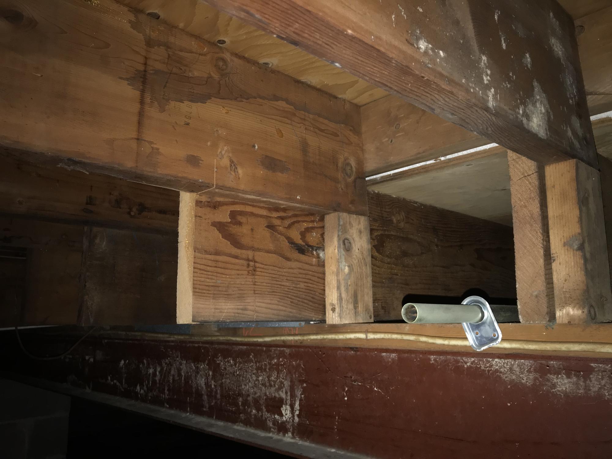

Has anyone seen this before? 2x4 blocking for a step-down living room. My concern is the load capacity and weak lateral restraint. I couldn’t find anything on the forums or internet.
I would like to see blocking between the lower joists for perimeter nailing, but other than that, I don’t see an issue.
