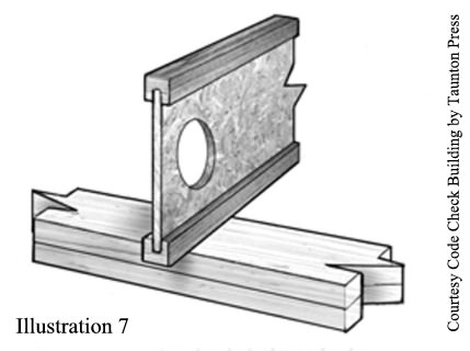

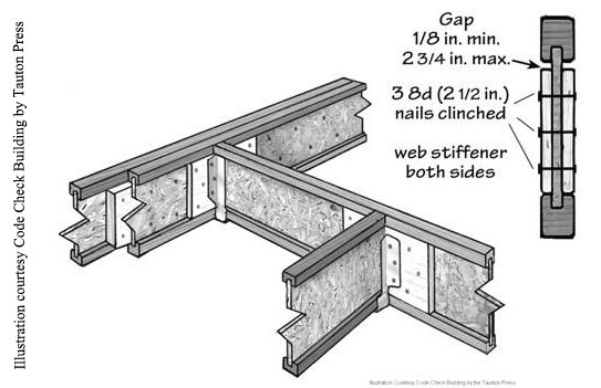

http://www.inspectorsjournal.com/forum/uploads/hausdok/2006613132939_IjoistsIllustration1small.jpg Where these joists intersect perpendicular to each other, as in a header See Illustration 1), web stiffeners are also needed to keep the hangers from bending and to assist in keeping the wood flush. Web stiffeners are rectangular pieces of plywood, or oriented strand board (OSB) that are placed between the I-joist’s flanges and the butted webs as a filler material.
Where wood I-joists lap or cross over a girder, beam or framed bearing wall, (depending on loads from above), the flanges must be protected from being crushed. Squash blocks and blocking panels serve this purpose (See Illustration 2). Squash blocks are pieces of 2" x 4" placed vertically on each side of the joist. These must be 1/16 inch taller than the top (compression) flange of the wood I-joist. Blocking panels are the same material as the wood I-joist but are set in place between the joists parallel with the beam. This spreads the floor loads fully onto the beam.

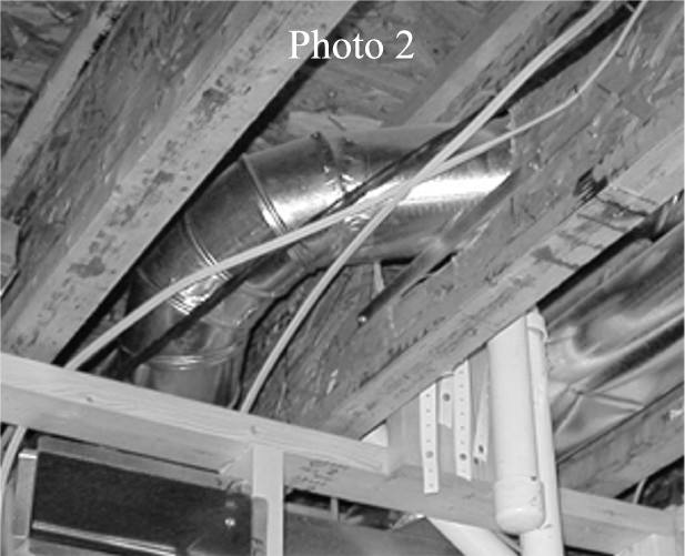

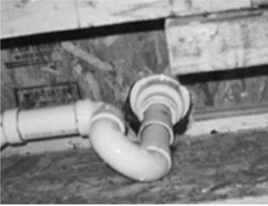

The top and bottom flanges of these joists (compression and tension respectively)should never be notched (See Illustration 3), cut (See Illustration 4), drilled (See Photo 1), or altered in any manner. Conventional framing lumber cannot be mixed with wood I-framing. (See Illustration 5). If it is, for instance at a band board or rim joist, the top flange of the I-Joist can be crushed.
http://www.inspectorsjournal.com/forum/uploads/hausdok/2006613141430_IjoistsIllustration3small.JPGhttp://www.inspectorsjournal.com/forum/uploads/hausdok/200661318524_IjoistsIllustration4small.JPGhttp://www.inspectorsjournal.com/forum/uploads/hausdok/2006613185421_IjoistsPhoto1small.JPGhttp://www.inspectorsjournal.com/forum/uploads/hausdok/2006613185717_IjoistsIllustration5small.JPG
Pre-punched holes up to 1 1/2" are normally placed along the bottom flange and are on 4-foot-centers to facilitate wire runs and plumbing runs. Any holes that must be cut through the web of the joist must be properly placed. The closer to the bearing point of the joist, the smaller the hole diameter allowed. Larger holes must be further from the bearing point (See Illustration 6).
http://www.inspectorsjournal.com/forum/uploads/hausdok/2006613185834_IjoistsIllustration6small.JPGhttp://www.inspectorsjournal.com/forum/uploads/hausdok/2006613185925_IjoistsIllustration7small.jpghttp://www.inspectorsjournal.com/forum/uploads/hausdok/200661319854_IjoistsPhoto2small.jpghttp://www.inspectorsjournal.com/forum/uploads/hausdok/2006613191029_IjoistsPhoto3small.jpg
Manufacturers provide specific directions for cutting holes that must be followed. To understand the principles behind the directions, it’s helpful to know the general rule-of-thumb is to multiply the hole diameter by 10 and create the hole that distance from the bearing point. Say a plumber needs to cut a 3" hole through a joist’s web to set a toilet’s waste line. The directions will guide him to cut at least 30" (3 x 10) away from the girder. A 3-inch hole only 12-inches away from the bearing point voids the warranty and will likely need an engineered design repair. (See Illustration 7 and Photos 2 & 3).

http://www.inspectorsjournal.com/forum/uploads/hausdok/2006613192037_IjoistsPhoto4small.jpgIn addition, I routinely find over-spanned joists where the framers failed to read the details on the plans. wood I-joists can be placed on 12, 16, or 24-inch (all divisible into 48") centers. Be aware that 19.2-inch centers are also allowed because 19.2" can be divided into 96" (48+48=96). Sometimes logic suggests this 19.2-inch center cannot be real. It is, and it can be critical. If the plans call for 19.2-inch centering and the framers set them on 24 inches, it’s a major error.
