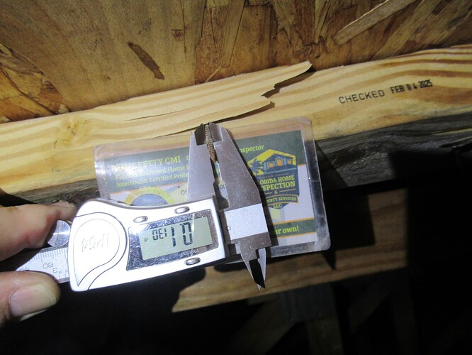

The saga continues, at least they used the correct roof sheathing. Pretty blue (wrong sized) nails.

Nice, these look like the correct roof sheathing nails, caliper check… yes correct diameter nails!
But hold on a minute…

Nice they used the correct nails for the sheathing installed.
Too bad it’s the wrong roof sheathing. SMH.

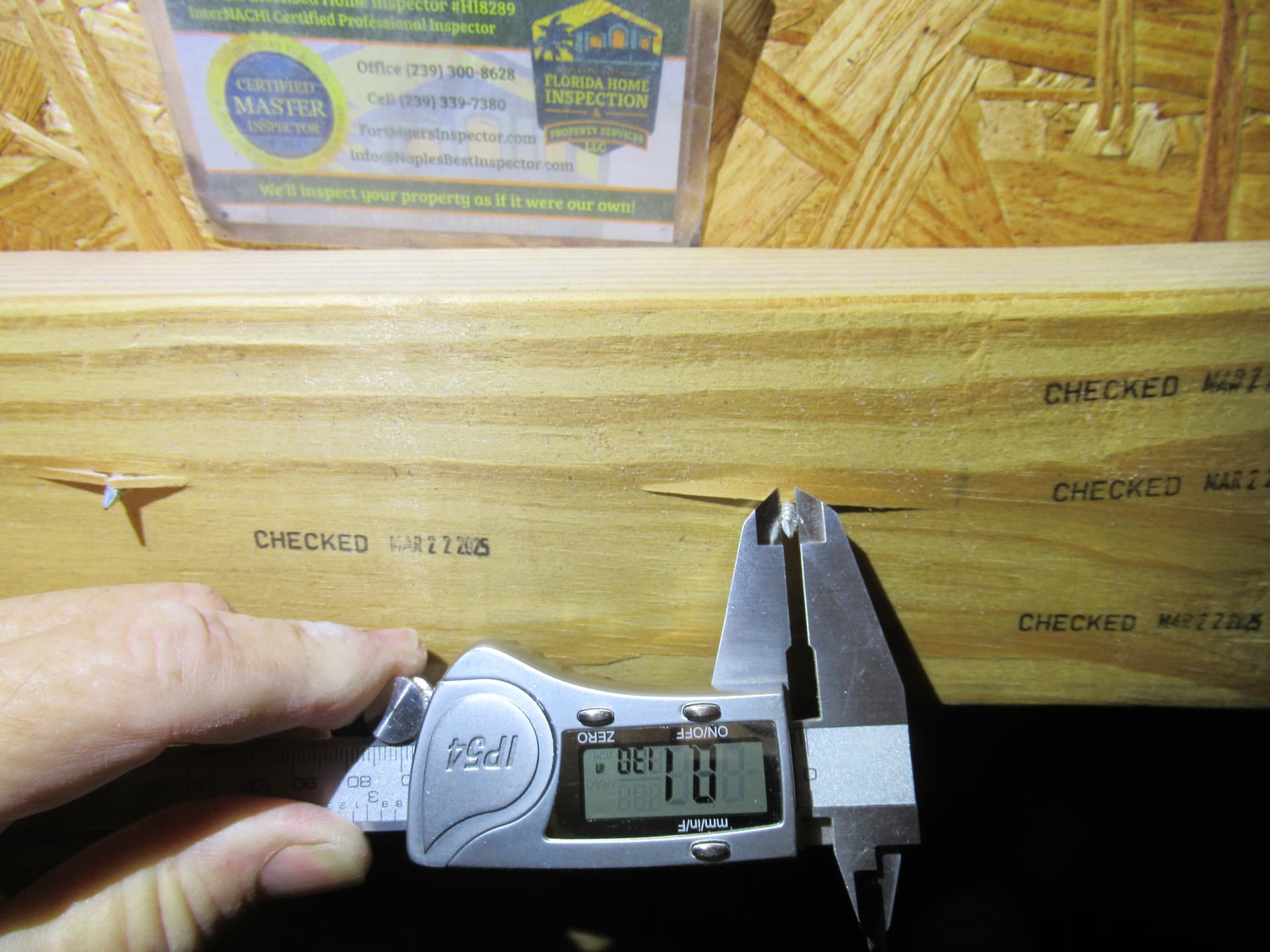

At least they used 19/32" plywood with this tile roof…

So this would be a correct installation then right?

No Sir. The roof sheathing is thicker than 15/32" and fastened with 0.113" x 2 3/8" nails. The fasteners should be minimum 0.131" x 2 1/2" ring shank nails.

Another improper installation.
