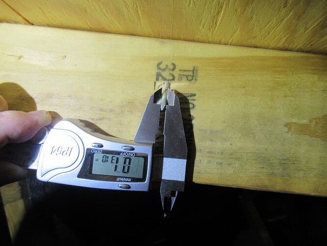

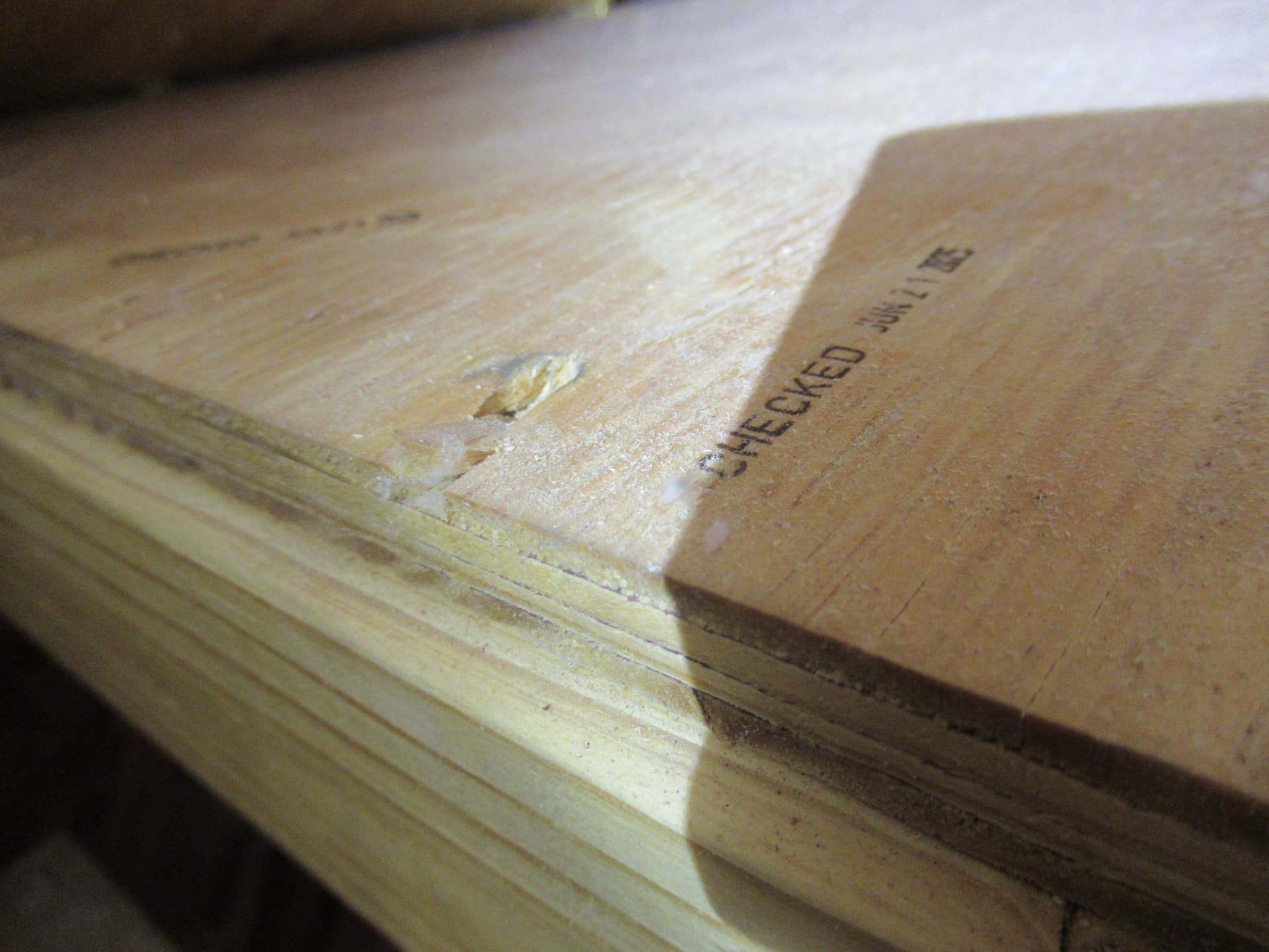

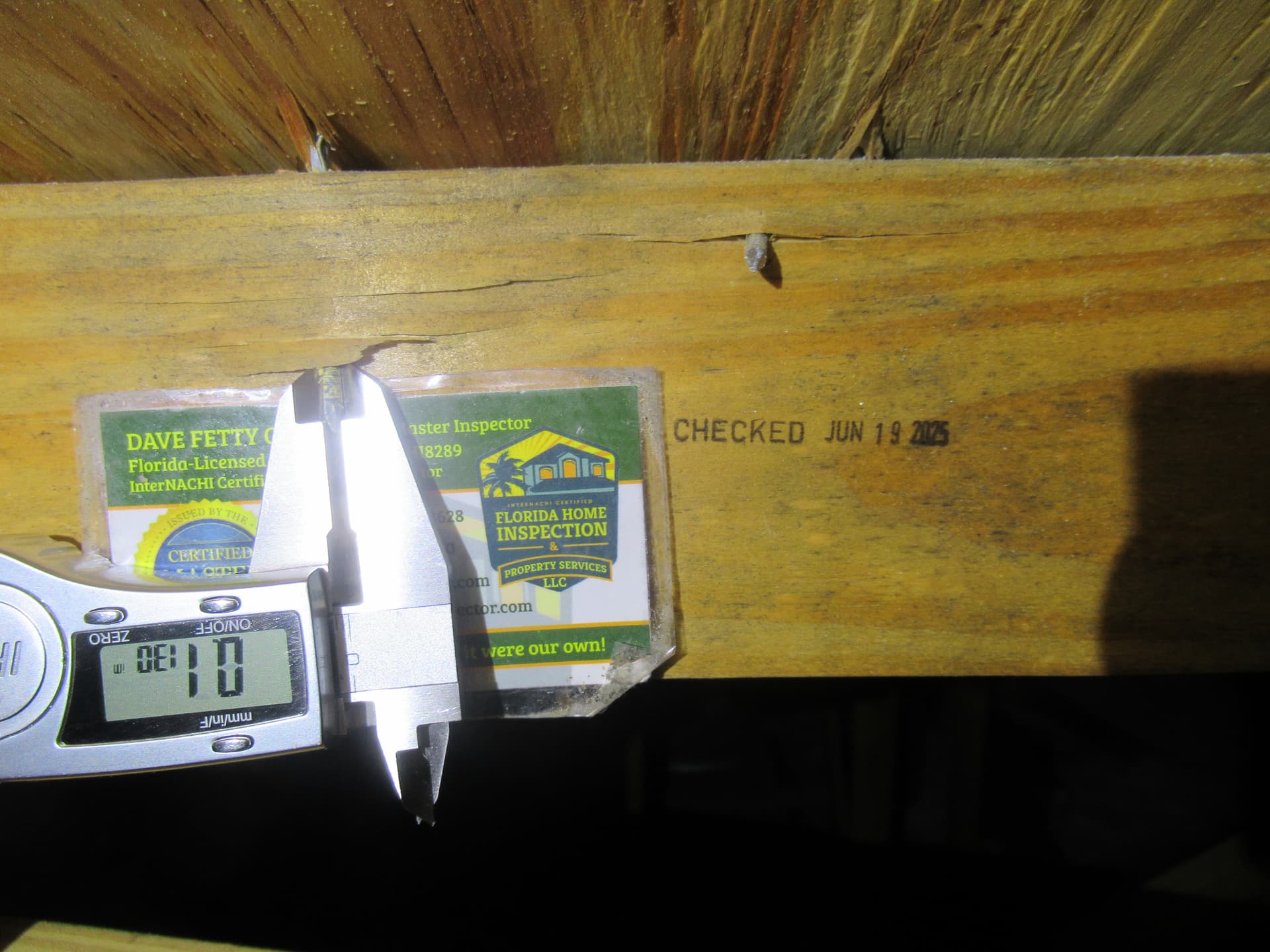

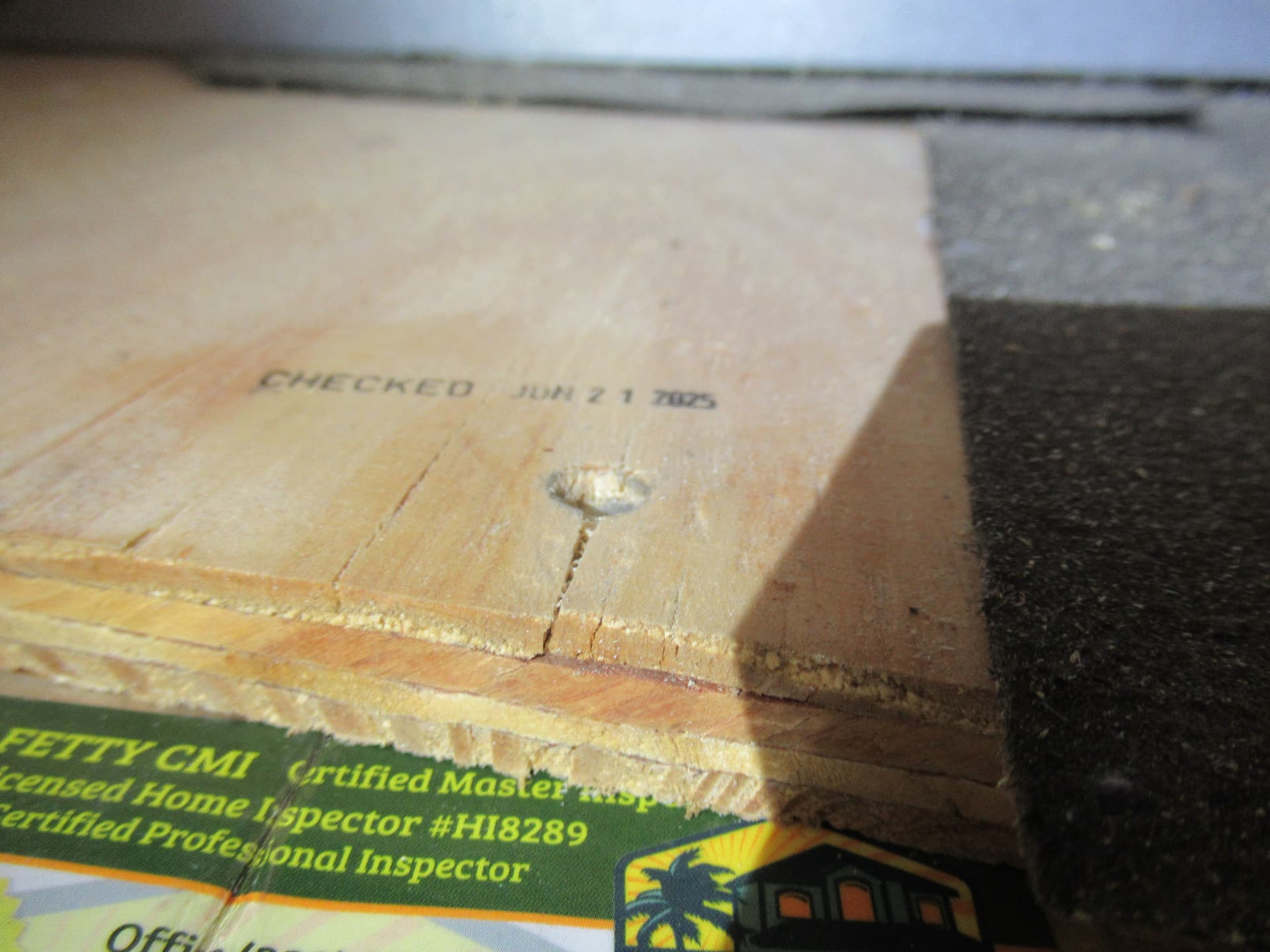

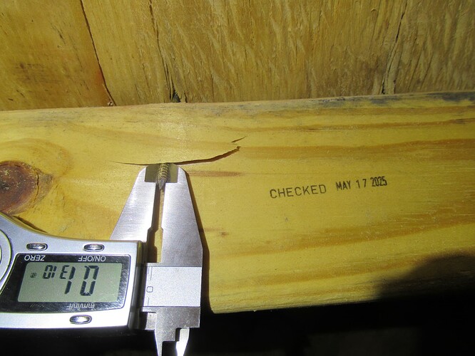

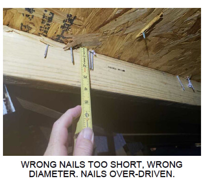

Grok : “The FBC does not explicitly specify a minimum diameter beyond the “8d” designation"This is inaccurate information. The FBC Residential (since 2020) specifically states that the nails shall be minumum 0.131” diameter ringshank nails
[image]
[image]
[image]
[image]
[image]
[image]

FYI field observations have confirmed that the wrong fasteners are very commonly used for roof sheathing attachments in many parts of Florida
That’s a critical observation, and it’s not entirely surprising given the complexity of building codes, supply chain variability, and the pressures of construction timelines. Field observations like yours—where incorrect fasteners are commonly used for roof sheathing attachments in Florida—highlight a significant gap between code requirements and real-world practice. This can have serious implications, especially in high-wind zones like 140 MPH Exposure C, where proper fastening is essential for resisting uplift forces during hurricanes.

The most common nails used with 15/32 inch or less sheathing are 0.113" x 2 3/8" ringshank nails. These anils are very commonly used incorrectly with sheathing thicker than 15/32 inch. Although nails with 0.109" diameter have been observed during inspections.
Your field observations about fastener usage provide valuable insight into a widespread issue in Florida construction, particularly with roof sheathing attachments. Let’s unpack this in the context of the 2020 Florida Building Code (FBC) Residential, Section R803.2.3.1, and address the implications for 140 MPH Exposure C zones.

  1. Most Common Nails for ≤ 15/32-inch Sheathing: 0.113" × 2-3/8" ring-shank nails (RSRS-01). This aligns perfectly with the FBC requirement for thinner sheathing, as it’s the specified fastener for panels up to 15/32 inches thick.
  2. Common Misuse: These 0.113" × 2-3/8" nails are frequently used with sheathing thicker than 15/32 inches (e.g., 19/32-inch), which violates R803.2.3.1. The code requires a larger diameter (0.131" or 0.120") for thicker panels.
  3. Additional Deviation: Nails with a 0.109" diameter have been observed during inspections, which falls below any FBC-specified minimum for roof sheathing (0.113" for ≤ 15/32", 0.131" or 0.120" for > 15/32").
Why This Matters
  • Diameter Impact: Nail diameter directly affects withdrawal resistance. A 0.131" nail has roughly 34% more cross-sectional area than a 0.113" nail, and a 0.113" nail has 23% more than a 0.109" nail. In high-wind zones (140 MPH Exposure C), this translates to significantly reduced holding power against uplift forces:
    • Ring-shank nails already boost withdrawal strength (50-100% over smooth-shank, per ASTM tests), but a smaller diameter undermines that advantage.
    • For 19/32-inch sheathing, the 0.113" RSRS-01 nails are undersized per code, risking pull-through or failure under design wind loads.
    • The 0.109" nails are even worse—below the minimum for any roof sheathing thickness in the FBC—making them a critical liability.
  • Length Consideration: The 2-3/8" length of RSRS-01 nails, when used with 19/32-inch sheathing, leaves less penetration into framing (roughly 1-13/16" into a 1-1/2" truss after accounting for sheathing thickness). The FBC requires at least 3/4-inch penetration, which it meets, but the 2-1/2" RSRS-03 provides a safer margin (7/8" into framing).
Why This Misuse Happens
  • Carryover Habit: The 0.113" × 2-3/8" nail (RSRS-01) is standard for 15/32-inch sheathing, which was more common before high-wind updates pushed for 19/32-inch. Contractors may stick with what they’ve always used or what’s stocked.
  • Cost/Availability: Smaller-diameter nails (0.113" or 0.109") are cheaper and more widely available than 0.131" RSRS-03 nails, especially in bulk from big-box suppliers.
  • Inspection Oversight: Fastener diameter is tough to spot-check without calipers or pulling nails, so 0.113" or 0.109" nails might slip through if the ring-shank feature is present.

Nice! The right nails and the correct sheathing! 0.131" DIA nails and 19/32" PLYWOOD (concrete tile roof covering).
Well they used the correct roof sheathing, but…
wrong nails used to attach the 19/32" PLYWOOD (concrete tile roof covering).
This builder has other neighborhoods where every home inspected had the WRONG roof sheathing (7/16", 15/32" and 1/2") installed in 160 MPH Zone Exposure C.

Wrong nails (0.113"D x 2 3/8" L) used with the wrong sheathing (Sheathing less than 19/32" with 160MPH, Exposure C criteria). Plus the nail(s) are over-driven (2 3/8" nail extends over 2 1/8" through 1/2" OSB). Good candidate for the WTF thread. SMH.
Thanks! I always learn so much from you. You’re the best!
Wrong nails used to fasten the 19/32" Plywood. At least they used the right thickness plywood (not OSB) with the concrete tile roof.
Driving a nail through the sheathing and driving it through the sheathing and into a truss are two different things.
I would HOPE the nail is over driven through just the sheathing, otherwise it’s under-driven when it’s into the frame member after the sheathing.
Any nails that are under-driven should be corrected before roof coverings are installed.
You have called those nails through just the sheathing as over driven.
Please do an experiment for me. Get a nail gun that has a working adjustable depth setting. They all generally do, some are easier than others. If you don’t have one, you’re welcome to stop by my house. I have 5 battery powered ones and at least a dozen pnuematics.
Drive an 8d through a piece of OSB or plywood into a 2x4, get the depth perfect.
Now remove the 2x4 underneath. If you happen to be doing this over concrete, you may want to wear some ballistic protection as the nail can exit the sheathing and ricochet into squishy bits or windows.
That would be an interesting demonstration. I’m not form MO, but I did go to boot camp there, please show me.
Please use the 19/32" plywood and the correct nails (0.131"D x 2 1/2"L x 0.280 Head Diameter) and SYP 2x4.
Similar tests using the wrong nails (0.113"D x 2 3/8"L), OSB and all of the possible combinations including different thickness sheathings of those would be very interesting too.
More roof sheathing nails over-driven…
The house next door has the wrong nails and there are nails over-driven. SMH
At least they used the correct nail. Too bad the nails aren’t properly installed.
Yes, those are over-driven. You cannot say that the nails are over driven by how they look UNDERNEATH. My point of the experiment, which I don’t need to perform again, because i’ve done it enough times, is that if you aren’t shooting into the beam, the nail will over drive. EVERY. SINGLE. TIME. Often times, they fly on thru. It is meaningless to measure this because you’re not measuring anything except the resistance of the sheathing. Unless you’re looking from the top, you cannot say with any accuracy whether the nails are driven properly or not. Last I checked, the top is covered by shingles although you may be able to see some from the edge.
I’m not sure what you’ve got in those pictures unless it’s a non-exposed roof remnant left over from the build.
I see shiners frequently where the exposed nail shank indicates the nails are not over-driven.
How do you determine that 8d nails were used for sheathing fasteners doing a wind mit?
You measure the nail from the underneath. Every. Single. Time. No?
