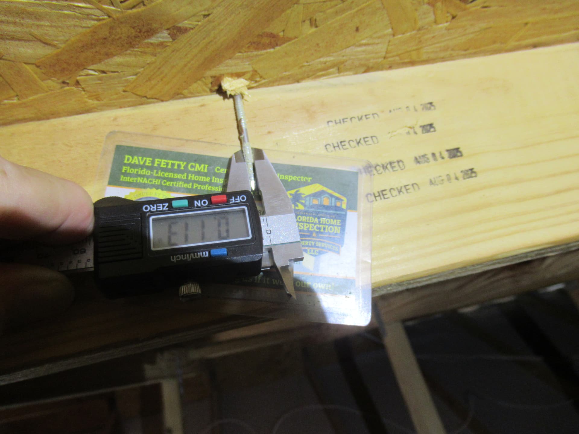

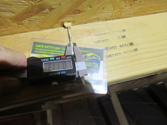

If it is hanging in space and didn’t contact the beam, that fastener would be under-driven going into the beam. They may have an apprentice running over the deck and pounding any heads down.
Because even an overdriven 6d isn’t as long as a 8d, even an under driven one. A 6d that measures as long as an 8d would fall out. Also, pretty much every time I’ve seen a 6d, they’re smooth shank and not ring shank. I’ve also seen staples, but that’s pretty much gone any more as all the homes that had them have been re-roofed in the last couple years.

If a nail does not meet the resistance of the rafter, it will be over driven every time.
Shooting a nail into cardboard will fly right thru. Shoot a nail into steel it will not penetrate. Shoot a nail into plywood will go deeper than shooting a nail into plywood and a rafter.
If you adjust the pressure to get the shiners at the correct depth, the gun will never properly seat a nail into the plywood with a rafter.
I hope someone does the experiment soon. I will be happy to be wrong.
I understand what your saying. I see both scenarios frequently.

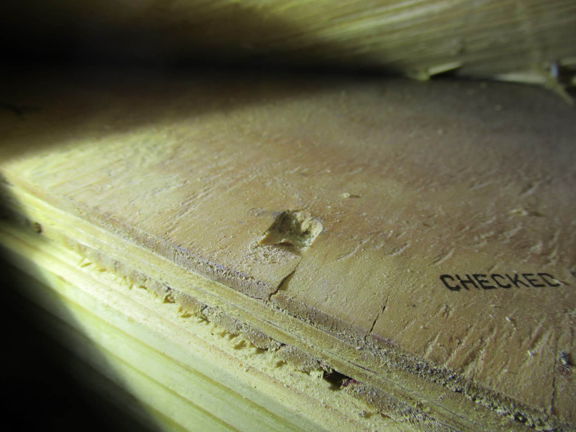

We can all agree that this is an over-driven nail.
The first time (several years ago) I brought this topic up (in an attic) at a “meeting” with a big builder it was to point out that the wrong nails (too short) were used for sheathing fastenings. The fast talker immediately claimed the nails were not too short, they were under-driven. I looked at him and said “well that’s a problem then”, he shut-up. That prompted me to get the 4 digit accurate caliper, I then began measuring nails at every inspection possible. Many times the nails are properly driven, many times they are not.
Bottom line, there are systemic roof installation defects ongoing in my area. I have seen some improvements recently from some builders.
