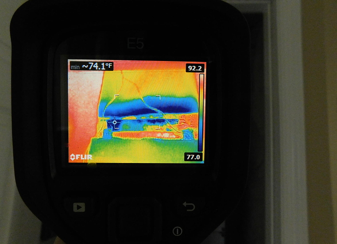

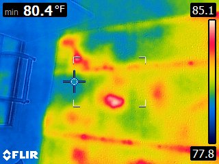

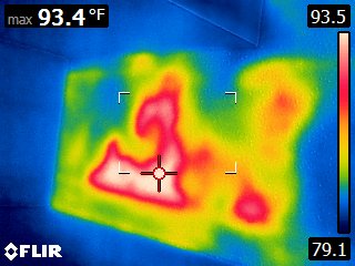

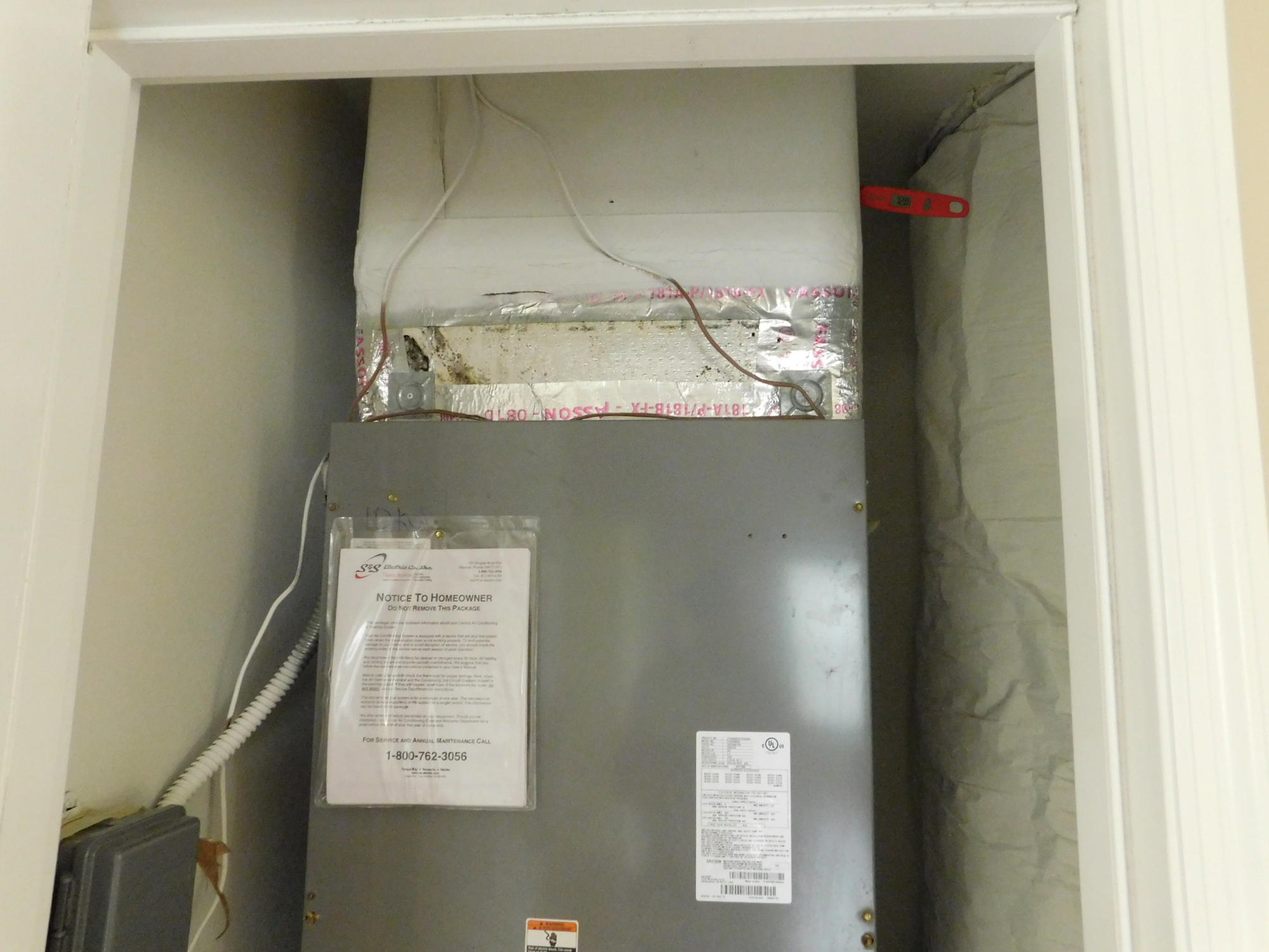

I thought it might be fun and helpful for us to share IR photos that led us to discover and/or confirm problems in a home. Ideally, each photo should show some kind of temperature anomaly, the hypothetical cause, and how that hypothesis was proven, or as importantly, dis-proven, and how it was covered in the report.
I’ll start with this one from a recent inspection.
These photos show with what appear to me to be “trails” in the thermal signature. Having seen this pattern in attics that had rodent droppings, my hypothesis was that there was a past or present rodent infestation.
In the attic I found the areas above had insulation packed down in “trails”, consistent with the patterns found when rodents have been moving about. I also observed a few rodent pellets. I did not excavate.
All that was enough for me to state that there was a past or present rodent infestation, but the tenant overheard me talking to the buyer about what I had found and he piped up “yeah, I hear things moving around up there, but I’ve never seen anything”. That pretty well cinched it.
Final determination was, based on thermal patterns, packed-down insulation, observed rodent feces, and statements by the tenant, that there is an active rodent infestation and a professional exterminator needs to be called in.

Why would the trials be hot?
I don’t think what you are seeing are from rodents…
(Bradley K. Toye, CMI) #3
Where are the associated digital pics?
(Jeffrey Moore, AZ#49250) #4
Trails would show as an elevated/cooler temperature (depending on season) due to decrease/disruption in insulation allowing attic temp to show in house
(David A. Andersen, TN HI# 40) #5
Compressed insulation (observed and verified) increased density which increases thermal conductance. It is summertime in Texas!

(William B. Ogletree, TREC License #22530) #7
Jeffrey’s answer would be mine: Trails would show as an elevated/cooler temperature (depending on season) due to decrease/disruption in insulation allowing attic temp to show in house.
Heat in the attic transmits more easily through packed-down insulation than non-compressed insulation. When rodents burrow into the insulation, they create voids which allows hot air to come in contact with the ceiling drywall. If not rodents, then what? I can think of nothing else that would create the trails I am seeing.
Also, every time I have seen these patterns, I have found other evidence of rodent infestation.

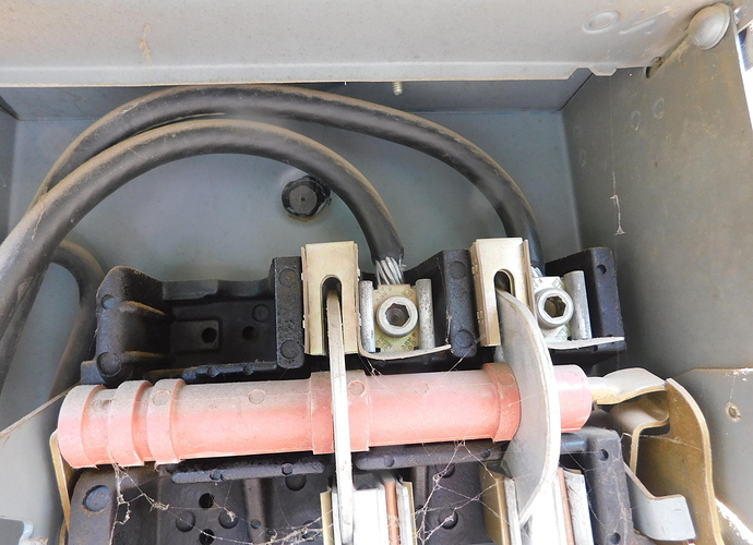

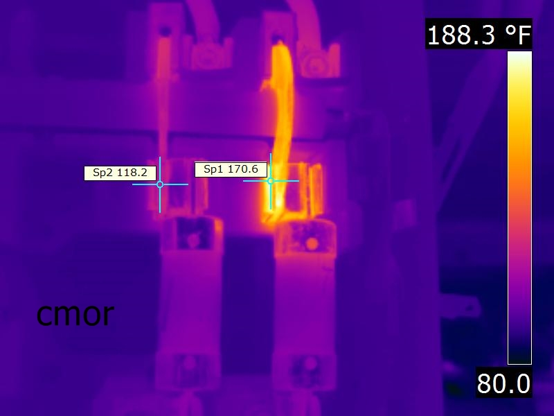

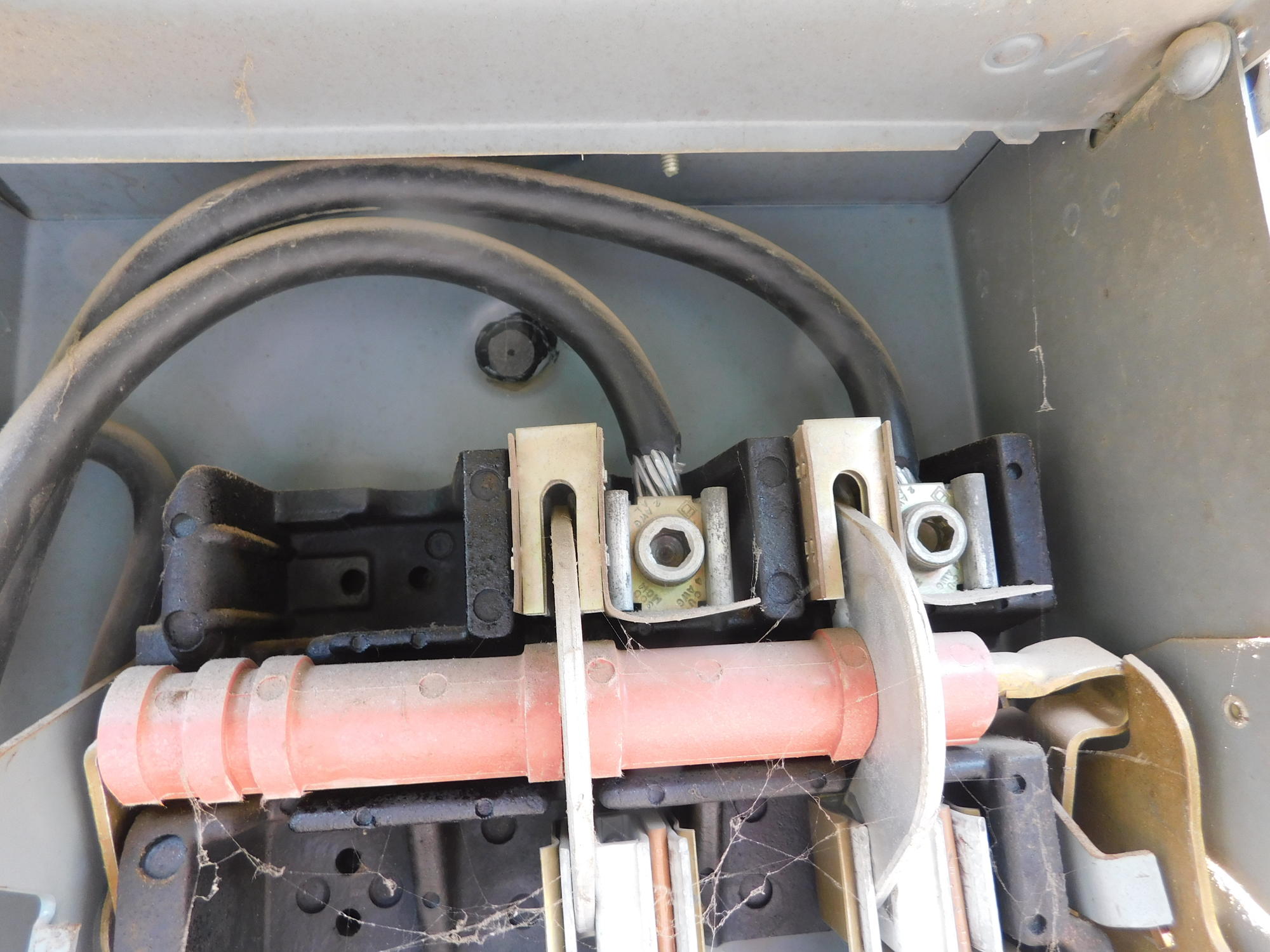

William here is one just for you found this morning on a 5K home. I don’t leave my camera in the case on a home inspection. How would I know if that knife blade was loose by looking at it. I guess if my name was JJ I could of touched it with my tongue:shock:

Good stuff, Charley. Thanks!

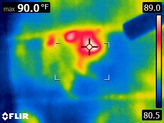

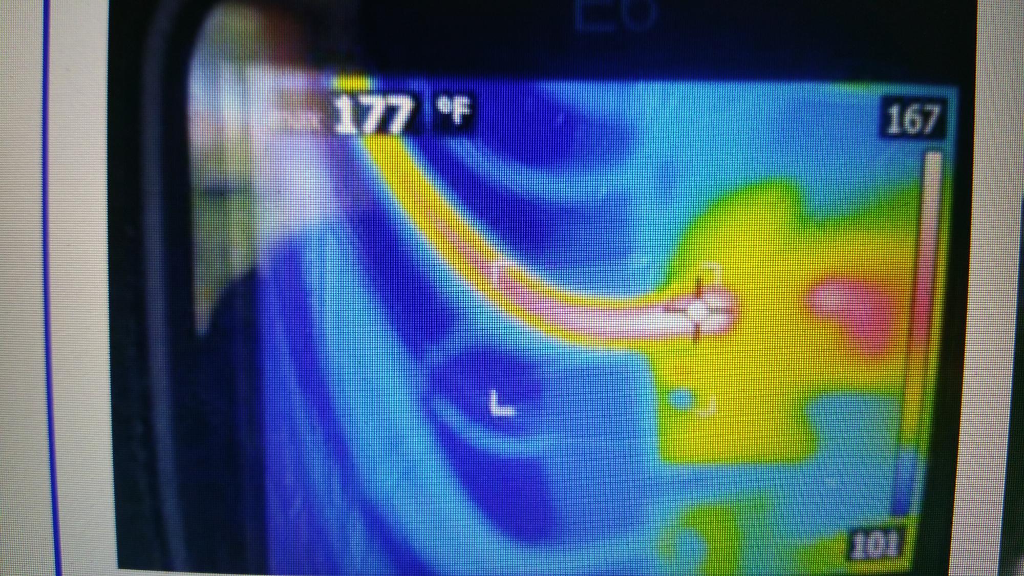

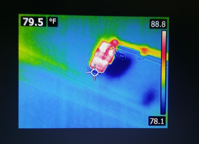

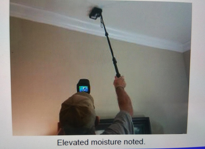

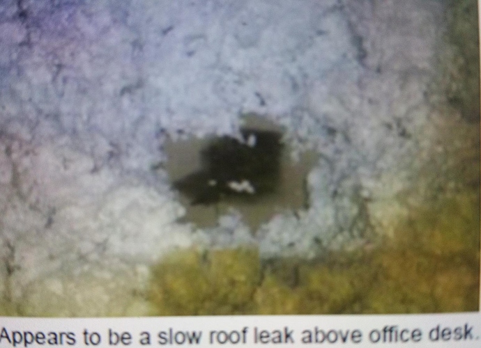

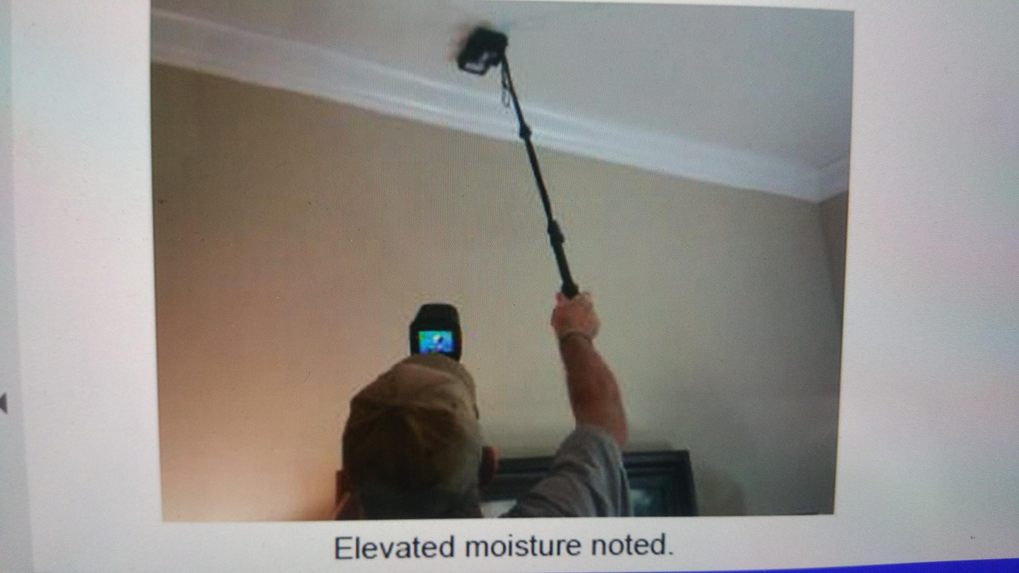

Found this slow roof leak last week and this loose connection the week before. Never ever would have found the roof leak without IR, no stains or any other signs… the leak was confirmed with moisture meter and found and documented in the attic as well, may have caught the loose connection without IR, but it popped right out with IR.
(William B. Ogletree, TREC License #22530) #12
Dave, what is the item in that second photo?
(Dave Fetty, CMI) #13
Slow leak in the roof. confirming with Tramex moisture meter on extension device.
(Dave Fetty, CMI) #14
Confirmed with moisture meter and visually in the attic.

(Dave Fetty, CMI) #16
I am so glad it started raining again! We went about 6 months after Irma with no significant rain. This one was a very slow roof leak that would have taken months or years to show itself.

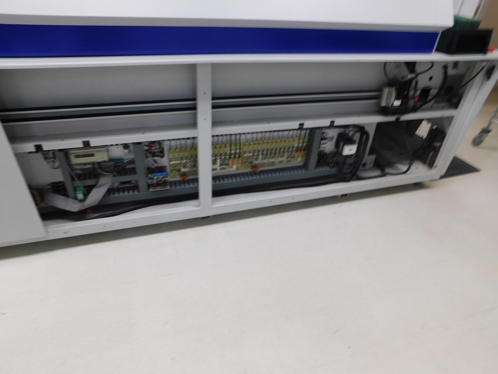

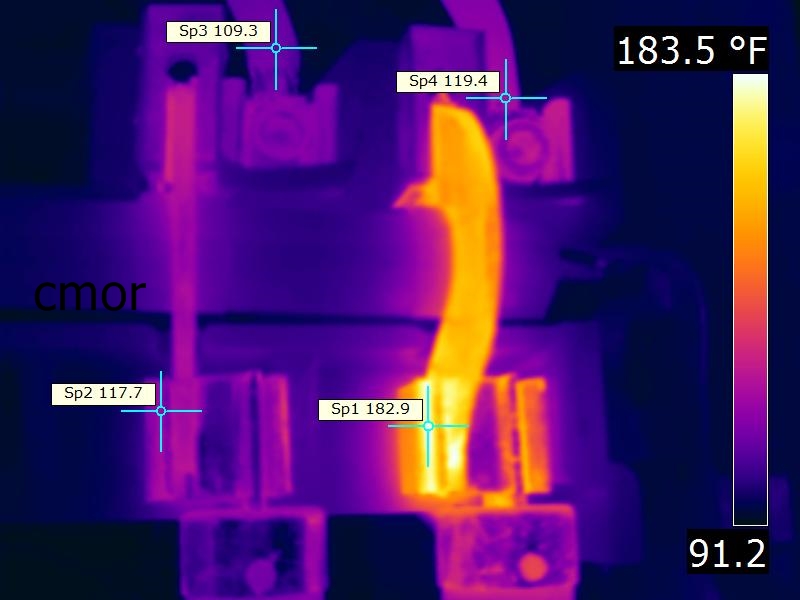

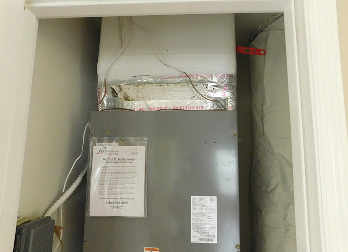

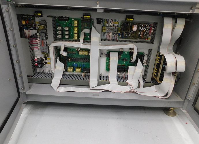

This thermal job lasted about two hours onsite but required 7 hours drive time to and from the job site. In my area this profession requires windshield time.
The thermal image is of two small fuses with the same amp draw on each leg thus the temp should be the same on both. The first digital is the location of the fuses the remaining digitals are some of the machine controls that were imaged.
This is where the money is in this profession. Waving a thermal camera around looking at walls and hand prints during a home inspection makes you no money.
If you are serious about this business buy professional cameras get professional training and make professional money.
