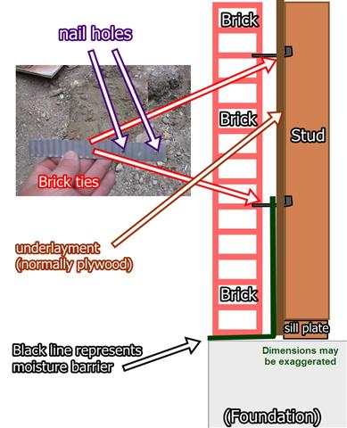

If that is brick veneer where is the flashing?

Weep holes should be at the bottom but the grade could be a concern which will not be solved long distance.

The more I look at that picture the more I wonder about the brick ties.
Also keep wondering about the length and height .
Should not be more than a few stories tall I hope.
Also could need control joints.
