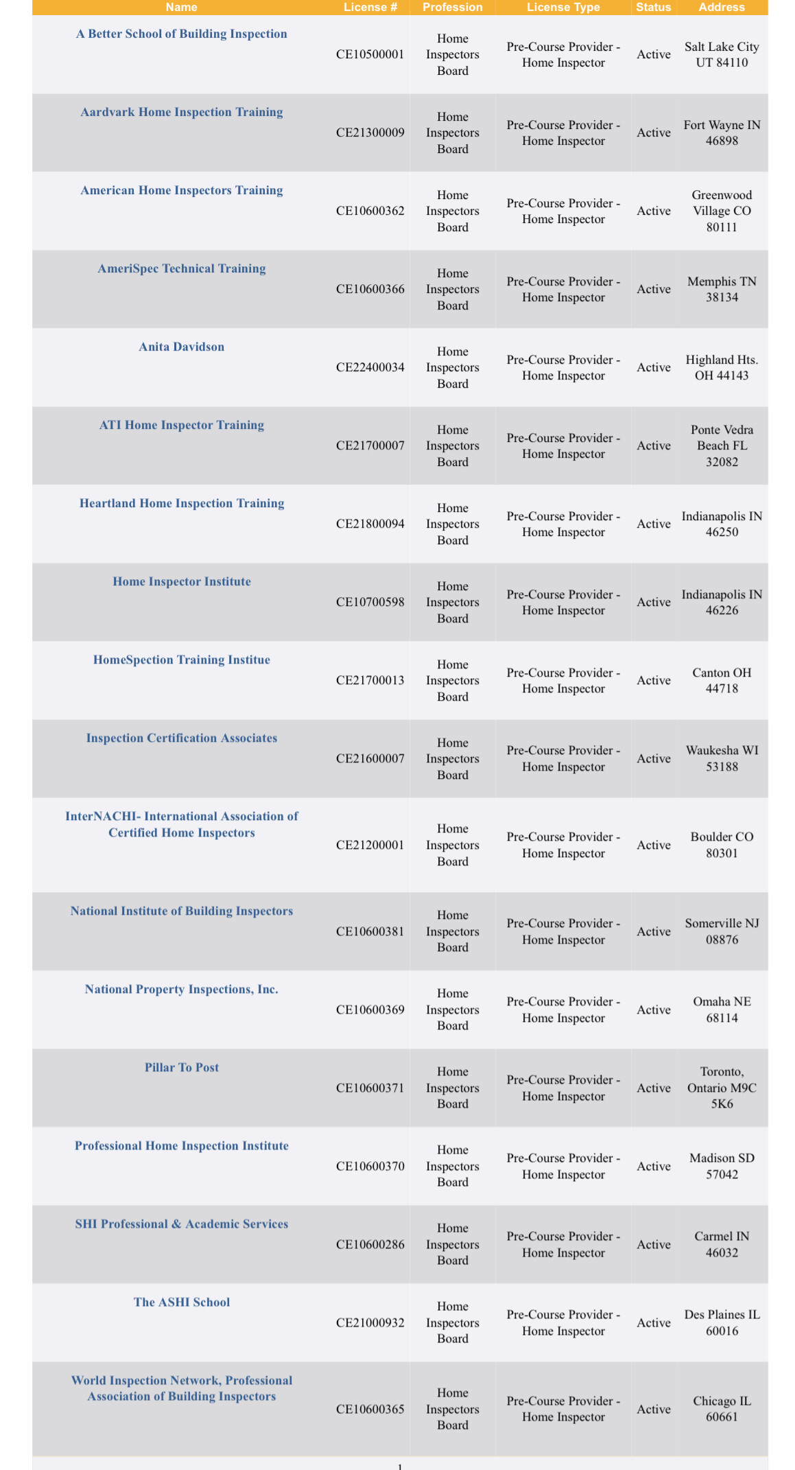

You can use this Verification Tool to find an approved facility.
You will get a list that looks like this:
It is also important to know that only a few of the approved providers listed offer the 12 hours of practical experience as a stand-alone service. An InterNACHI member did the research a few years ago and concluded that only three providers offered just the 12 hours. Keep in mind, this list is from 2020.
