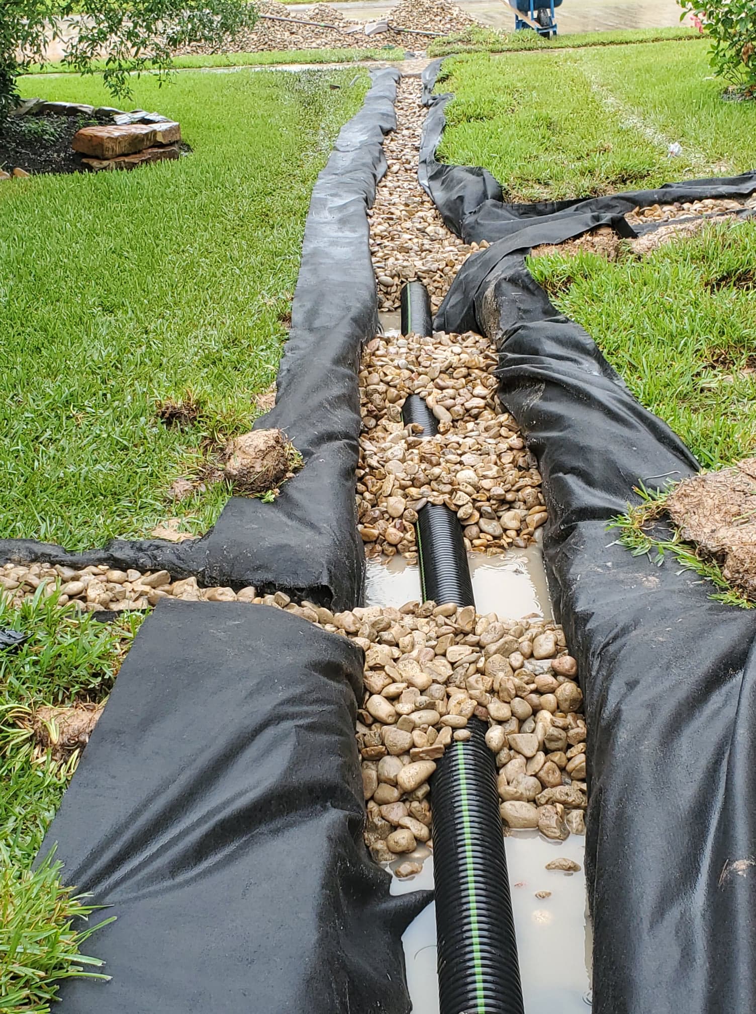

Kulraj, this type may work keeping the moisture out of the crawl space:
Hi thanks yes its the same type as photo

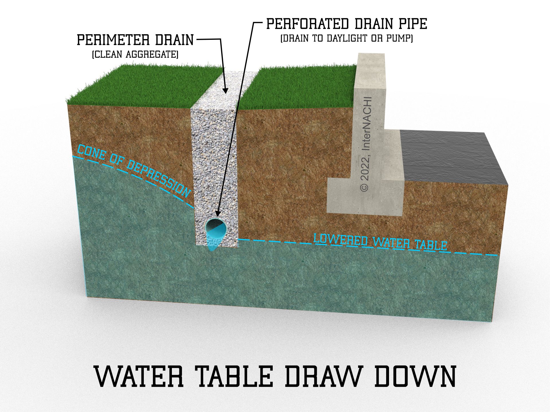

One option is to put a French drain around the perimeter of the foundation that terminates below the footing level to intercept the ground water and lower the water table. Drain to daylight if possible otherwise drain to a sump pump.
