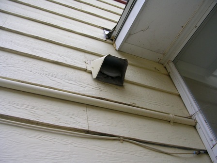

This is where it terminates on the outside wall of the home. I wrote it up as needs further evaluation to determine the acceptable method of venting of this particular water heater.
That’s not an appropriate vent either.
Can not tell from the picture but if that is an operable window that vent would be to close to the window. Either way the window to siding joint may not be properly sealed to prevent exhaust fumes from entering.
If the soffits are also ventilated then that vent is exhausting to close to the soffit vents.
Not sure what that conduit is carrying but with the exhaust venting downward onto the conduit it may also be a potential issue/hazard to what is run in the conduit.
