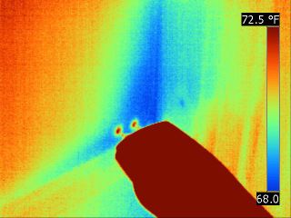

What is all the blue water in the corner?:wink:
Yes, this is a moisture meter (but a contact temp device acts the same).
One of those Charley B. shower pan tests (days later)…
Checking to see if things dried up in a follow-up inspection.
