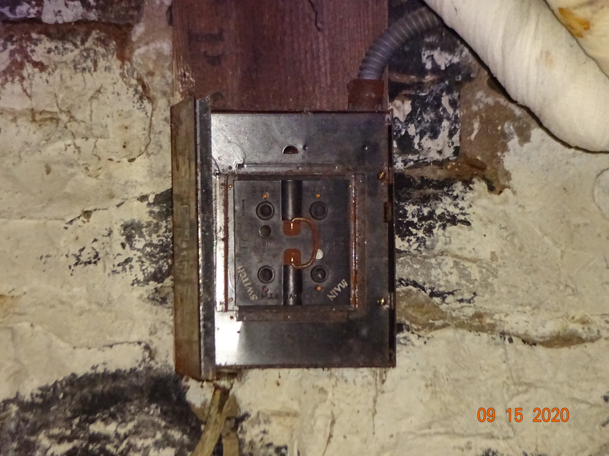

Help calling out defects for this new inspector Again!
Would like a little assistance with calling out all the defects in this panel & the amperage of the system.Im thinking it’s a 200 amp system but all the signs of a 100 amp system are present including the meter .So I see the doubled up neutral wires & im wondering if I should say that the old cloth type conduit should be listed as a fire hazard and needs replacement,also there appears to aluminum solid branch wiring but may just be coated thank you for any & all help with this inspector brothers !!

It looks to me like that’s a 100AMP panel
As for issues I think you could safely use a narrative like this to sufficiently cover yourself:

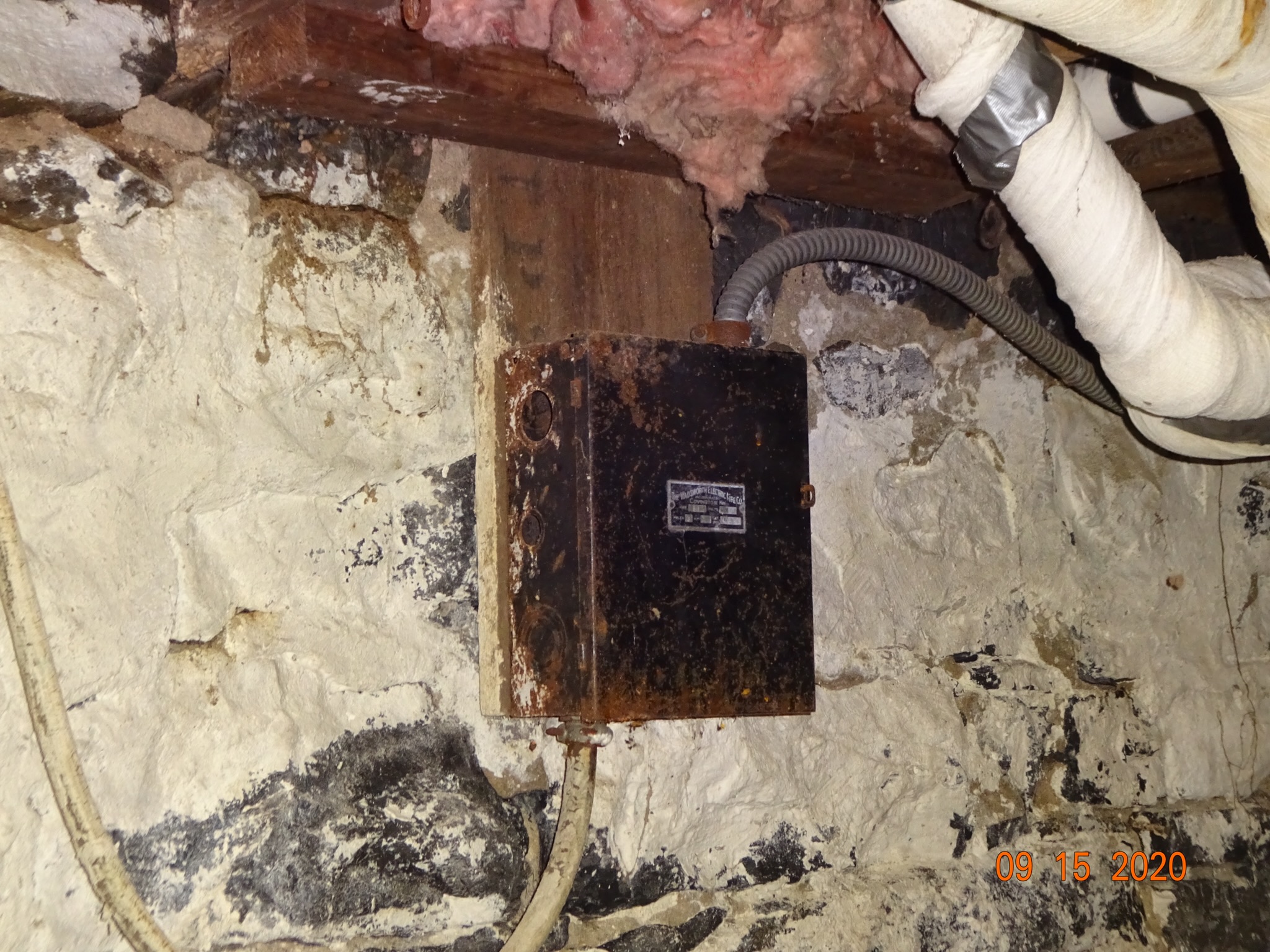

“The following issues were observed in the electrical system that should be reviewed and corrected by a licensed/qualified professional: Double tapped breaker, doubled neutral wiring, electrical wiring needing identification-marking, rust/corrosion on older fuse box near panel, portions of circuit wiring appear to be older that client should consider upgrading. Recommend corrections as needed.”
Good luck man.
-Patrick
Why do you think it is a 200 amp service?
Well it has a newer mini-split AC units installed & I was assuming it would need that 200amp service plus it was switched over to a breaker panel from a old fuse type .But it actually has a 60 watt fuse main disconnect that’s still serving the stove …Why switch it over if it’s not going to be upgraded to a 200 amp service?Seems kinda stupid to me but I guess it’s apparently a 100 amp service correct
The meter enclosure is 100 amp, the SE cable is 100 amp and the main circuit breaker is 100 amp. Conclusion, 100 amp service.
