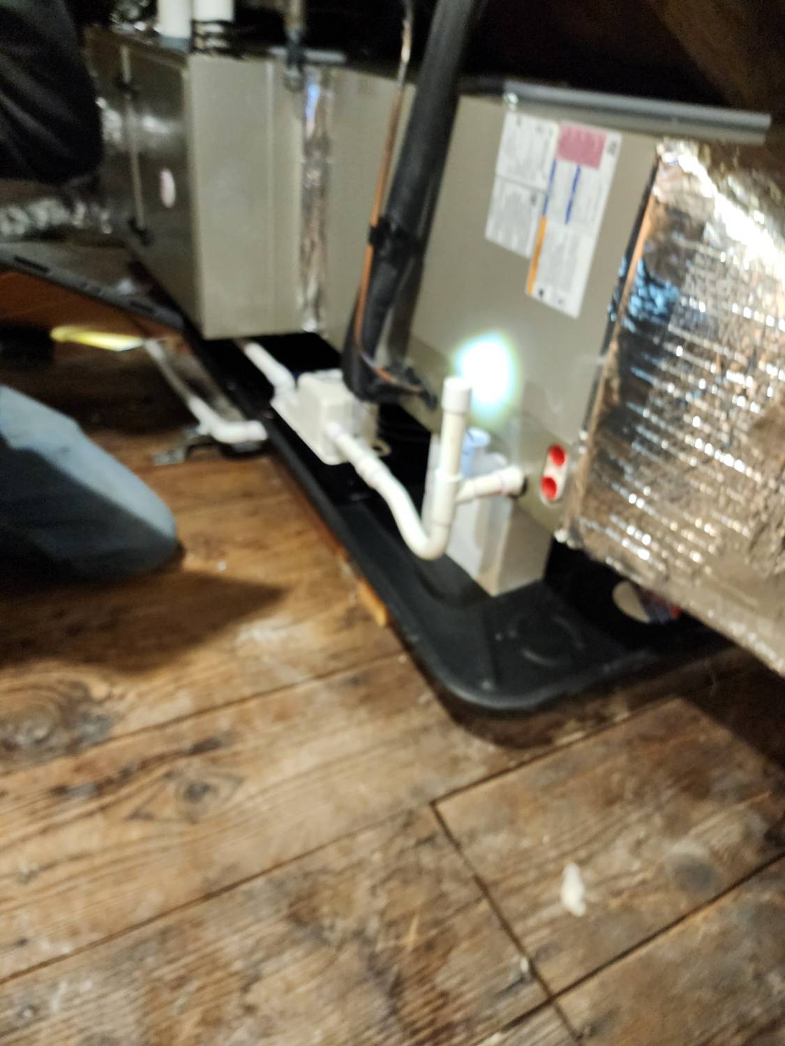

Found another high efficiency/direct vent furnace in unconditioned attic.
I read Payne’s instruction manual.
Only thing it says is you need to winterize if unit turned off for extended period of time.
Issues I see-
  1. Freezing inside unit
  2. Freezing condensation line (and pump in this case)
Saw a few posts that said to add heat tape but risk is tape failure or power failure.
My thought is to write it up as - “Risk of freezing” and contact qualified specialist.
HOW DO YOU HANDLE THIS/ANY OTHER IDEAS?

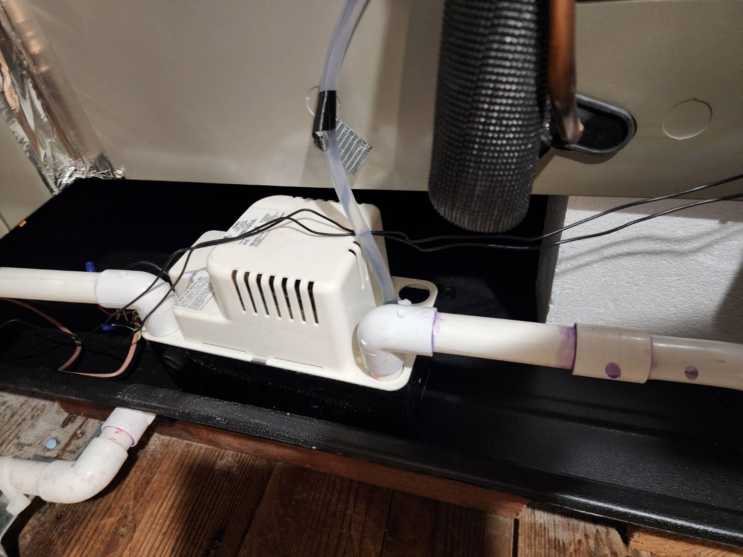

Pls see pics>>>condensate pump in use/vinyl hose unprotected.
Also- even for a condensate line with pitch- if it is 20deg> I assume it may freeze similar to liter pipe.
Flowing water is hard to freeze. Pumps internal mechanism makes them freeze-resistant.
I am not saying these systems never freeze, but the manual is pretty straightforward. Unless you see it installed incorrectly, you are just making up problems that have not happened yet.

#1 There is a removable cap on the condensate drain just above the P Trap. Homeowner can put RV antifreeze, windshield washer fluid, Windex or anything that doesn’t freeze in there.
If everything is installed correctly, this is down hill from anything condensate.
#2 The pump is not hard piped. Just remove the pump and dump it out. Or add antifreeze.
#3 There is no sufficient condensate to fill any of the drain lines (if properly installed), to a point it will freeze and break, P Trap excluded. Freezing of this small amount of water will cause no damage.

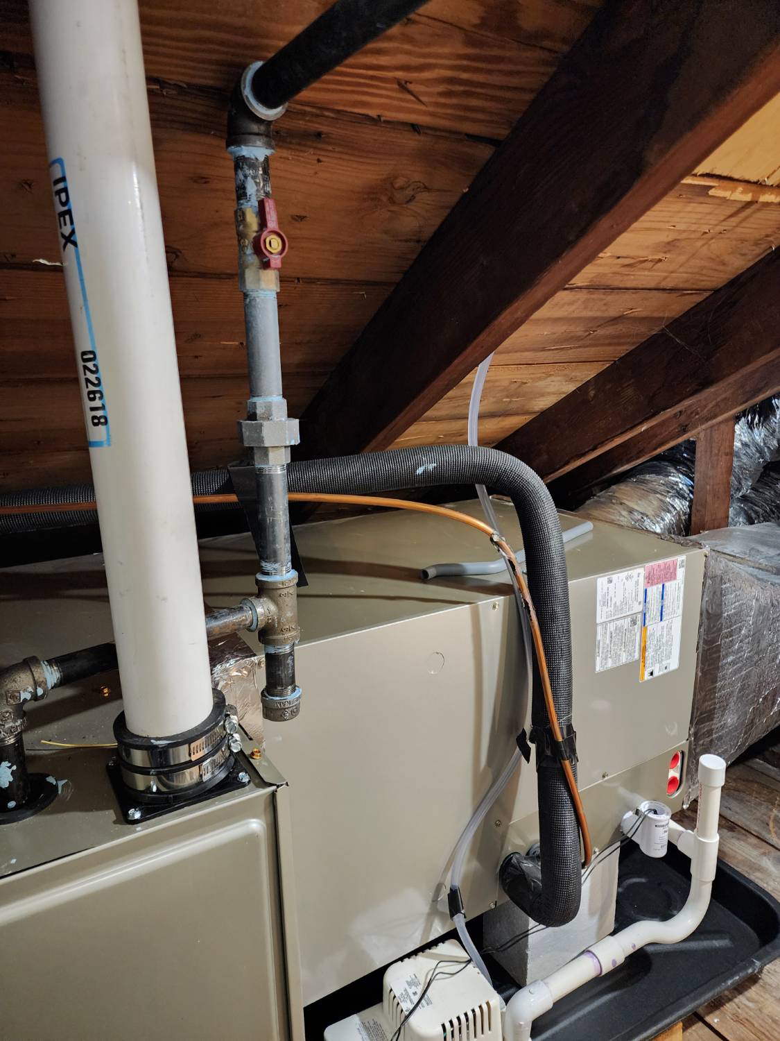

That gas fired high efficiency condensing furnace looks professionally installed and plumbed.
Seeing there is a safety pan to catch liquids, and there is no insulation in the attic yet the duct work is insulated I would not note anything except for the model and serial numbers.
A condensate pump in an attic? That doesn’t make sense. Here in Alabama, if the unit is in the attic then the condensate pipe should naturally drain to the exterior; no need for a pump, unless your attic is below grade. Am I missing something?

Some additional info-
Furnace is brand new/house is a flip (has not gone through freezing season yet)
Unit will not be shut down- will be primary heat for home over winter so winterization procedure won’t apply since unit will not sit idle
It seems condensate amount can be gallons in 24hr period… (Furnace Condensate & New D.O.E. Rules – Part 2 | York Central Tech Talk)
Honestly- I am just really trying to understand if it is really a freeze risk and if not why
Manual does not address condensate line in freezing environment at all.
Contractors are all over the place- some say no issue, some say never install condensate pump, some say heat tape…etc. I have many rentals and asked my HVAC guy- he says never just pipe/pitch.
Not trying to beat a dead horse but when i call out something i really like to understand why.
removing pump sounds logical but still wonder how it wont freeze with end of pipe exposed in cold/gutter
