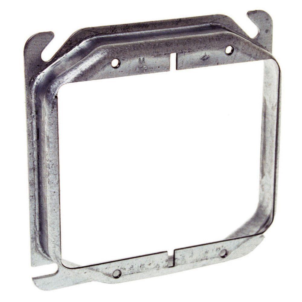

Like Roy said, a mud ring would help: :slight_smile:

Here’s what I see as violations.
Romex wrap not cut back
No mud ring
White and black wires should go to opposite sides of device
If continuing a circuit, wire to device should be pigtailed
If the OSB sheathing is an exterior wall it should be an airtight box.
That’s a long list of mistakes if your using that photo to sell electrical work.

In Minnesota airtight boxes for exterior wall moumts.
Home Depot knows its customers well, doesn’t want to scare them away by showing how its done correctly

No mud ring required if a raised cover is used. Quite typical and better than a ring and a surface cover for exposed work.
There is nothing wrong with using the device to splice instead of a pigtail.
