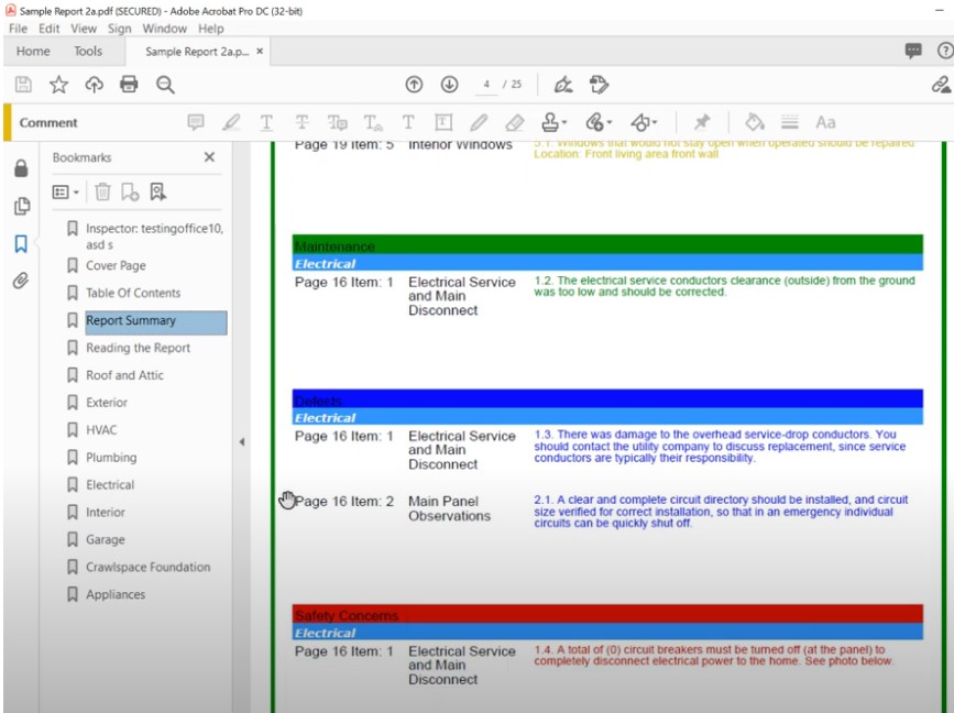

Do any inspectors on this platform use the multiple summary feature on Home Inspector Pro? It’s also known as the “Advanced Colors and Summaries” feature when selected from the desktop drop down menu.
It allows the user to break the summary comments into different categories with different-colored text and titles.
Here’s a JPEG snapshot from the training video to show what the design has the potential to look like:
Summary comments could be any category that the user wants, but the ones mentioned in their training video includes the following:
  1. Safety Concerns
  2. Defects
  3. Maintenance
  4. Minor Defects
Personally, I think that four different categories is excessive and has the potential to confuse clients.
However, I’m considering breaking my summary comments into two different categories. Safety concerns would be red text, and defects would be blue text.
Would it even be possible to put all of the summary comments into just two categories? Would two categories be overly simplistic? What categories would you use?
Do you think that breaking the summary into multiple categories introduces excessive liability to the inspector?
Does this feature create a lot of extra work when producing reports?
Do you think that breaking the summary into multiple categories is too confusing for other people who are reading the report?
Would this feature help the client rate the importance of items that are mentioned in the summary?

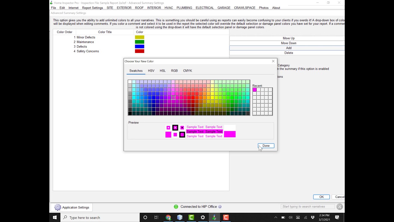

Here’s the training video that shows how to implement the design feature in the report:

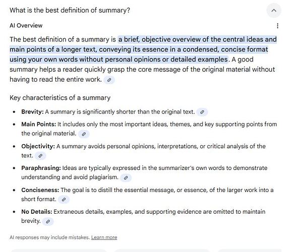

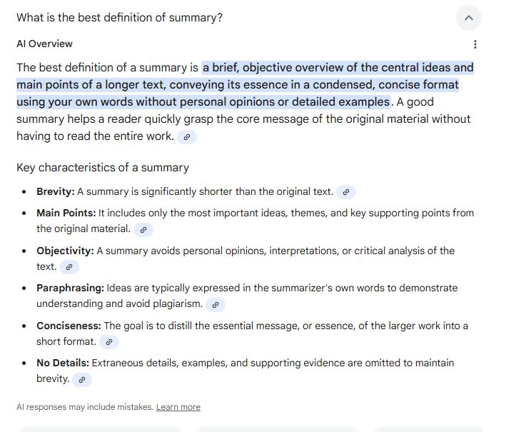

This thread is a great reminder of why I haven’t included a Summary in over 15 years!!
FYI…
