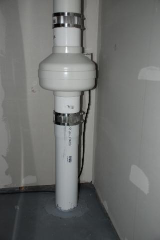

This photo was culled from a “Handy Owner” website. Nice work huh?
The picture is small. What problems do you see with it?
I don’t see a manometer in the photo.
How is it powered?
The problem is this fan is INSIDE the house and not in the attic or exterior of the home. If a seal fails, radon will be pumped into the basement/first floor depending on the location of the install. (basement or slab on grade).
The picture is bigger than the thumbnail, if you click on it.
And right you are.
I always see them in the attic or garage and seldom on the exterior.

I would say a fan inside the garage is ill advised. I have seen slab penetrations in the garage though.
In my area, fans are frequently located outside for post-construction mitigation. Unsightly but effective.
William is correct. Fan should be in the attic or on the exterior. Never on the inside (even in the garage).

Does anyone have a source that states a garage is not an acceptable location for a Radon mitigation fan?
It’s outside the conditioned building envelope so I 'm not sure it would be a problem.
As long as the garage is not beneath the conditioned space it is acceptable in PA.
The biggest question I have when I see a garage slab penetration is, is this slab independent of the house slab if it is on the same horizontal plane. Also if there is a basement lower than the garage slab, I would expect to see a basement penetration as well, although occasionally I have seen sump pump cover systems only. And of those I have tested radon levels in, the sump cover systems have shown themselves to be effective in those applications.
