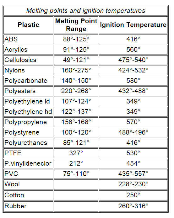

The plastic should be pouring out of the panel.
The melting point for average, commercial, low-density polyethylene is typically 221 to 239 °F. That plastic was nearing the Flash point!

Luckily, the black panelboard and breaker plastic is not LDPE, but polyamide reinforced with mineral fibers – a class of materials that doesnt’t melt, in certain formulations, up to 650 degrees Fahrenheit. I would imagine, the flash point there is even higher.
