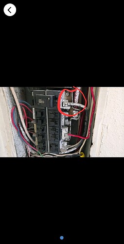

During a recent inspection, I pointed out a higher than normal temperature reading of an electrical panel component (6 AWG wire, 30 amp Pushmatic breaker for an electric range/oven). The temperature at the lug was 170 degrees. I know some wires can be rated to be higher than this, but it seems outside the norm to me. They had another inspection two months ago, and the other inspector is saying that it’s safe and normal. I just said they need to have the panel evaluated and corrected as needed by a licensed electrical contractor. Can anyone point me in the right direction? Yes the range was on when i scanned the panel.

What parameters were you using for reporting your concern?
Have you had qualified training in the use of your thermal imager?
The contamination in the panel jumps out at me.
And what was the comparative information at the time of the previous inspection, and was the other inspectors test method(s) the same, with equally calibrated EQ and functional training?
Did you use your Flir for observations of the panel from multiple angles? Did you adjust for reflectivity or emissivity of the lug? What was ambient temperature?
The other inspector’s opinions are likely based on different circumstances.
Having said all that, your photo does not show something that rates concern. Your photo indicates only 100F above the lowest temp in the photo that may be close to ambient temperature.

The panel is located in the dark closet with no light/ambient reflection. The temperature was 170 degrees, and yes, the scan was of multiple angles and various readings. While the temperature rose.
I’ve taken scans of multiple panels while testing the electrical range, and only a few reached above 160. I know things change from one inspection to the next, that’s why I wouldn’t tell the agents that the other inspector did something wrong or that he doesn’t know what he’s doing. All I wrote up is that it warrants evaluation by a licensed electrician since it’s in a closet, it’s Pushmatic, it has overspray, and elevated temperatures.
There is some problem with this. I would assume that the oven was on during your test. Did you take an amp reading on the conductor in question?
I’ll over-simplify, but your IR doesn’t care about light/ambient reflection because it is a dark closet. It is the same for the IR in a well lit closet.
It is popular to use IR on the service panels, but few inspectors go to the trouble to understand what their IR is showing them. 100F above ambient is typically not a concern.

So what are you measuring here? 6AWG wire, the breaker, or the lug?
What emissivity did you adjust for? They all have a different emissivity.
What was your Temp Reflect setting? They all have a different IR Reflect.
What is the temperature capacity of the three items? You’re making a call based on temperature rise, so what is the threshold?
Well, did you?
If it is this hot with only 2 amps drawing, what is the calculated apparent temperature rise if you were to add the other 28 Amps? This is a calculation you should know if you are going to talk about too much temperature. Would this not be a significant consideration?
Are you sure? Did you ever point your camera at a high reflective surface and see a hot lens in the scan, you know there is a heater in the camera to raise it above a needed ambient? Your terminology may be incorrect, but where energy comes from is critical to know.
And why would you be commenting on what the other inspector reported? Do you know how he arrived at his conclusion? I’m not sure if you know how to come up with your own conclusion at this point.
You wrote up for an electrician to evaluate what you saw thermally. How the hell are they going to address your thermal data when that is not their job? They are not Thermographers. If you are going to pull out an IR where the MSX can’t even line up with the components, and without MSX, you can’t identify anything but blobs, how do you expect them to come up with anything?
I can’t even make a SWAG about the data you provided. But I can look at the thermal gradient and see that there are two potential sources of heat. The appliance load (which we didn’t take amperage measurements) and resistance load between the conductor and lug connection.
Conclusion: nothing to see here. There is heat above the connection around the main buss connections. Is that heat coming from or going to the buss? One way it will increase the lug temp, and the other way it will cool it. Both create an error.
See that 70/164 gradient on the right? That is what the wires would look like if there is a connection problem (indicating conductive heat transfer).
You don’t take a measurement of the hottest object in the scan and try to use it without bothering to calculate from an “Apparent” measurement, to an absolute measurement. Where you have your spot measurement tool, there is something else going on because of the reflection of the geometry. An Alu electrical lug can have an emissivity around 20% (depending on surface condition). But because of geometric reflections in the IR spectrum, it could be as close to 100% as any material in the scan. If you’re going to play with temperature readings, you best be able to calculate this, or stick with “apparent” measurements and setting your emissivity to 100%. Guessing at emissivity will come back and bite you. Changing emissivity to display a higher temp, or placing the measurement tool on a reflection, can and will be construed is you trying to make a bigger issue than what is there.
Use the IR as a glorified flashlight, find potential and further evaluation what is going on. Don’t defer to an electrician because in most cases they don’t know better either. If you can’t figure it out through normal HI Standard, keep your mouth shut because you are not qualified.
Since this is a 240 volt range the load on each leg should be just about the same. Did you test the other leg as well? Was the temperature about the same on both legs?

You are correct that this is an issue, regardless of the scan quality.
Grounded and grounding conductors do often show up hot. Many feel there is no real power running through a grounded conductor, but they burn up just a phase conductor. And yes, they are dangerous.
Please note that your spot meter has a cold wire passing through it.
It remeasures 101F, but the closer apparent temperature is closer to the 147F on the temp scale (depending on the camera setting). So reporting a warmer temp on a grounded conductor may be an understatement.
Because this is an indirect temperature measurement, you could be having a 7k F arc going on there, even at these low temp readings.
