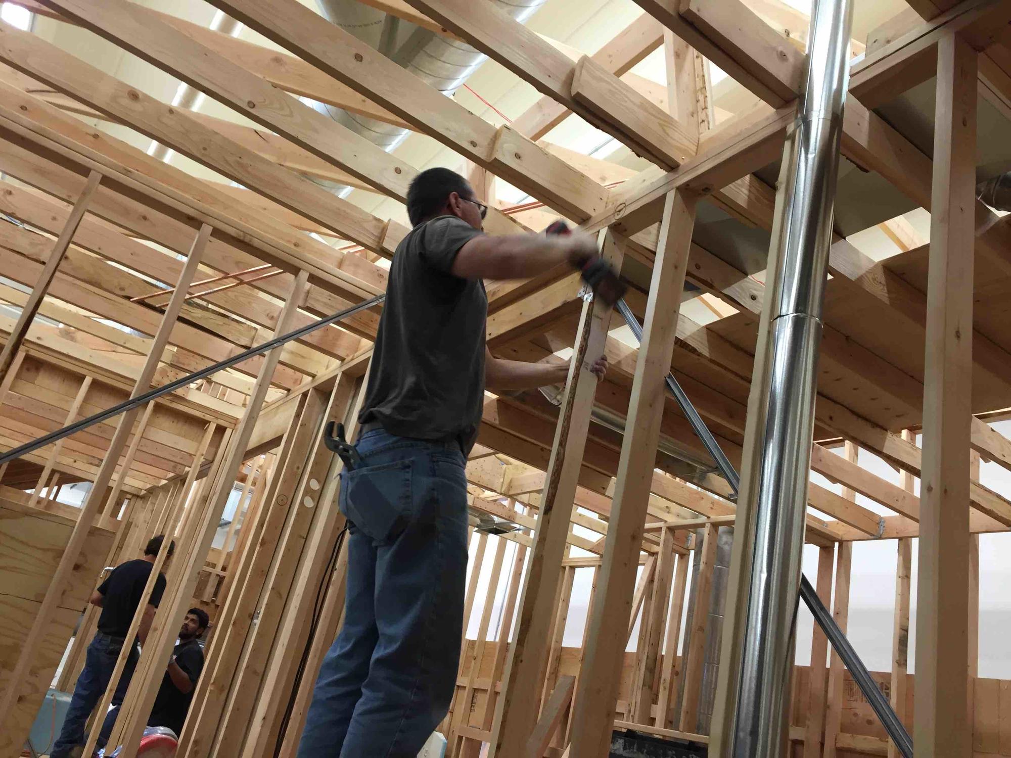

Gas piping being installed right now.

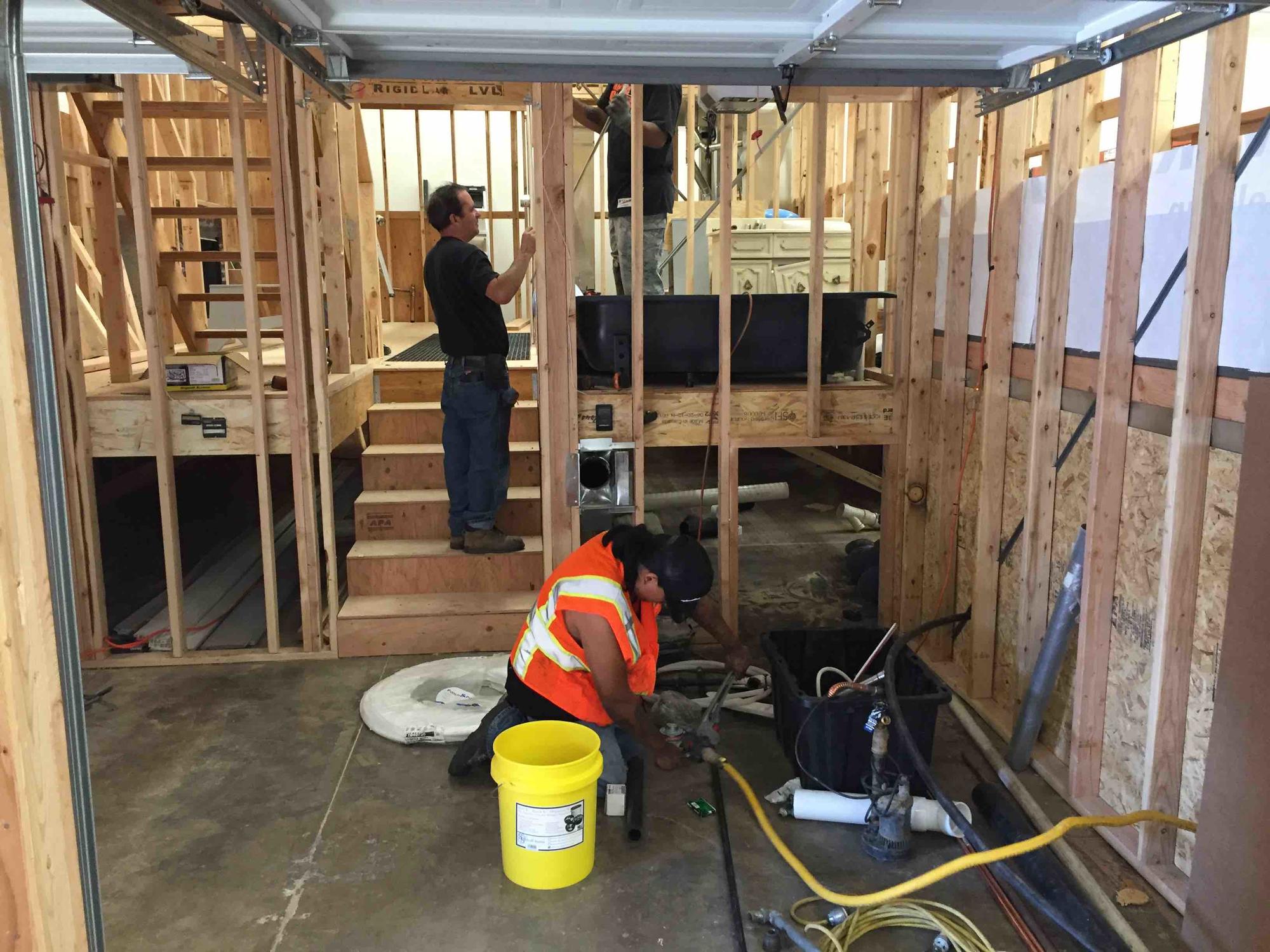

Plumbers installing defects in the House of Horrors today.

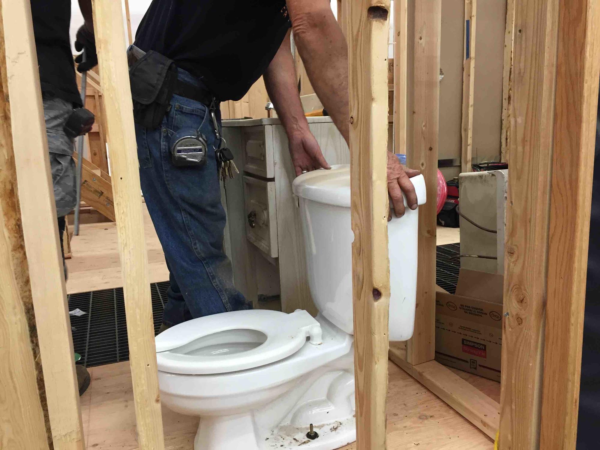

Bathroom toilet and sink defects.

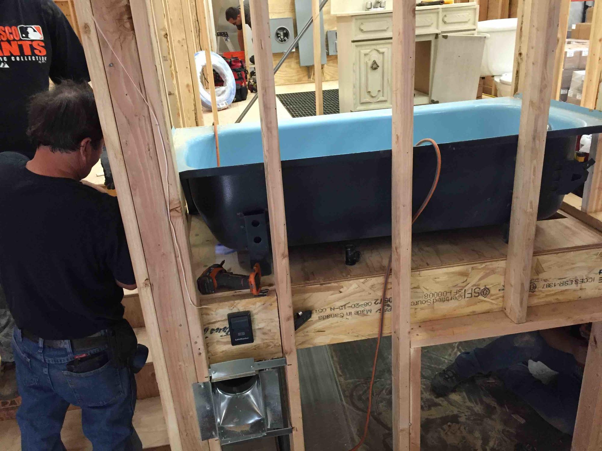

Lots of plumbing problems being installed in our House of Horrors, including defects at the bathroom shower and tub.

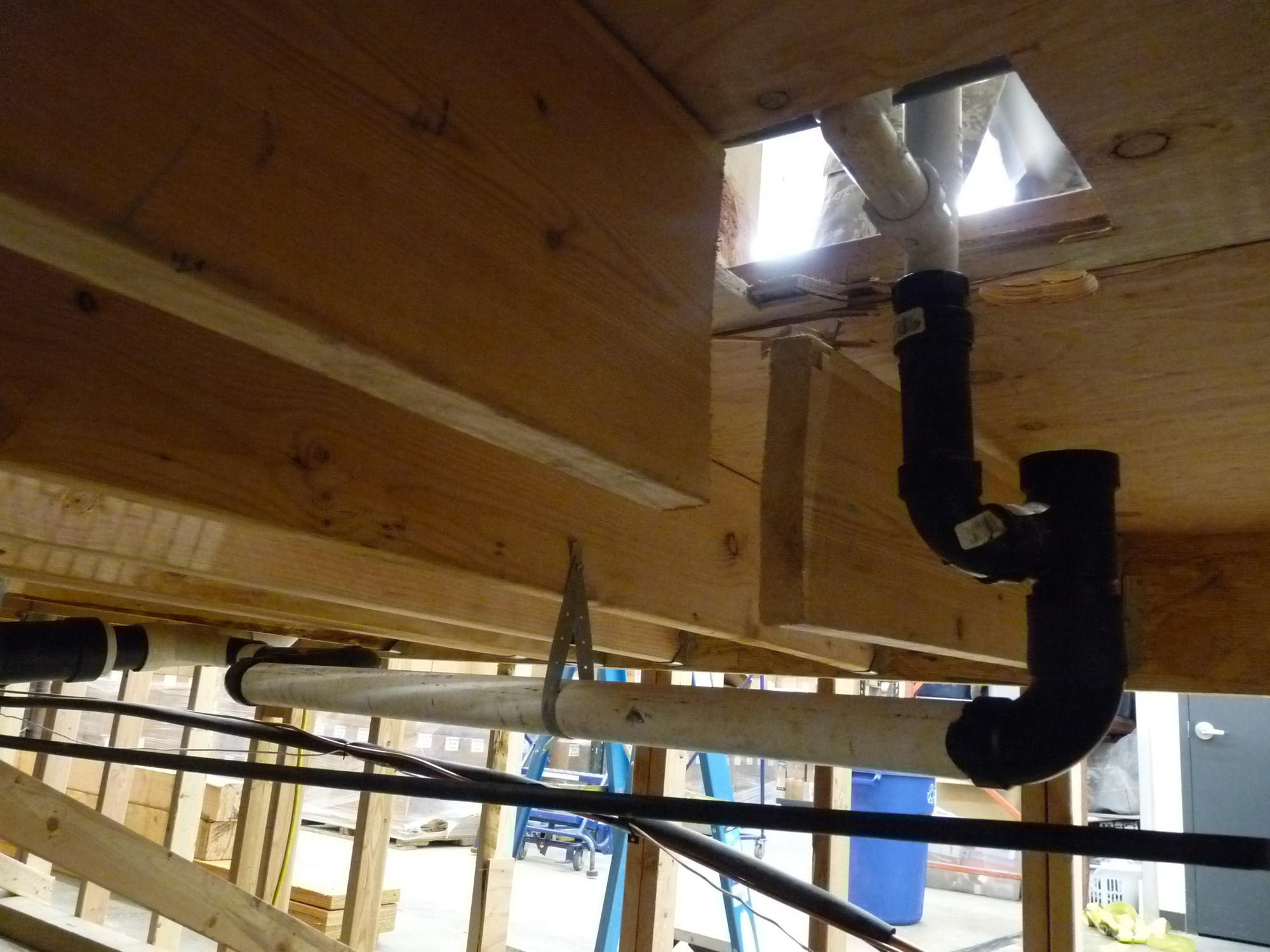

I keep sticking my head down into the crawlspace and all I can do is laugh. This is the drain for the tub.
I was thinking I might repair that cut joist by sistering alongside with with a strip of Masonite soffit material fastened with couple of drywall screws

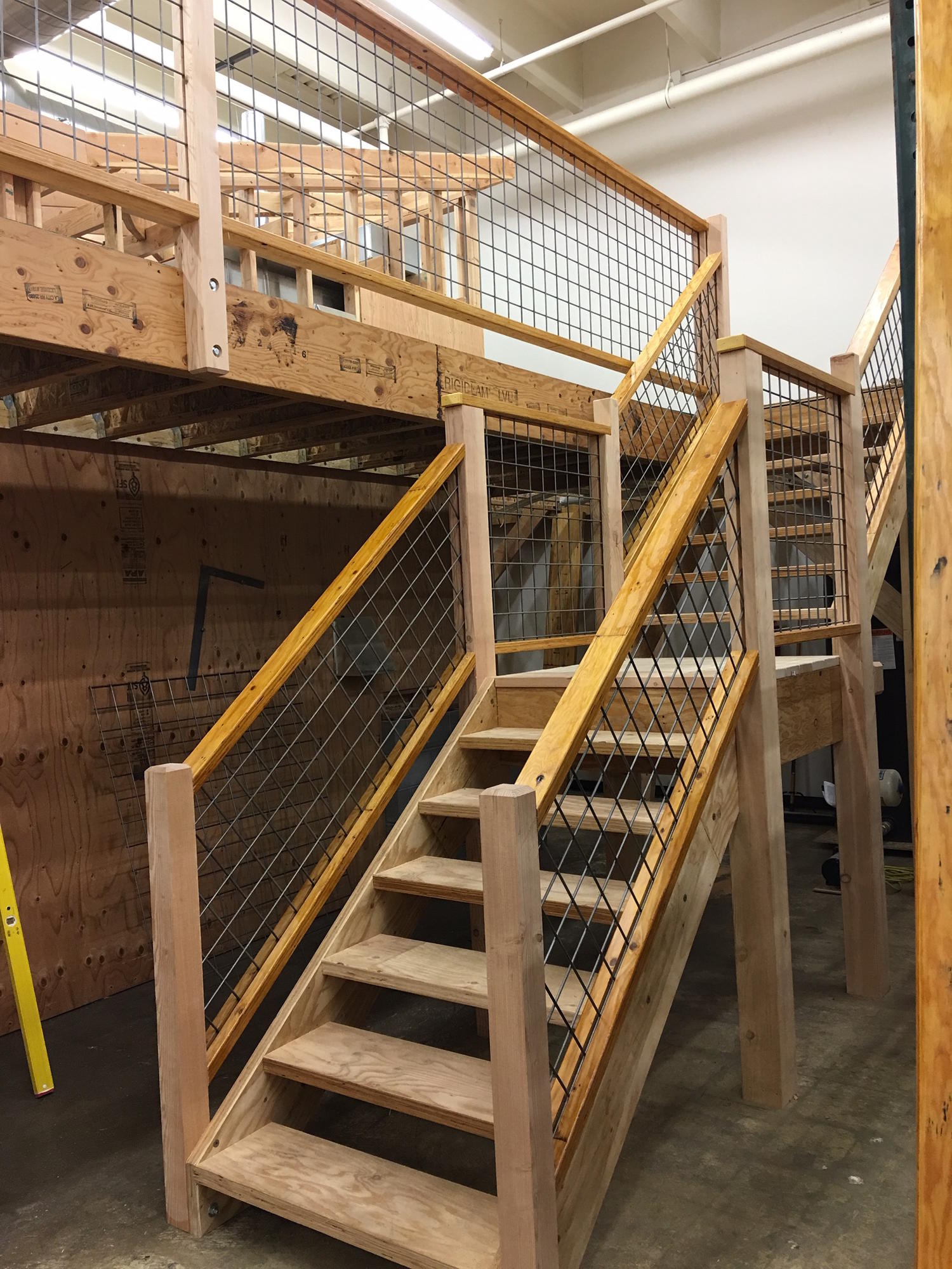

For the guardrail of the elevated walkway around the House of Horrors (installed to allow closeup viewing of the roof-covering materials) we’re using 4" welded wire mesh to minimize visual obstruction by the guardrail assembly, viewed from the floor below. Mesh wires are 4" on center, leaving a 3⅞" opening.
At the stairs, the graspable handrail is not yet installed.

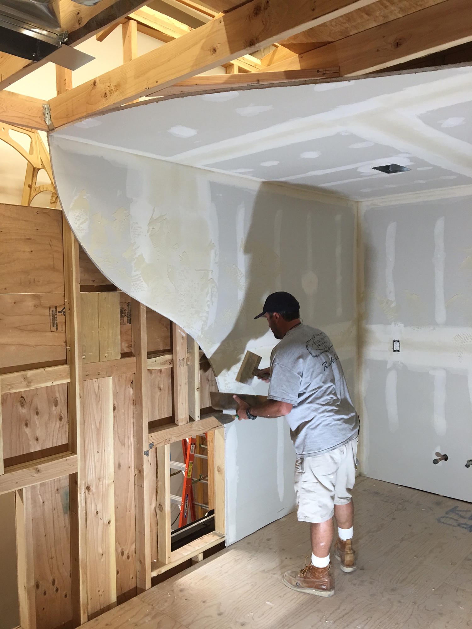

Drywall with cut-aways:

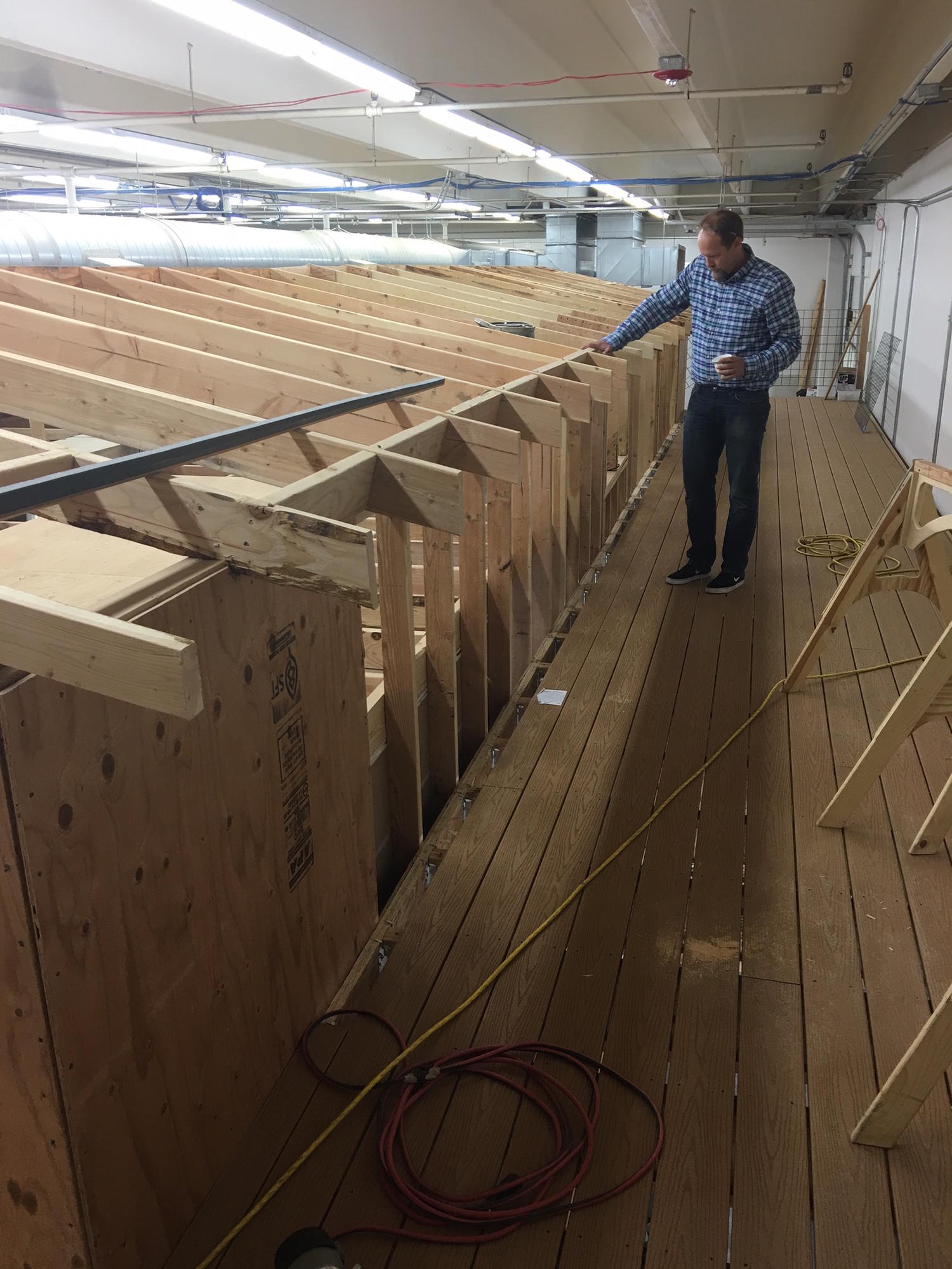

Roofing inspection training stations being built:
