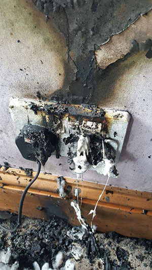

Kinda surprised nobody has mentioned the potential for fire hazard from these devices… Is anyone randomly checking them for scorching or other indications of failure?
And yes, there has been recalls of these fresheners over the years!

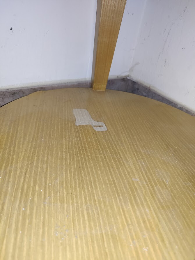

It ate my varnish off of my end table. Imagine what its doing to your lungs!
