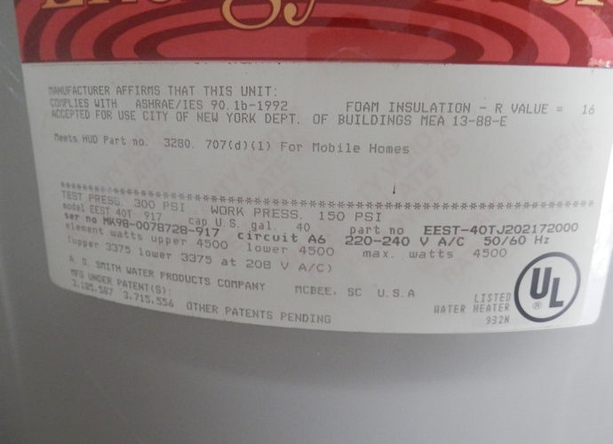

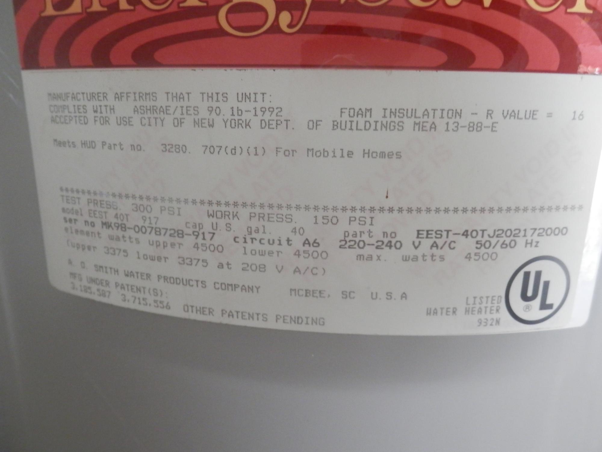

Hello all,
Though I understand as a general home inspection is concerned, the inspector is not required to confirm expectant life of a water heater tank. I feel as an advocate to a client to at least attain an age of the water heater tank, as one can use good common sense to recognize if it is reaching its usable life. Along with a date, one can obtain a wealth of information from the water heaters’ label. So I will make it a habit along with multiple photos of the water heater and its components to obtain a close up of the water heaters’ label. Should a label be illegible, that would generally speak for its self.

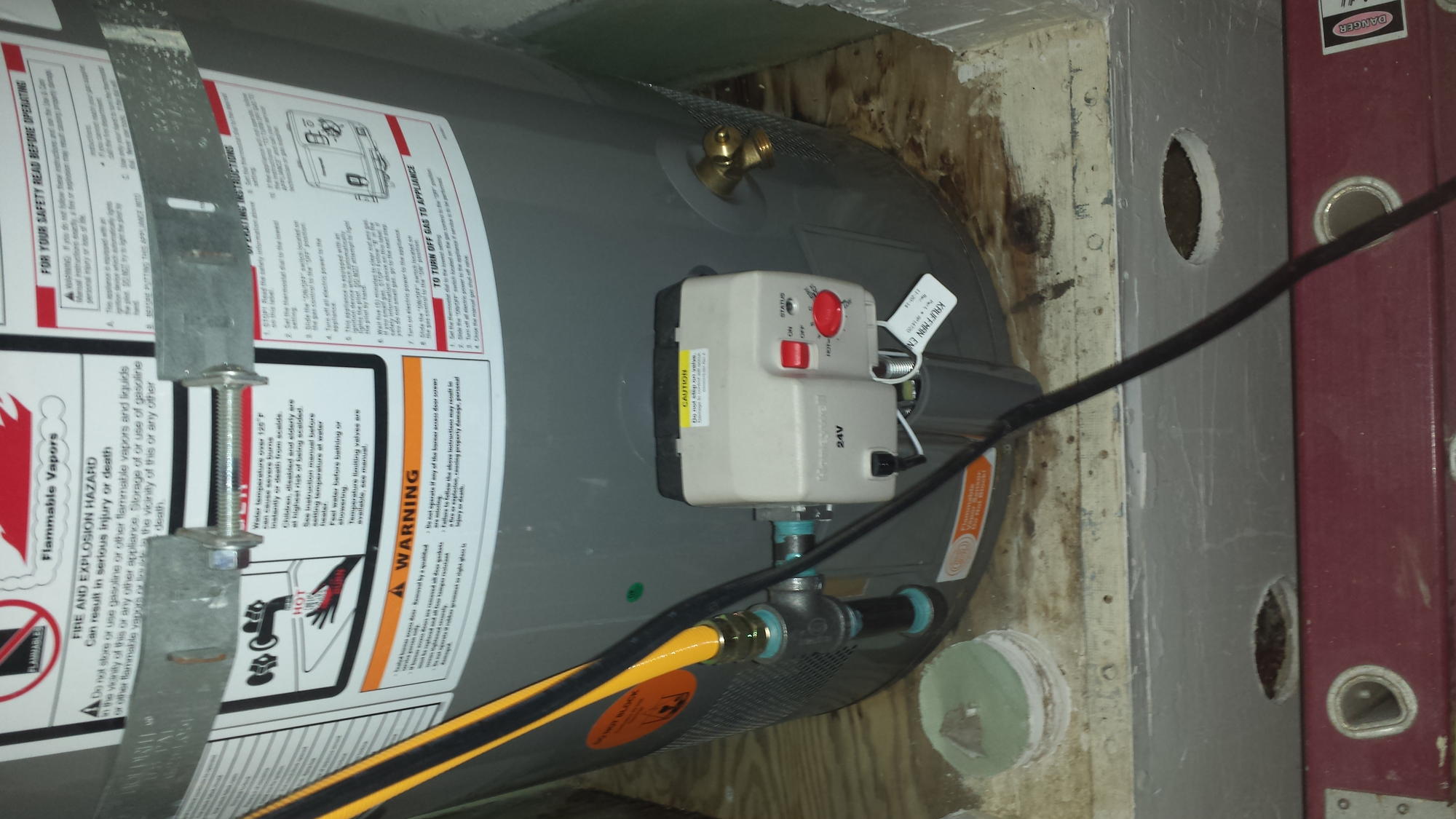

After inspection of the water heating equipment, the following was observed:
The energy source is electric, main disconnect for energy source present.
Venting found to be adequate.
Location is in attached garage.
Temperature/pressure-releif valve present.
No seismic bracing present.

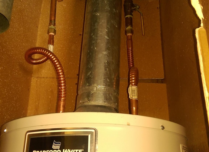

Gas water heater.

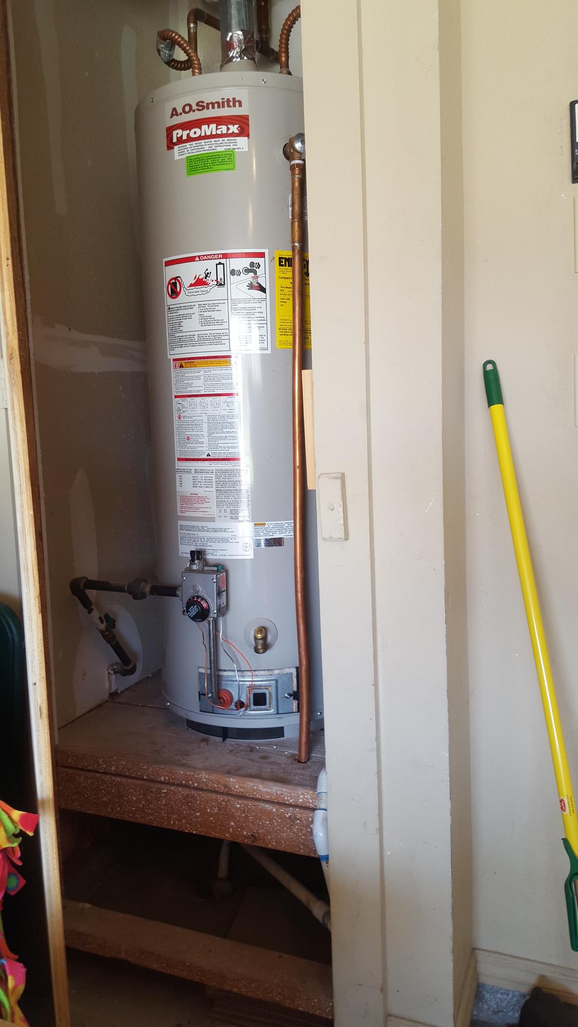

This Water Heater is in great shape. It is 18" off the floor. Perfect.
My inspection was great. Everything was in working order and great shape.

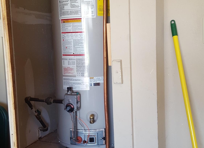

This natural gas water heater tank is in a closet located in the garage. It is elevated 19" above the garage floor. It is in a conifined space, however it is vented to outside air with lower and upper venting to assist with combustion.

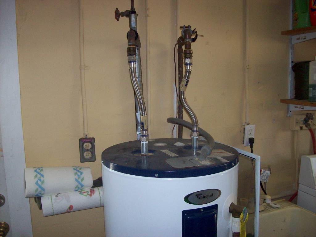

In this photo, we see the upper portion of an electric water heater manufactured in 2010. There is a shut-off valve for the main supply cold water line and TPR valve is good shape with proper outdoor discharge. The electrical wire and connection are covered by a flexible corrugated tubing. I inspected the electrical connection under the plate - no defects observed.

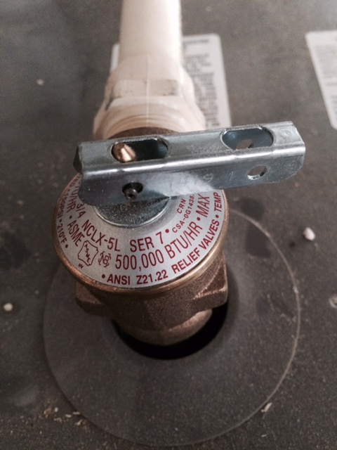

This pic demonstrates a typical thermal pressure relief valve on top of an 80 gallon electric hot water heater.
