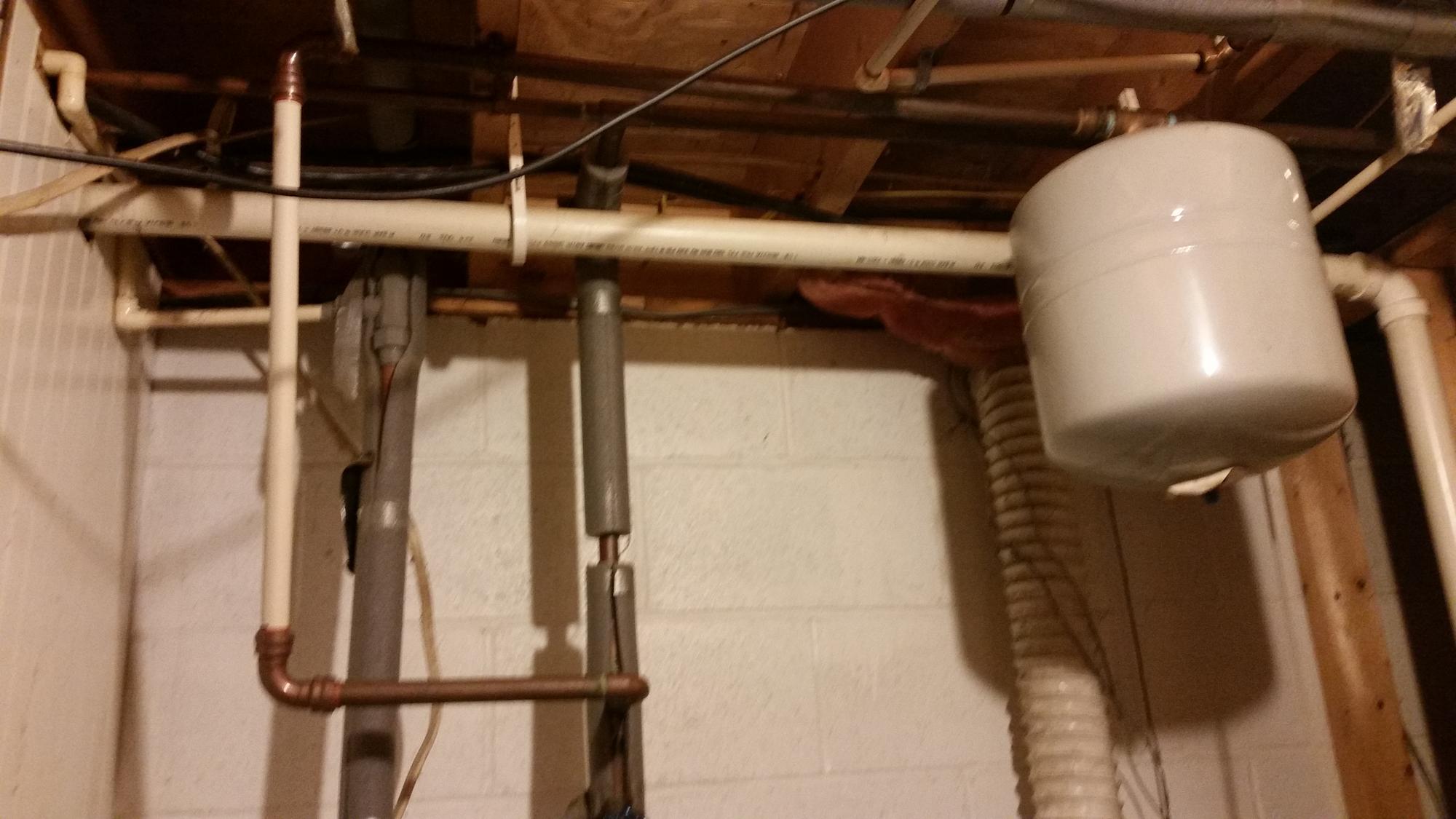

The unit does have an expansion tank assembled in the hanging down position and is secured by a copper clamp over the ¾ inch copper hot water pipe 2 floor joists over to the left of this tank.
