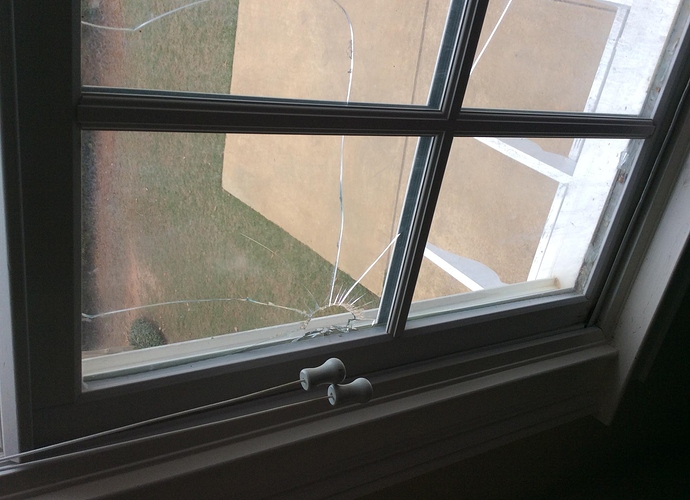

Second story dormer window in bonus room above garage needs replacement and immediate sealing, until the sash can be replaced. This break in the building envelope provides a means of ingress (entry) for moisture and pests. The relative humidity in this room was 68% as opposed to 52% noted in several other locations of the home.
