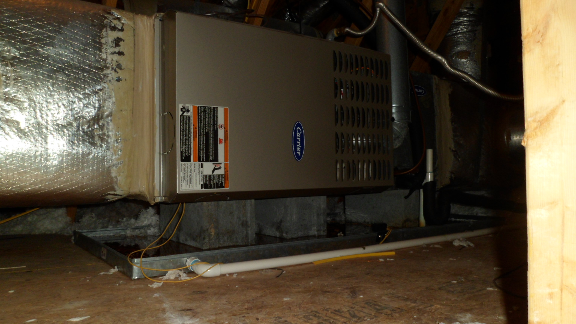

The above pictures are of a HVAC system installed in the attic. The condensate pipe actually drained into the catch pan and then the overflow pipe routed it to the outside. The water in the pan covered the discharge pipe which could allow unsanitary water and/or mold spores to back siphon into the unit.
