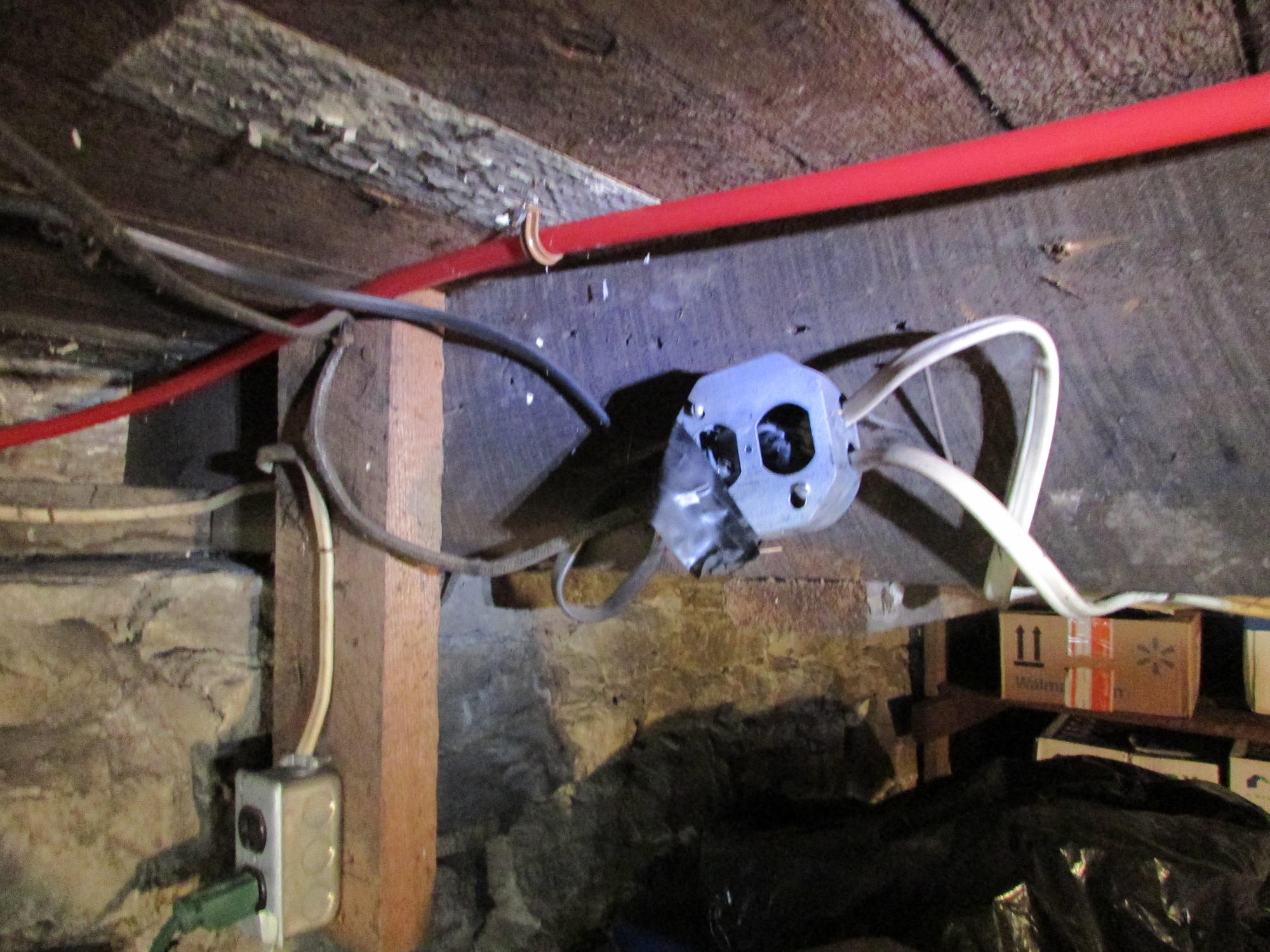

This is a damaged 110 plug outlet in a dwelling(or living room). It is not Arc fault protected. There are many hazards to this problem. Not only is this accessible to children reaching into the outlet, any slight movement of any broken piece could cause a potential fire. Knowing that this plug is not protected, if any arc was to occur the breaker may or may not possibly trip until the hazard is too late to resolve. Also, the plug cover is split. I definitely recommend changing the outlet and plug cover immediately before a serious hazard occurs.
