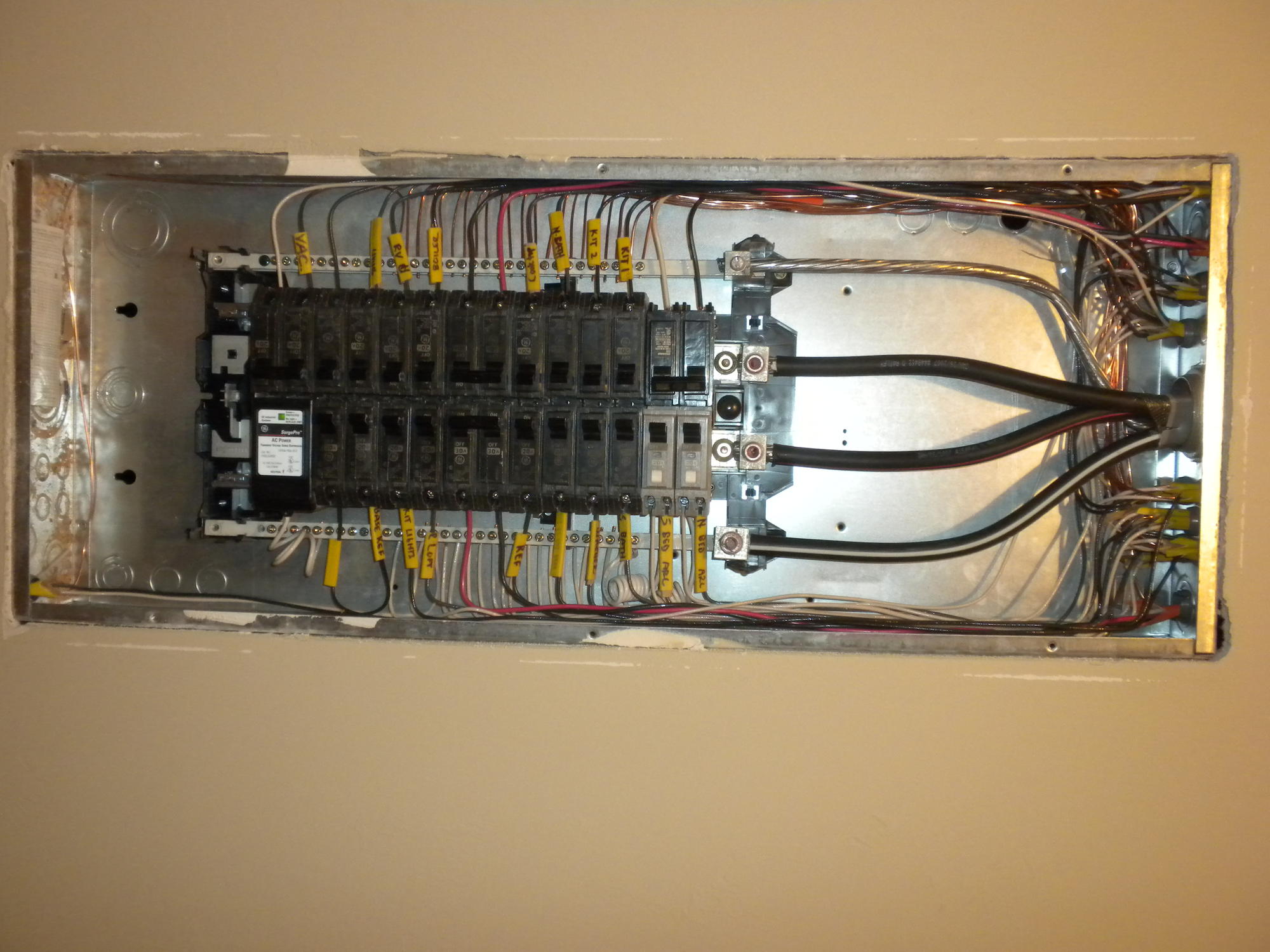

For my inspection essay I choose what is perhaps one of the best Main Electrical Panels I have inspected. The cabling is all neatly laid in the panel, beside the panel cover being label the electrician used pieces of the NM cable sheathing to identify the circuits when the cover is removed. Yet, you will notice that for two of the 240 volt circuits the electrician did not mark the white wire with black tape to identify it as a hot conductor.

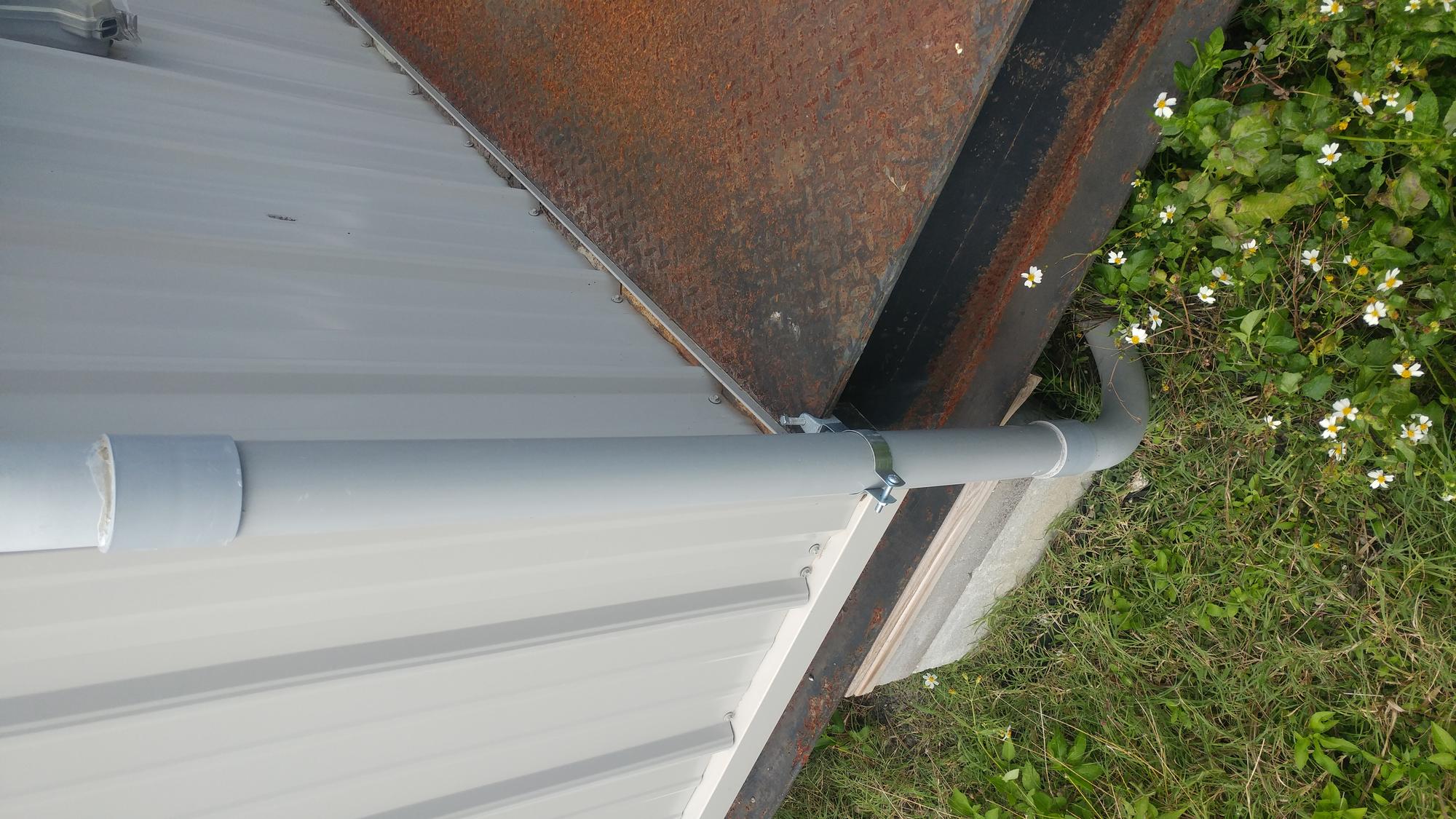

This is a Square D 225/Amp main panel located on the exterior of a manufactured home. The main panel electrical supply is fed underground (lateral service) in grey schedule 40 rigid conduit with no signs of disrepair and all connections tight and secure. The cover screws are appropriate for this panel and there are no open tabs present on panel cover. All breakers are square d and correct for this panel. The breakers are all clearly numbered and the door has a clearly readable legend for each breaker. You will notice circuit # 6 and 8 are both AFCI breakers that supply both bedrooms. There wet areas like bath and kitchen are not supplied by GFCIs, but are protected ant the receptical. I didn’t remove the cover of the panel so it is unknown what shape the inside is.
