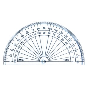

Use a protractor, a string, and a weight.
And Trigonometry
