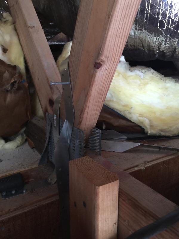

Homeowner is currently getting credit for toe nails. A GC has been hired to improve the roof-to-wall attachments while the home is being reroofed. The GC would like to know if the metal attachments he will be using to retrofit the RTW attachments would be acceptable or not. I told him as long as the new RTW attachments meet the definitions on the form and are installed to manufacturer’s specifications there SHOULD not be a problem but the ultimate decision as to whether the RTW attachments would be acceptable or not rests with an Underwriter. Understandably, the GC (and homeowner) would like a more definitive answer before starting the retrofit work. How would you handle this?

Rick, see the attached photos. They show what the GC is considering. It will be done during the reroof. The GC provided these photos as samples and would “tighten” them up so they are snug to the truss and add the appropriate number of nails if the attachments are deemed acceptable. The problem is that the attachments don’t quite “fit” as they are designed to fit. Parts of the attachments would have to be bent certain ways to fit better (but still not as designed).

Those photos will not fly…it appears they are on an intermediate bearing point (that’s what the underwriter will say), and that is not an approved installation. Highly recommend to the GC, to have an engineering letter / shop drawing designed, and get a permit.
It sounds to me like the GC is not qualified to do this retrofit. I would recommend hiring a different GC that is more familiar with wind mitigation requirements in the state of Florida.
Wouldn’t you be better off asking for drawings showing scope and details and a building permit ?

As a side note, if the pictures you posted are an example of this GCs work, find someone else. I am hoping that is just a mock-up and not the finished product.
OK. Great. Thanks for all the input. Here, in part, is my response to the GC:
The best way to see if this is going to “fly” is to get the appropriate professionals involved (architects, engineers, etc.) and go through the appropriate processes (permits, drawings, etc.). I am not qualified to approve any retrofit plans.
As it relates to the wind mitigation inspection, I can tell you by experience, as long as the attachments are installed as designed and meet the definitions on the wind mitigation inspection report you should be fine (it almost always has been fine in the past) but, again, the ultimate decision rests with an underwriter. Because the ultimate decision does not rest with me, I cannot (in all fairness) give you a definitive “yes” or “no” to your retrofit plans. You could get the Underwriting Department involved from the homeowner’s insurance company and run your retrofit plans past them to see how they would handle it.
Yes. This is not the finished product.
