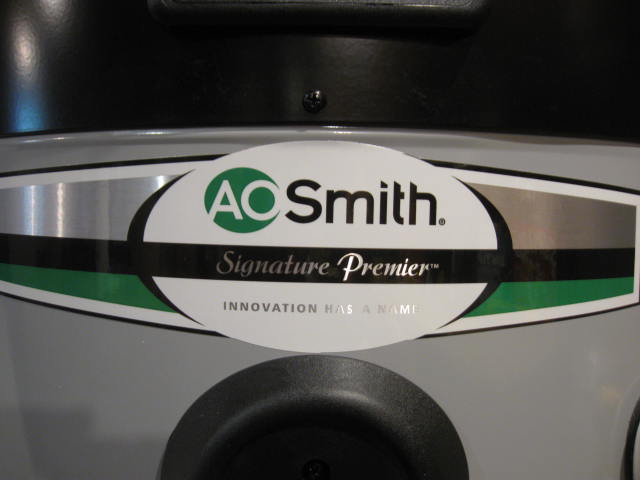

Has anyone come across hybrid hot water heaters during your inspections?
Any red flags I should look for?
IMG_6751

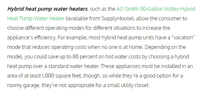

Yes, size matters!! ^^^^^^^^^^^^^^^^^^^
It is installed in a 1,400 square ft. open basement. I guess you would treat it like a standard water heater except for the heat pump parts?
Why don’t you look up the installation instructions for this specific model. It’s a hybrid electric water heater and these generally require 750 ft.³ in the installation area.

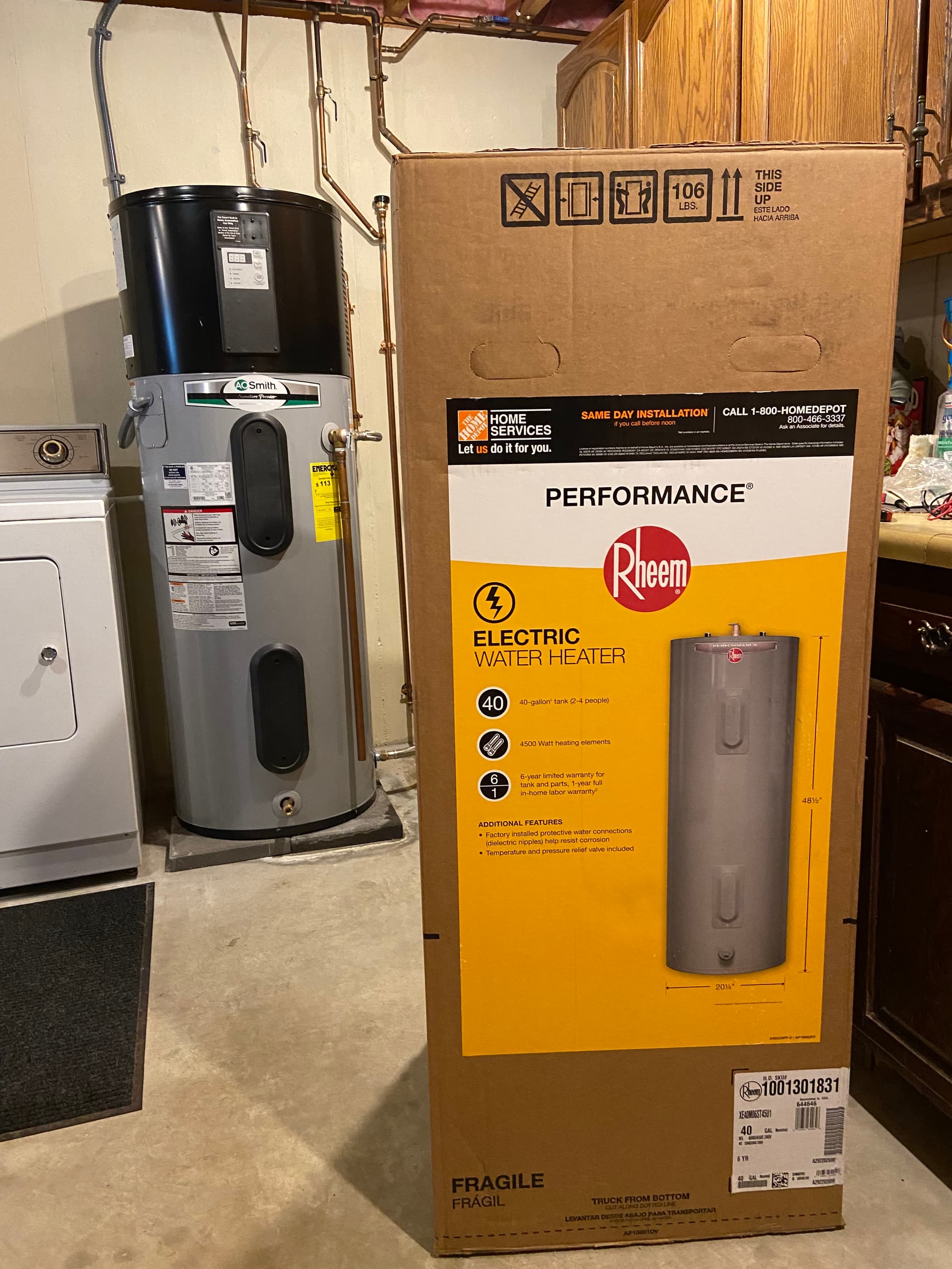

UPDATE ON THE ELECTRIC HYBRID HOT WATER HEATER
I installed this Hybrid water heater approximately 3 months ago, So far it is running with no glitches. It keeps up in the hybrid mode for two people with no problems, As far as the noise, it is in the basement and you can not hear it up in the living space but the noise in the basement is minimal, Another benefit is it dehumidifies the basement nicely. I have received 3 electric bills since the install and my electrical bill has dropped around $60.00 a month consistently with no changes inhabit, No I have no way to measure the exact amount of electricity it uses. So far I give it a thumbs up all around. :+1:
Sounds good! how warm/cold was your basement during this period?
The basement temperature averaged low to mid-60s during the summer, we will see how it go in the winter months, I do heat the basement with a wood stove in the winter so it will probably draw heat from that, It does lower the basement temperature it is kind of a drawback.
Update on the electric hybrid water heater. All was good for the first 12 months. Then parts started to fail. First, The run capacitor failed two months later, the compressor failed, and later the panel board failed. at that point, I had enough, I pulled it out and replaced it with a conventional bottom of the line water heater, all is good for now.
It was less than two years old.
Warranty not good? Or you just got fed up with the reliability issue?
The warranty was still good for parts, but It was a constant nuisance with breakdowns. It had a mind of its own. I checked the panel board daily to ensure it was in the right heating mode.
Tankless gas water heaters are the same mess – a million components waiting to fail. By the time you save some $$, you will spend $$$ on maintaining & repairing them. They are only beneficial to save space, that’s about it.
