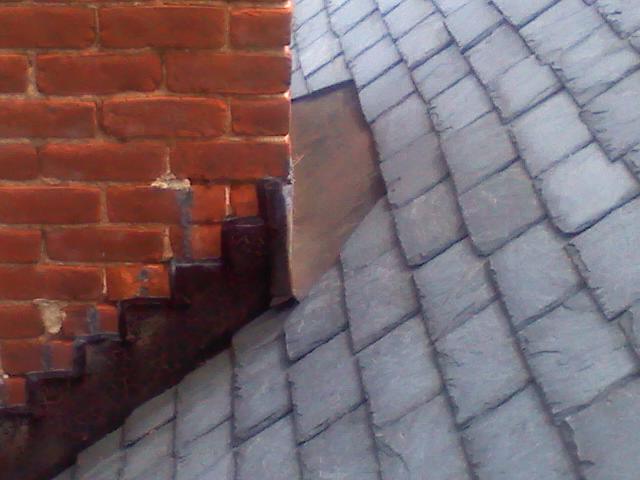

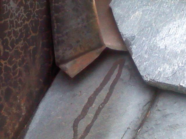

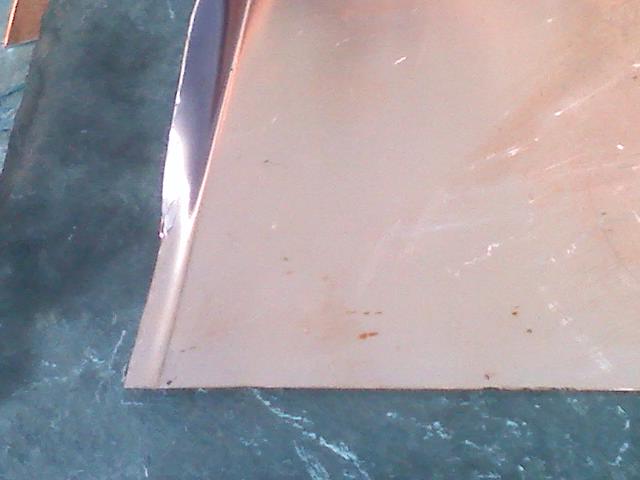

Just thought I’d share these with you. One is a chimney over 100 years old with Tinner’s wings and no caulk and no evidence of it ever being caulked. No signs of leakage either. The chimney is 5’ wide.
I’ve modifed the way I do Tinner’s wings when not using a cricket so there is a low point well out from the chimney that’s lower than the actual chimney corner. Wicking water goes to that outer point. I do caulk mine before sliding the pan in and folding the wings around. The foled wings prevent wind blown water form accessing the corner itself.
Note that the pans are under the slate/shingles so it doesn’t buck the water flow.
The last pic is just to let you know I also use crickets.

I don’t bother with too many ‘finished’ pictures, but I have some of this one. On the shoulder I made a foldable flap. The Zanchors went in, then the flap was folded over to cover the zanchors. I had asked if they would spring for a higher shoulder to be built up. It’s only 3" high at the corner.
I got a call that it had leaked this year. I went over and sure enough, the whole thing was packed solid with trash. Gutters, never cleaned, etc. I stepped in two diverters to catch the trash and direct the water past the corner, and put a screen over it too.
I was first taught to cut nice tight pretty corners. Later, when doing tear-offs, I’d see signs of leakage where the caulk had failed on every roof I tore off. Then, I worked with an old-timer that explained those tinner’s wings, ( when I tore off roofs with those, there was seldom, if ever any signs of leakage.) and I switched tot he old ways. I often get on roofs with those and the roof has settled so much, you can see through from side to side and they still don’t leak! There was a 3" gap under that pan in the first picture, BTW.
As an added step, I don’t cut the last step flashing to the crease. I cut it to the thickness of whatever material I’m working with instead. If water ever made it past the wind guard, it would find a channel instead of a hole.

The old timers always said there was no use to caulk those corners. I put some there ‘Just in Case’ there is ever any capillary action.
The tinner’s wings short-circuit one part of the chimney and corner flashings. Water doesn’t hit the step flashings at all unless there is a driven rain. The water goes down the roof to the side.
Two front corners with a tinner’s wing done by others. Nearly eliminates the need for caulk.
And a dormer corner done by me. I used a Multi-Master to clip the wood as necessary. Eliminated the need for any caulk and stopped the leak.
