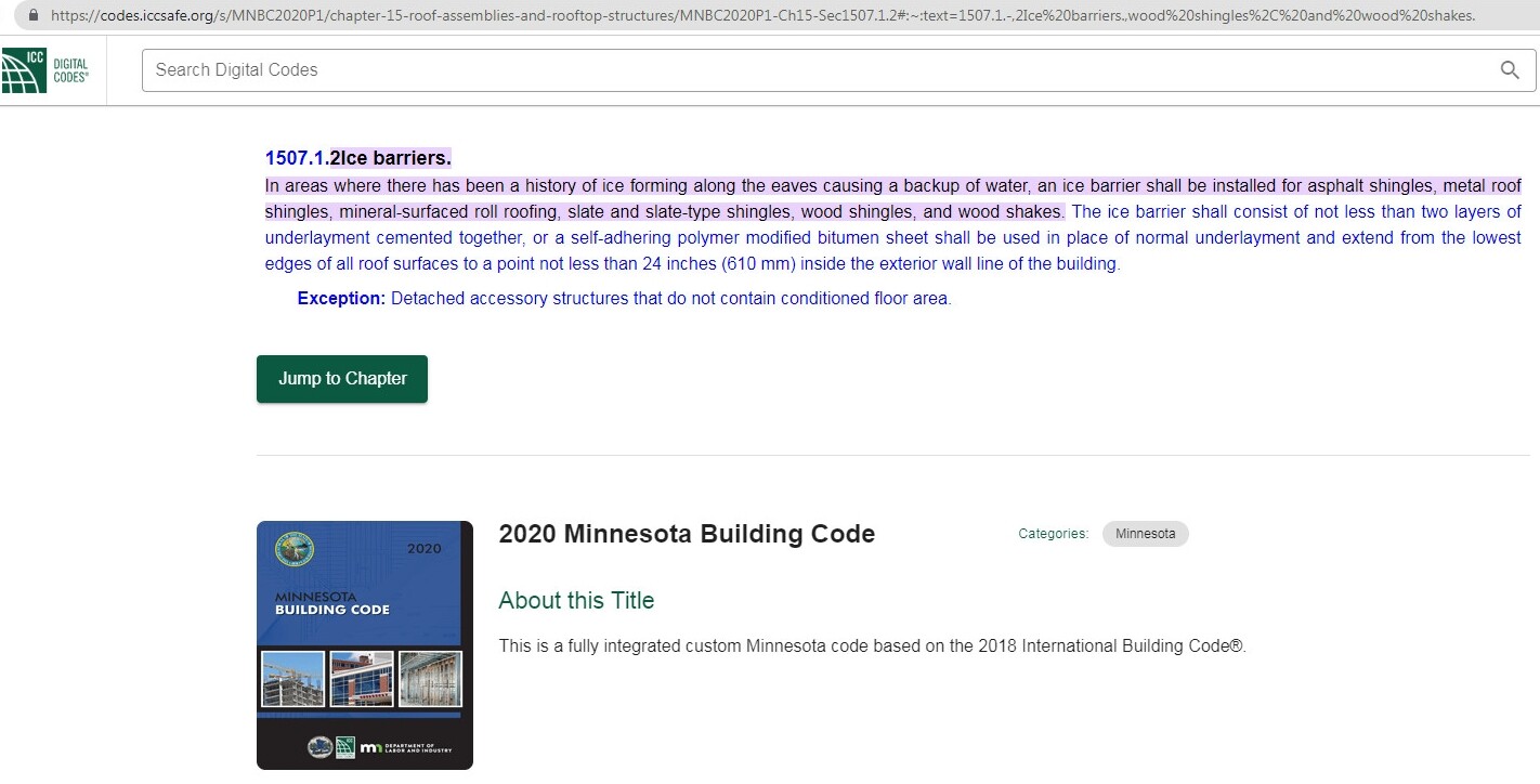

Where are you located, and what is your local AHJ’s “opinion” on the subject?
My local (MInnesota) says this…
Thanks Matt. Would no drip edge be noted as such in the report even if there is an overhang of the asphalt shingle toward the gutter?

Your Local AHJ requires it, so you should be reporting if it is not present, or in a deficient method or condition.
Ice Barrier can be a royal PIA to inspect for (at best) and is not always observable even when present, so be careful how you word your narrative, such as “was not observed by the inspector” or “conditions prevented the inspector from determining”, or some other such comment. Just be honest without “stretching the truth”. If you can’t see it… SAY SO… without inferring it isn’t there… because it may be!!
