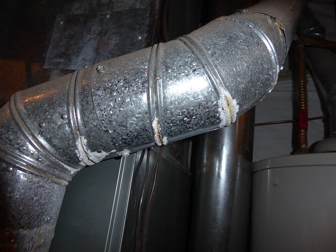

Where do you see an extreme? Surely, not 23F. I reviewed my comments here and no where did I say that the combustion gas temp is wrong. In fact, I said that the flue temps are what they are. Sizing and designing the flue correctly so that the flue gases stay warm enough to evacuate most of the moisture in the gases is what I claim is important. Here is a photo of a flue on an 80% furnace (with water heater tie-in) where excessive condensation dissolved the flue on a five year-old system.
Then your next sentence in that post is…

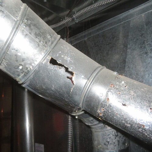

You seem to say that there is a problem in the original post, but then say ice has nothing to do with it. What design flaws do you see? Would the ice still be there if there were no design flaws? Maybe we disagree about what is excessive condensation. I think when the condensate becomes free flowing that is bad. I claim that it can (and often does) “eat” a hole in the flue which can leak combustion gases into a house. My conclusion is that since 23F is a common winter temp, then if free flowing condensate is occurring at that temp, then there is a high likelihood of damage occurring to the furnace flue in an 80% furnace.
BTW, here is a photo of those “white marks” that you mentioned earlier.
I don’t like to see that either, because in my opinion, that is an indicator of excessive condensation.

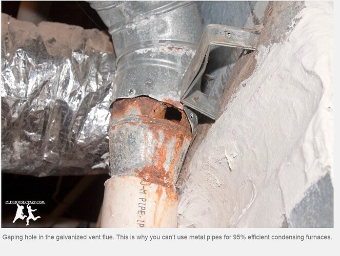

And finally, since your comments have confused me, maybe we are somehow talking past each other. You have made comments and even posted a photo of the damage from excessive condensation where a galvanized flue was used on a 90% furnace. So, why wouldn’t similar excessive condensation be a concern on an 80% furnace? Isn’t free flowing condensate excessive? Do we really disagree that a gas-fired furnace should be able to evacuate the combustion gases sufficiently that the humidity suspended in the gases does not condense enough to free flow condensate back down the flue at a mere 23F?

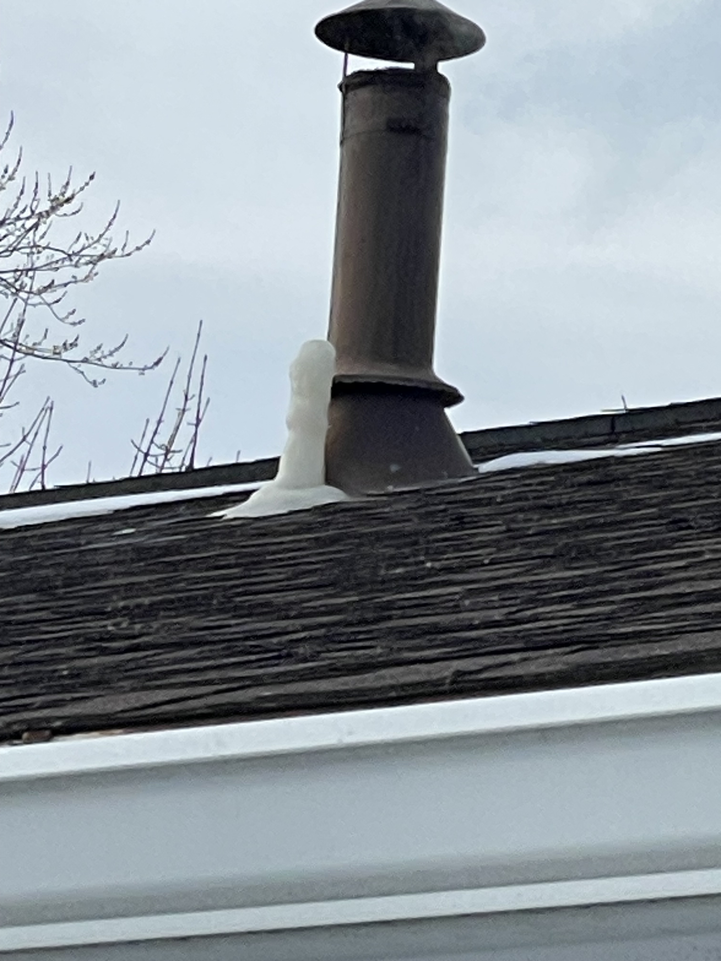

Last year a new boiler was installed. There seems to be some knocking going on. The first remedy was to add piping. A year later, there is still knocking. The tech determined that water wasn’t getting through therefore he opened the valve. Now there is condensation resulting in an ice formation on the roof. I am waiting to be told what the next step is.

On the last service call, the technician noted that he added H20 and set autofill to 15psi. I had the furnace thermostat turned down to 65 at the time of service. The outside temperature was around 7 Fahrenheit. When he was finished, I turned up the heat. The next day I saw the stalagmite on my roof. The stalagmite did not seem to grow during the next few day before the above freezing temperatures settled in.
My question to the group is: Do you think this was a one time occurrence resulting from the adding of water into the boiler or is this a problem with the new boiler in general. The old boiler/vent never did this.
Why would adding water to the boiler make water vapor out of the flue? The ice you see is from combustion gas. The water added was for the circulating loop throughout the house.
How often is it 7F there?
The ice comes from the moisture of the fuel you are burning. Like your car exhaust steam when you first start up on a cold day. The water is not coming from the radiator, it’s from the fuel you are burning.
This ice is from condensation occurring from the rain cap. When it drips down to the roof, it would freeze immediately at 7F, would you not agree?

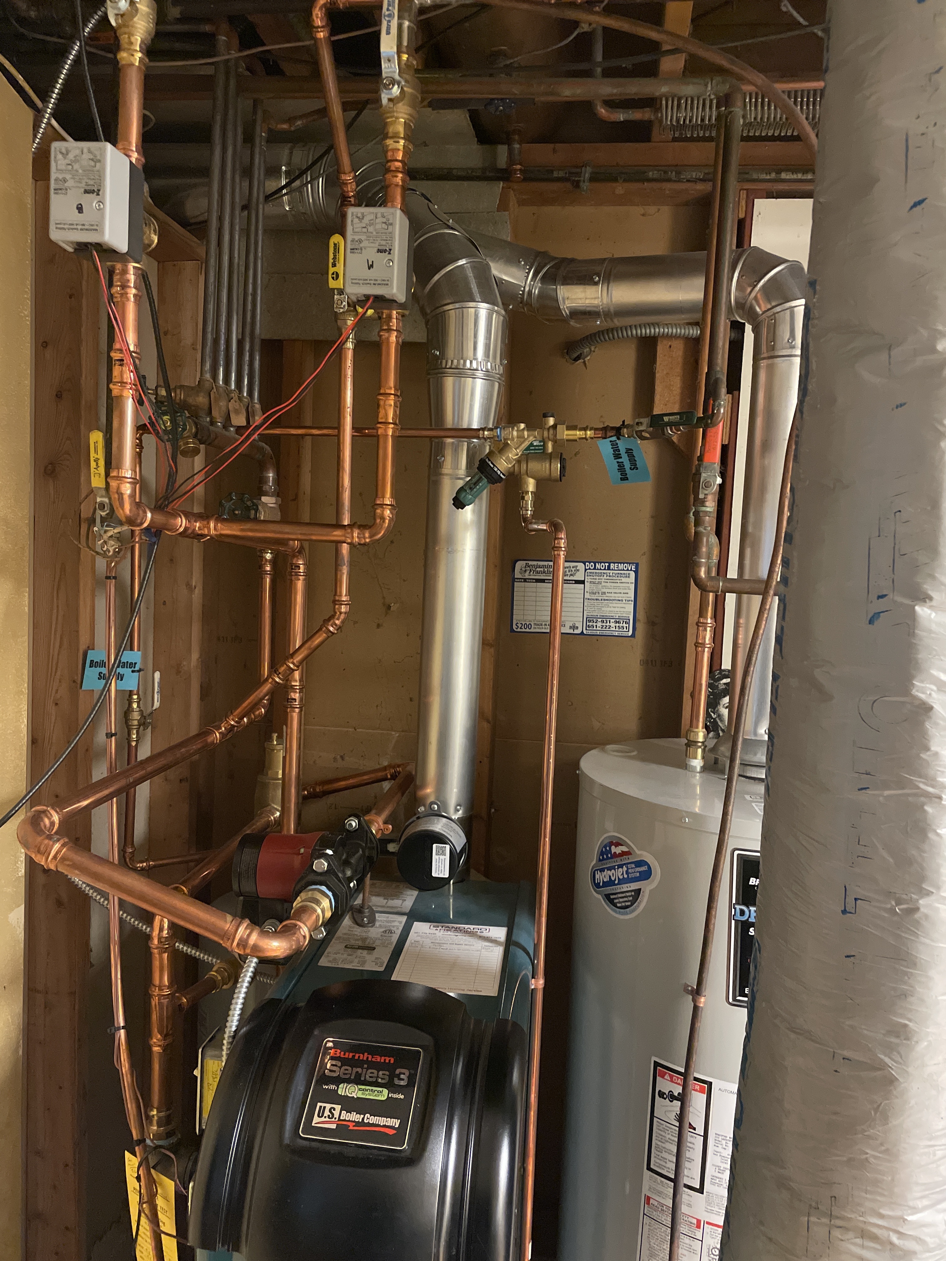

As I understand what you said, you are talking about two different and isolated systems within your boiler:
What you describe appears to be the distribution component of your boiler, the fluid that runs through the tubes to the heating elements in each room of your house. Unless there is a leak inside the heat exchanger, none of this fluid goes up the flue. Knocking on the pipes is from air in the distribution system. That should not be present. A bleed valve should be present in your distribution system to remove that air.
This condensation is from exhaust gasses of combustion. This is the combustion gas exhaust system. It has nothing to do with the fluid in your heat distribution system. Recognize that large amounts of H2O are present in combustion exhaust gasses. Turning up the heat results in more exhaust gasses moving up your flue. If the flue is not warm, then water condenses as it moves up the flue. Maybe your boiler is short cycling, the result being the flue does not heat up enough to reduce condensation. Maybe it is exposed to excessive cold air, thus your flue is cold, resulting in condensation. Or as already said, maybe there is a leak in your heat exchanger.
Your boiler picture shows what appears to be an atmosphere vented boiler using an electric vent damper. I don’t see a draft hood on that flue configuration. Without researching manufacturer installation instructions and not knowing the details of that electric vent damper, a draft hood may or may not be required in your flue configuration.

  • __I did not catch the fuel you use.__My Boiler is a Burnham Series 3 Low Press Boiler and it uses gas.
  • But you’re talking about a 7F day? Is this the normal regional design temperature for this equipment____? I live in Minnesota and extreme temperatures are quite common during our winter season. We just went from a stretch of -20F windchill to 40F this week. The 40F is the odd temperature for January. Our normal overnight is about 8F.
