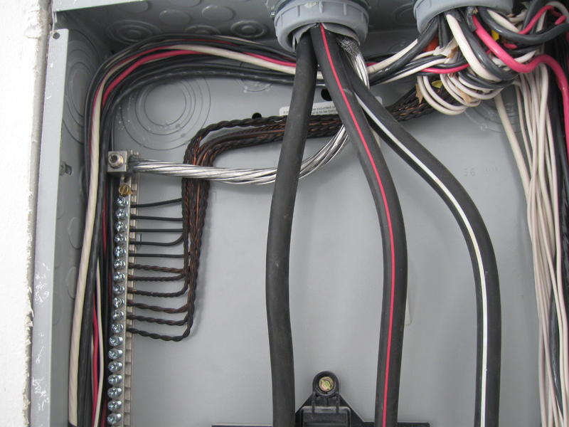

The main electrical grounds speak for themselves, they are black. It appears that the home has contaminated Chinese drywall. I recommend testing and deconstruction for conformation. There was no need to report it they knew even before I showed up.
Removal of the drywall seems to be the only answer.

I am not sure of the builder, but it is SW Palm Bay, Just South of Jupiter Blvd by Elderon.
I was actually most interested in the age. Did it fit the profile for the age criteria normally expected (2004 or 5 ) or was it a remodel after the hurricanes? It was great that such obvious signs were present making the identification so easy. Truth is that it may not always be so, as I am sure you are aware.

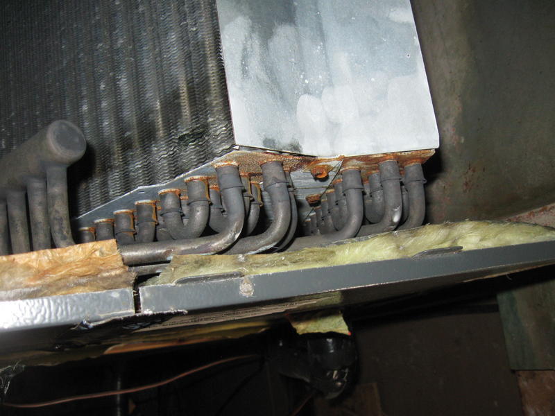

How’d the A/C coils look? Did you get a pic of them? Did you see the name brand in the attic? Built in 2007? Wow…interesting.
The coils are pictured below.
A significant portion of the house has drywall that was manufactured by Knauf Plasterboard Tianjin(as labeled). Portions of the drywall was , ASTM C139681395, manufactured in the United States of America.
I have also found Knauf Natural which is non reactive in other homes in the area.
