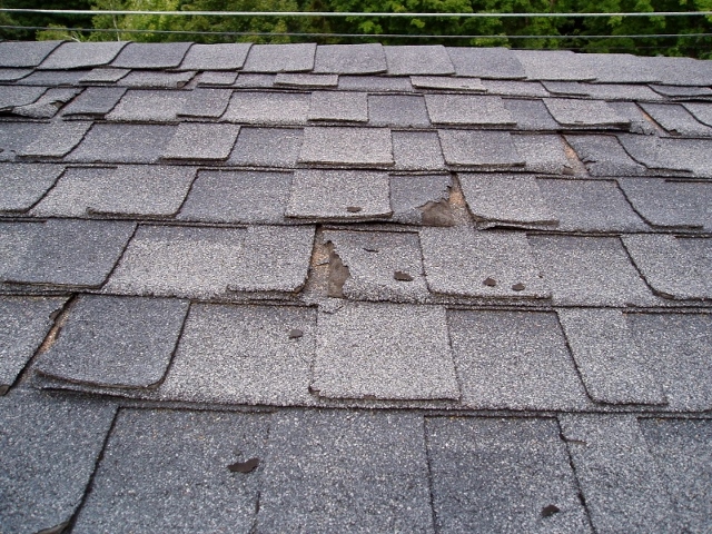

This photo of asphalt roof shingles shows cupping, delamination, the loss of granules, and wear of almost all shingle edges. The damage is due to the age of the shingles, high temperatures of the unvented attic below, high attic moisture levels due to the missing attic hatchway and persistent water problems in the house basement. This roof is at the end of its use-full service life. The attic view of the underside for the roof decking showed signs of localized water intrusion and uniform biological growth centered on the open attic hatch. Consult a qualified roofing specialist for an estimate on replacing this roof before further damage by water intrusion to the roof decking and framing.
