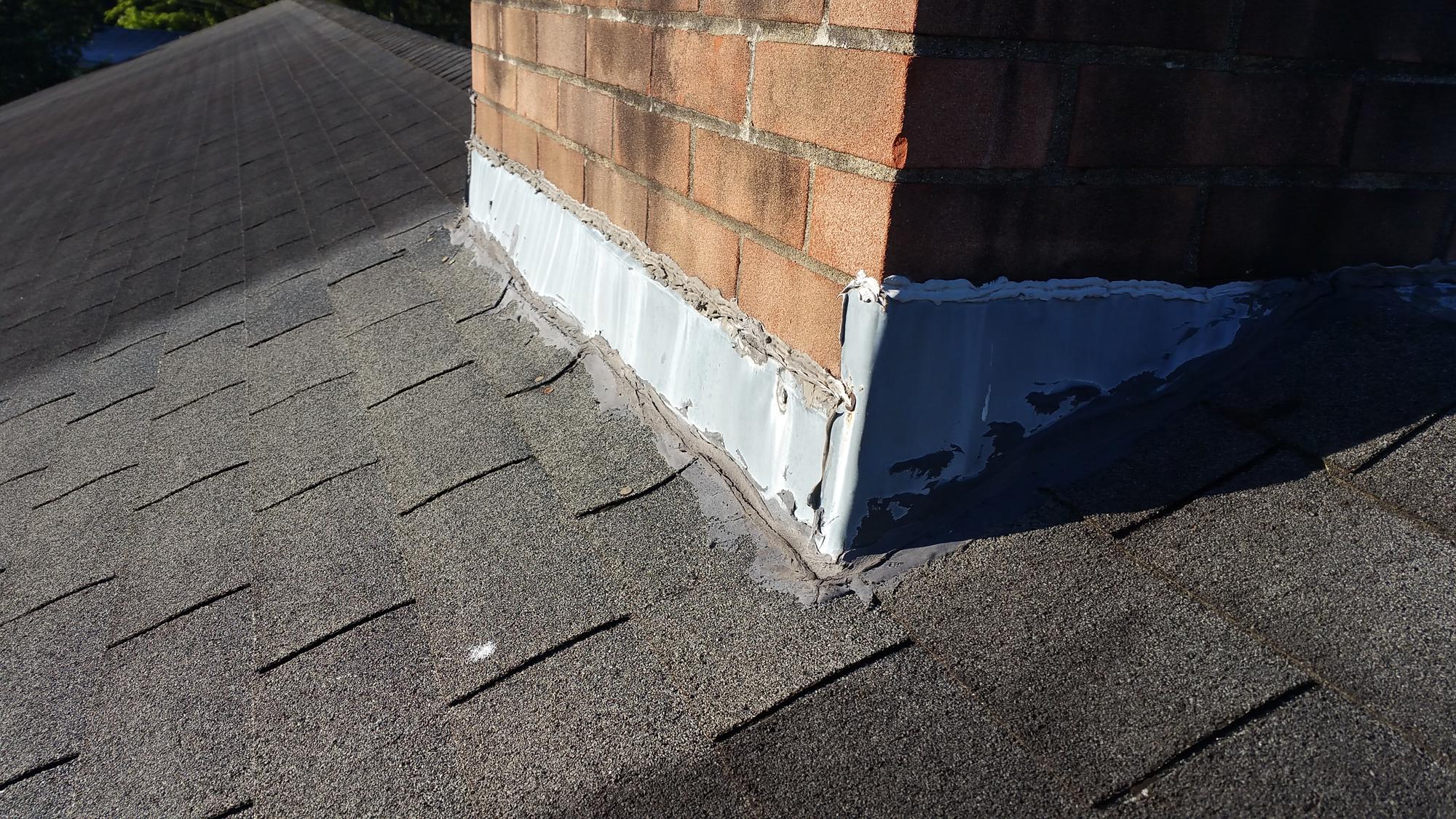

3 tab shingles were observed with discoloration caused by zinc-oxide loaded water she’d from the galvanized chimney flashing. Chimney flashing was not installed in a workman like manner. Shingles demonstrated severe degradation. Further investigation showed 3 layers of shingles.
This photo is of an archetectural style asphalt shingle in the first third of its life span. On the left you can see the improper chimney flashing (not step flashed or grooved). This roof appeared to be properly installed and in good condition.
