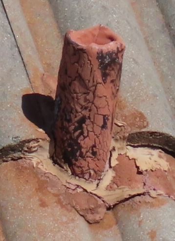

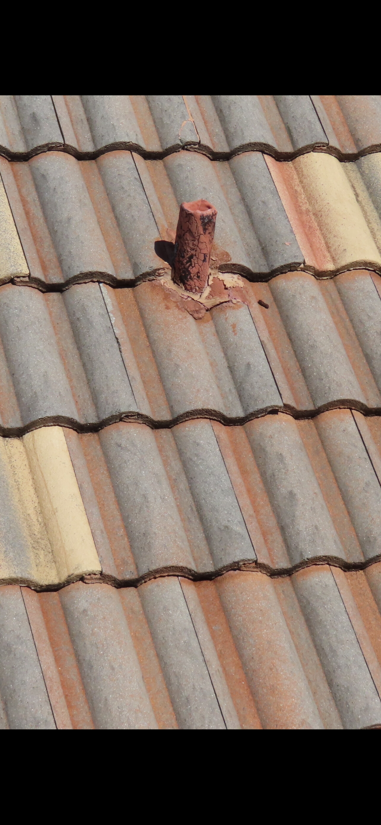

Would this stack be a defect since there is no stack flashing?

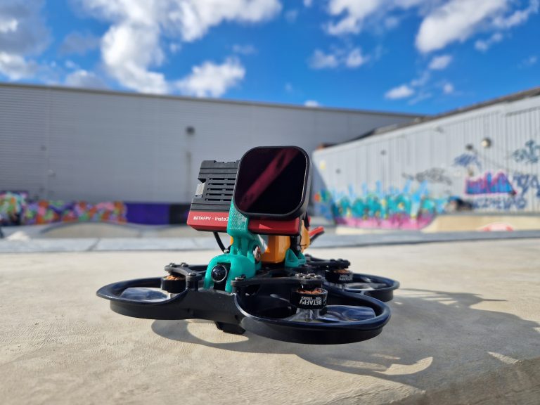

So I see that DJI just recently released the Avata II drone.
This is a first person “cine-whoop” drone with prop guards.
While it’s designed to move fast and do flips and tricks…it’s also designed to move in close and not accidentally have a RUD. You know, a Rapid, Unscheduled Disassembly.
I’m curious if anyone has used the prior version, the Avata I.
Being that I’m an impulsive spendthrift, I was thinking of buying one and playing with it to see how well it works. Of course, I’ve only had two roofs that were a problem. One I should never have gotten on, and another that I didn’t get on and could have used a drone.

Cinewhoop drones are first-person view (FPV) drones designed around flying close to subjects and in tight spaces. FPV drones are flown using a set of video goggles that receive a near real-time video feed from a camera on the drone, so the pilot can see from the drone’s perspective.
There is a galvanized steel plumbing pipe vent flange.
Yes, a defect. Area of immediate concern. Red flag. Sealant degradation.
