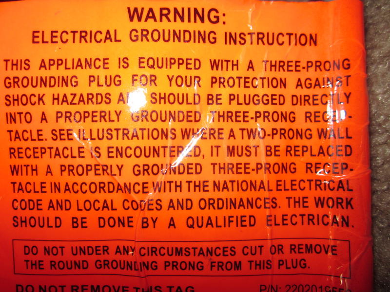

Ahhh, yes, just add GFCI protection and all’s well. A simple (and perhaps “Realtor friendly”) & inexpensive “fix”. Why is it, that in a, let’s say, 60 year old home, everthing else gets updated/replaced/upgraded? Perhaps 3 roofs, attic insulation, galvanized and cast iron plumbing, fuse panels, shag carpet, windows, doors, outlets;-), flooring, toilets, tubs, vanities, countertops, water heaters, furnaces, stoves, fridges, etc. etc. etc. all get done, but then the old, ungrounded wiring gets left behind. Out of sight, out of mind perhaps. Wouldn’t it just be easier just to update the wiring and be done with it? And besides, I certainly don’t want my 2 sump pumps, refrigerators, garage door opener, computer equipment, etc. etc. installed on a GFCI circuit. Below, is a picture of a tag from one of my 3-prong appliances (which I always include in a report when needed). Now the local codes and ordinances or the electrician may just suggest the GFCI route as well, and I always say that GFCI is an option, but I always suggest updating the “entire” system is the best approach, and recommended. I do realize (and always verbally tell clients) that the chances of something “happening” as the result of lack of grounding protection, is “slim”. Kinda like wearing a seat belt in a car or a bicycle helmet. You don’t “need” them when operating them, but if the “need” arises in a “situation”, it’s nice to have that safety feature.
Realtor friendly? It’s perfectly acceptable by NEC standards, what more do you need?
Which is completely unwarranted and cost prohibitive in most circumstance.
Look at the tag in your picture. It states that “it must be replaced in accordance with the NEC and local codes.” Well, the NEC does not require replacement.
Yours is a common misperception, which is usually the result of not fully understanding the function of the egc and/or the operation and function of a GFCI device.

If it just said, “or add GFCI protection”, it’d be so much easier, no?:). It does also state a grounded 3-prong outlet (and yes, I know of the little stickers in the GFCI boxes). And, again, I mentioned this already in my post that the electrician or local codes may suggest the GFCI route. I just don’t agree. And trying to “guess”, where I might be safely plugging in my shop vac or whatever, again, seems asinine, to me. If it were my house or a kid/family member of mine buying a house with an ungrounded/2-prong system, I’d be at the store, loading up with rolls of 12-2 wg and 3-prong outlets (and GFCI’s, where needed;-)). That’s just how I am/feel/roll.

Of course you don’t have to agree, and I will always respect your right to have your own opinion, although I’m not sure how you feel I’m taking anything out of context - keeping in mind that the cost of rewiring even a small house could easily exceed $10K.
If you truly understand the function of the egc and how GFCI protection works, then you know that adding the egc to a GFCI protected circuit does not make the system any safer.
The purpose of the egc is to clear a fault in equipment or appliances. The egc is not intended to provide protection to personnel.
The purpose of GFCI devices is to provide protection against electrical shock, however, they can also be used to clear a fault in equipment.
The requirements for three-wire systems were developed before residential GFCI protection had even been conceived. The three-wire system was designed to provide a low resistance path back to the OCPD in order to open and de-energize the circuit. Once the three-wire system was implemented, it became the standard for wiring.
