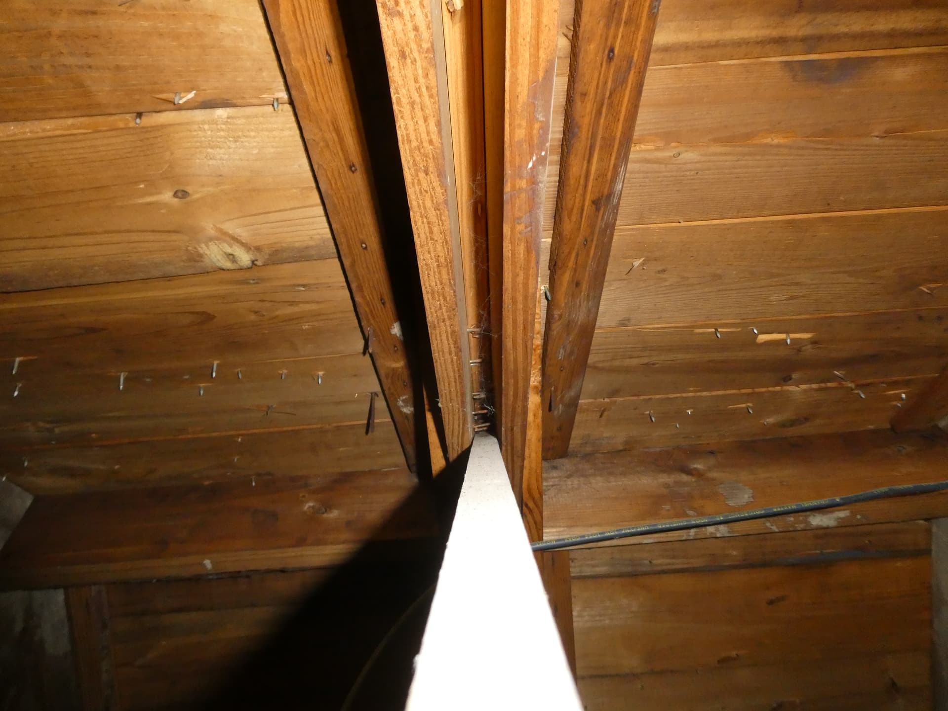

It’s both. I’ve never seen this before, every other support member was a truss, and a truss like I’ve never seen before either.
Ranch home built in 1953.
Ridge
Lower web attach point

Looks like an engineer designed his personal home.
Reminds me of site-built trusses designed for metal panel roofing, then modified with fill-in rafters to accomdate the current roofing (assuming asphalt shingles or other heavier covering).
I’ve seen a few like similar to that. Some real craftsmen back then.
I saw lots of these in the 50’s built houses in Calgary.
To me, it looks similar to post-war manufactured starter homes built around here in the same era as your subject house. They factory built wall panels and trusses and assembled them on site to quickly satisfy the high demand for homes after WWIi and Korean War. The tell-tell sign here is the thin 2x2 paneled walls.
Appears to be in excellent condition, especially considering the age.
there was a time when real carpenters built homes, and they were not completely framed in 12 hours…
I built trusses when I was younger, but never came upon that type of truss.
We hand built them to mimick todays’ trusses with plywood gussets.

The structure was in excellent condition, of course as it the case with all homes, older and newer, condition has as much to do about proper maintenance through the years as it does build quality at the time of construction.
That’s a lot of lumber!
Gotta love dimensional lumber! They don’t make em like that anymore unfortunately
Indeed, nicely done. That roof could last another 70 years.
I’ve built this style of truss when all I had available was 1” thick material. Which is what these are made of I believe.
