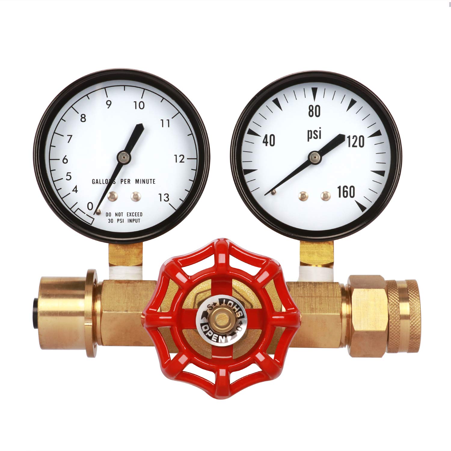

I always do a flow test when doing a well inspection and report the lowest flow rate in GPM that I observed. That said, while inspecting the home itself, I only do functional tests like you did by running shower(s) and sink(s) at the same time. If I witness low flow, whether I am inspecting the well or not, even if it is on municipal water supply, I will take a video of the problem (which quantifies it in relatable terms) plus also see what the water pressure and flow is at a hose bibb using the device below (that also quantifies it on objective terms). If the house is on a well, then low or fluctuating flow could mean a simple problem with the pressure switch (easy to fix), but is most often a problem with the pressure tank (which often fail without the homeowner knowing and $1,500 minimum to replace) which is why it is always a highlighted issue in my report.
