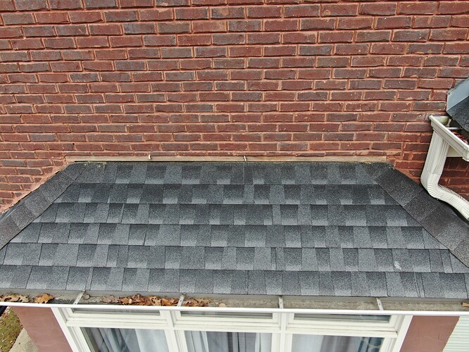

Is this a wood lintel?
I saw what appears to be a wood lintel above a dining room bay window. I’ve never seen anything like it and can’t find any supporting documentation anywhere. Has anyone seen anything like this? How would I write this up? The home is 26 years old, Birmingham, Alabama area, built in '96, brick cladding all around. There were a few other oddities, like the ends of the gutters were recessed into the cladding. Never saw that before either.
Any advice on how to handle a wood lintel would be appreciated. Thanks a bunch! - Tony
Looks like it. That is stunning. Looks nothing like the way it’s supposed to be constructed. Good lord.
Looks like amateur workmanship. Search Google “lintel for brick clad window opening”. Plenty of images to give you an idea of how it should be. Angle iron for the span would be good start. There’s no flashing.
Write up: Bay window opening/edition is poor workmanship. Missing flashing and questionable structural integrity where roofline meets brick veneer. Recommended review and/or repair by licensed/qualified contractor.
Regardless of what his intent was, it’s screwed up. I would write it up as no visible flashing and exposed wood subject to rot.
That looks like a very old house; what appears to be a metal lintel is visible above the wood member along with weep rope. I think that the original wood member got replaced and was originally used to support the porch roof. I attached a picture of my parent’s house which was build in late1800’s where you can see the wood member which was holding the original porch roof.
Hey guys, Thanks for all the input. I looked for a metal lintel which would extend beyond the the width of the wood but didn’t see any signs. They even went so far as to cut the brick above the lintel to make it fit. I believe this may be an “after market” addition and there wasn’t a lintel there at all. There’s no flashing; instead they piled on the mortar and then went back to apply some caulk to try and seal it all. Definitely a mess.
Absolute garbage and dangerous when it starts coming off the wall.
The weight of the bricks could be setting on a wood beam and they did not install the lead flashing leaving wood exposed

Missing Headwall and counter flashing.
I have seen wood strips like that inlaid between bricks on the inside of old brick buildings. I assumed they were nailing strips. You parent’s house and the OP’s photo may have been the result of porch renovation that shortened or lowered the porch exposing the wood strips.
Is it functioning as intended? I is it allowing water intrusion? Is there any deterioration of the wood? Is there any sturctural failure of the masonry around it ? If the answer to any of thise questions is yes, then report on the damage and mention that you have observed the damage and that the damage could be assoicated with the wood lentil. Unless your are an engineer or even a licensed contractor, it is not your responsibility. You’re a home inspector and you are doing a ‘general visual inspection’. Just do the job you were hired to do. Don’t play structural engineer unless you are one and you were hired to do a structural inspection.
