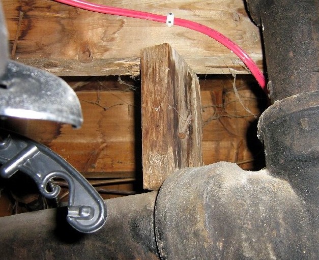

During my HI training program I found this joist cut off (from right side) and supported this way in the basement:shock: .
</IMG>
</IMG>
You will find crazier things than that in the future, believe me…:margarit:
Welcome to the club though…!!
Was this on a ride along or were you doing the inspection? How did you write it up?
A friend of mine was looking to buy this house and asked me if I wanted a first crack at this to help me with my HI trainning and experience. I used checklist and demo of Homegauge to create the report. I reported it as inadequate support of floor joist. There is a great risk of damage to drain pipe. How would you report this? thx Adam
