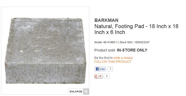

Footers relate to a single footing under a post, in pier, post and beam style construction but not only. A per-say 3 by 3 foot square filled 10 inches high, with cement and the post being on top center. It stops the post from being thrust into the ground under loads…

Footer Pads and Post Block
It.s not a normal term used in residential building.
