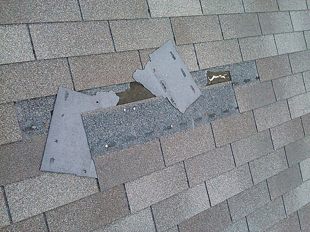

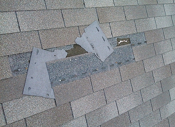

Slope facing to the west. shows signs of wind damage. two shingles detached and under-layment damaged.

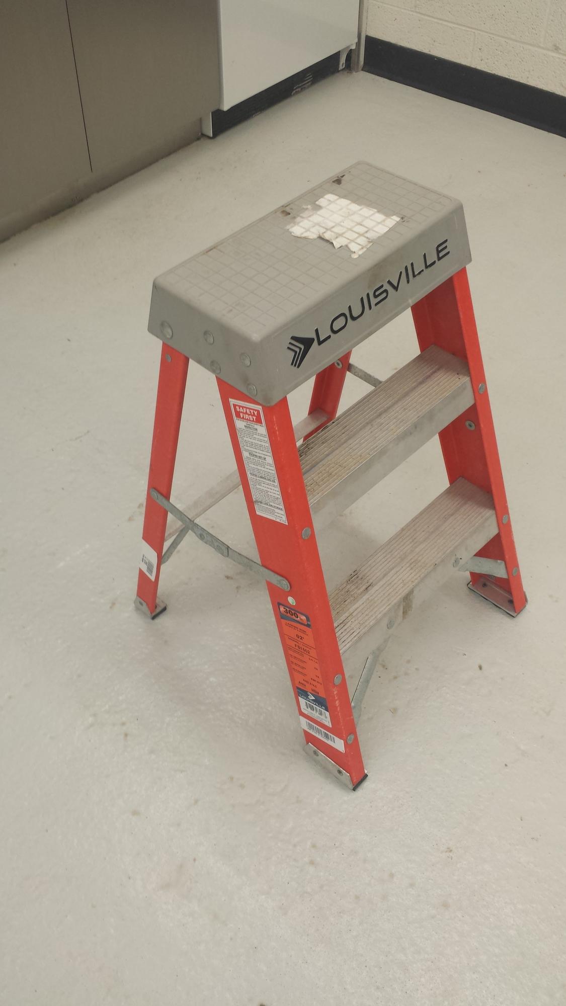

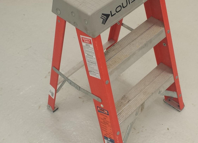

Since this course was over Ladder safety I inspected a ladder. As I inspected it I looked for loose rivets, cracking in fiberglass, dirty/greasy spots, feet, and overall appearance. This ladder appears to be in great condition with no defects or damage. I would feel comfortable and safe using this ladder. I also checked for all warning labels and instructions and they were all in the appropriate place and were not damaged, this ladder is rated for 300 LBS.

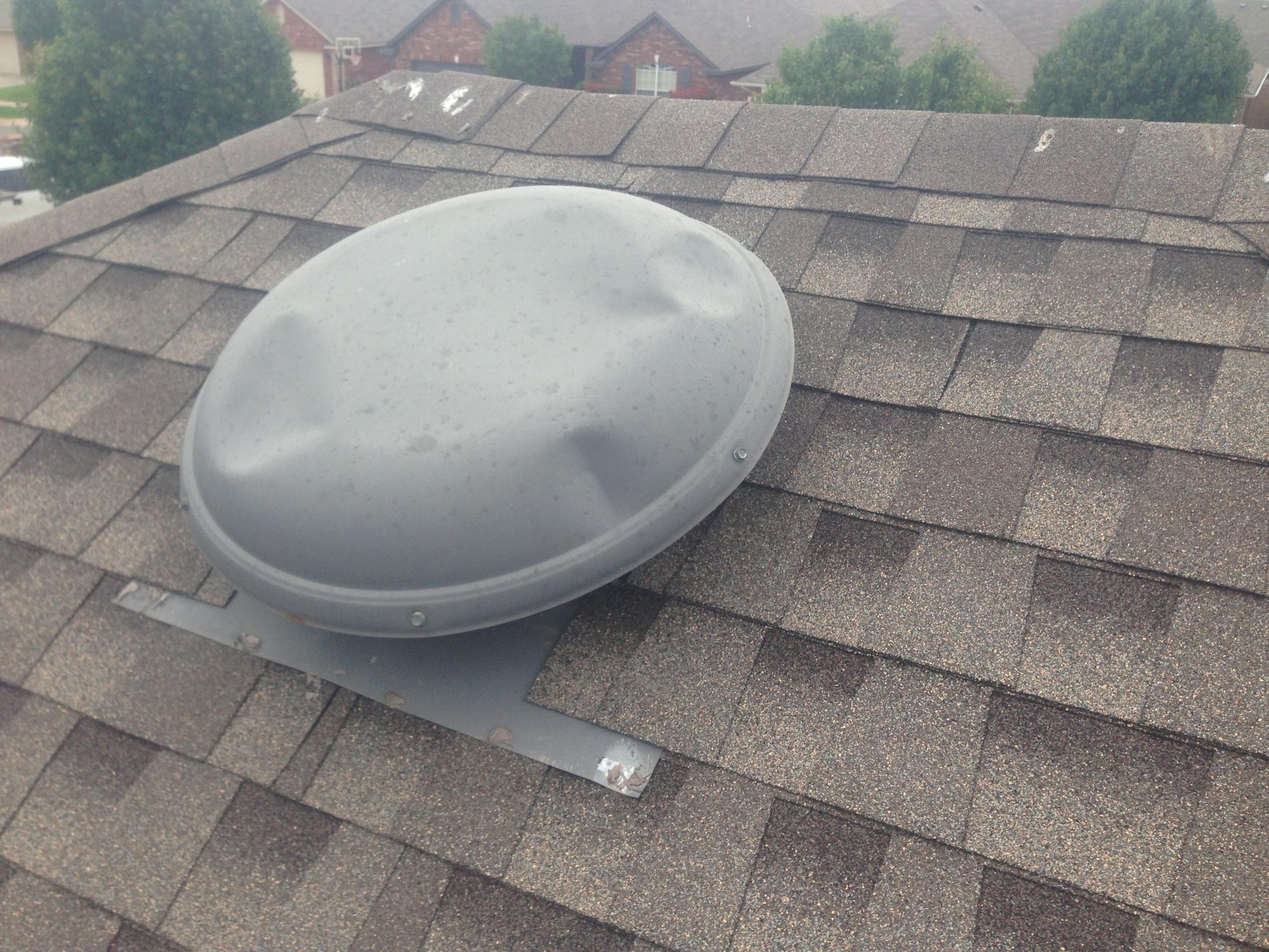

The power ventilator for this home has been damaged from hail stones in an Oklahoma hail storm. The storm also caused significant damage to the shingles on this roof. It is recommended that roof be replaced and all vent caps due to the damages caused by this storm.

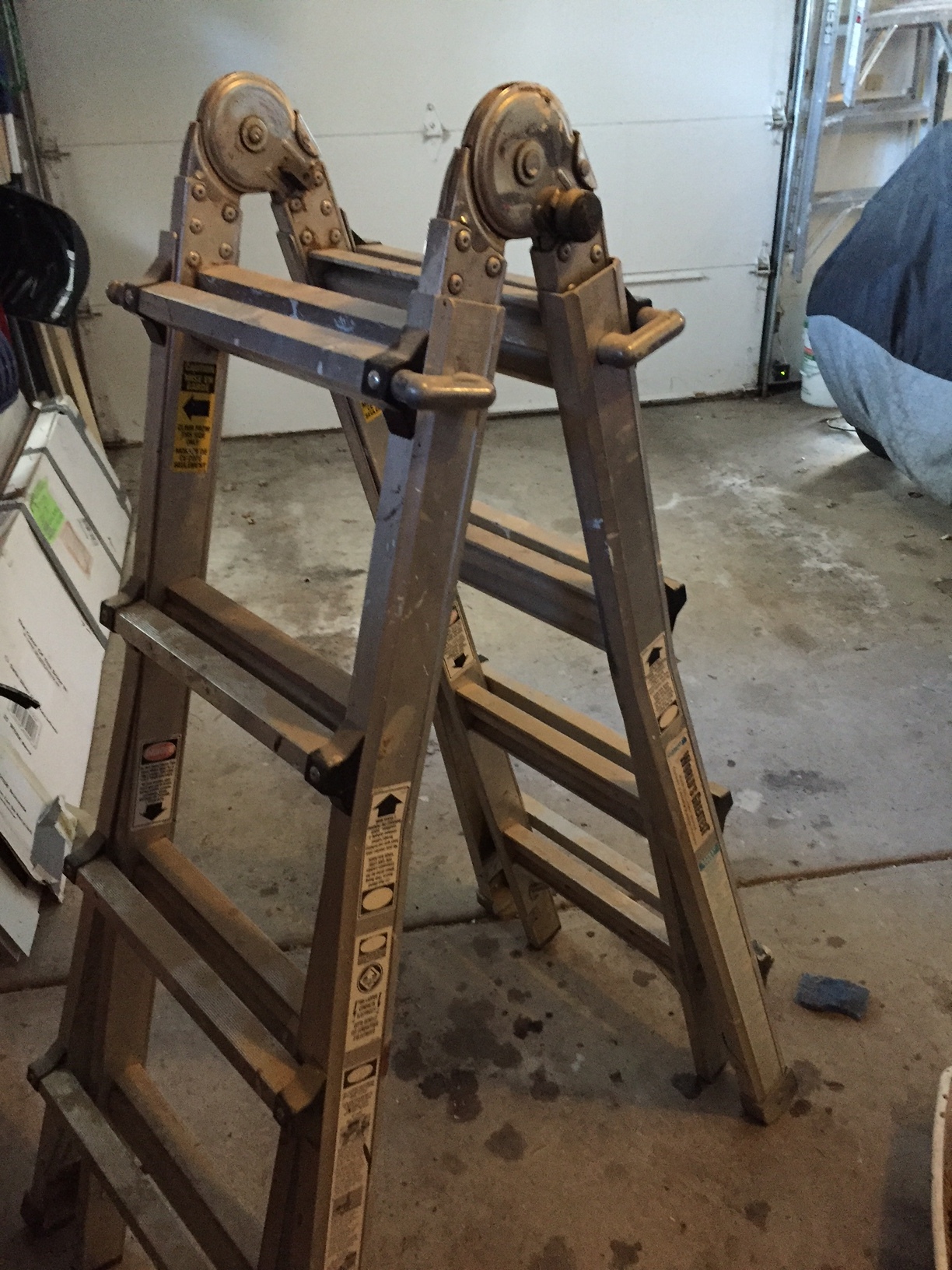

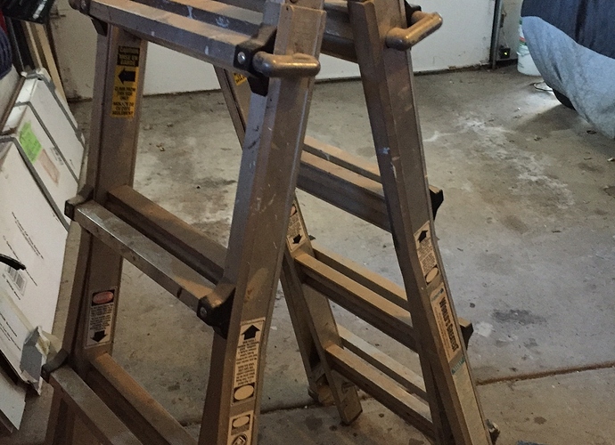

I inspect my ladder every time I set it up. It is the only ladder I trust. I know my ladder’s limitations, and I do my best to take care of it. As it has moving parts, I have to also be careful not to get hurt setting it up and taking it down.
Attached is a photo of my Articulated ladder that I use for home inspections. Max extension is 17 feet with a step ladder of 7 feet 8 inches. The combination makes it really nice for working inside and out.

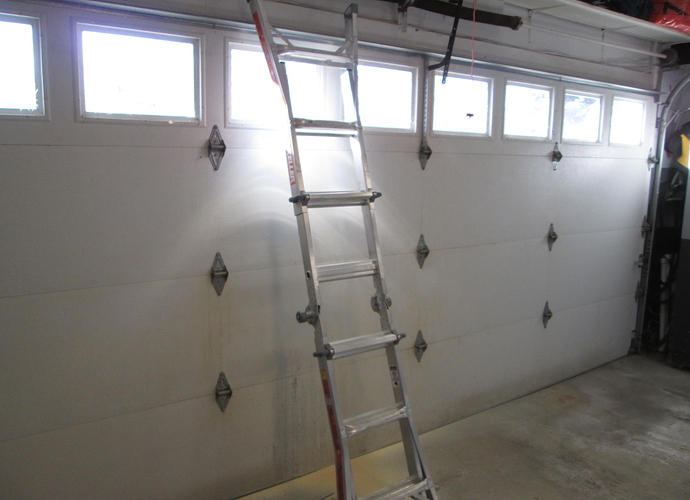

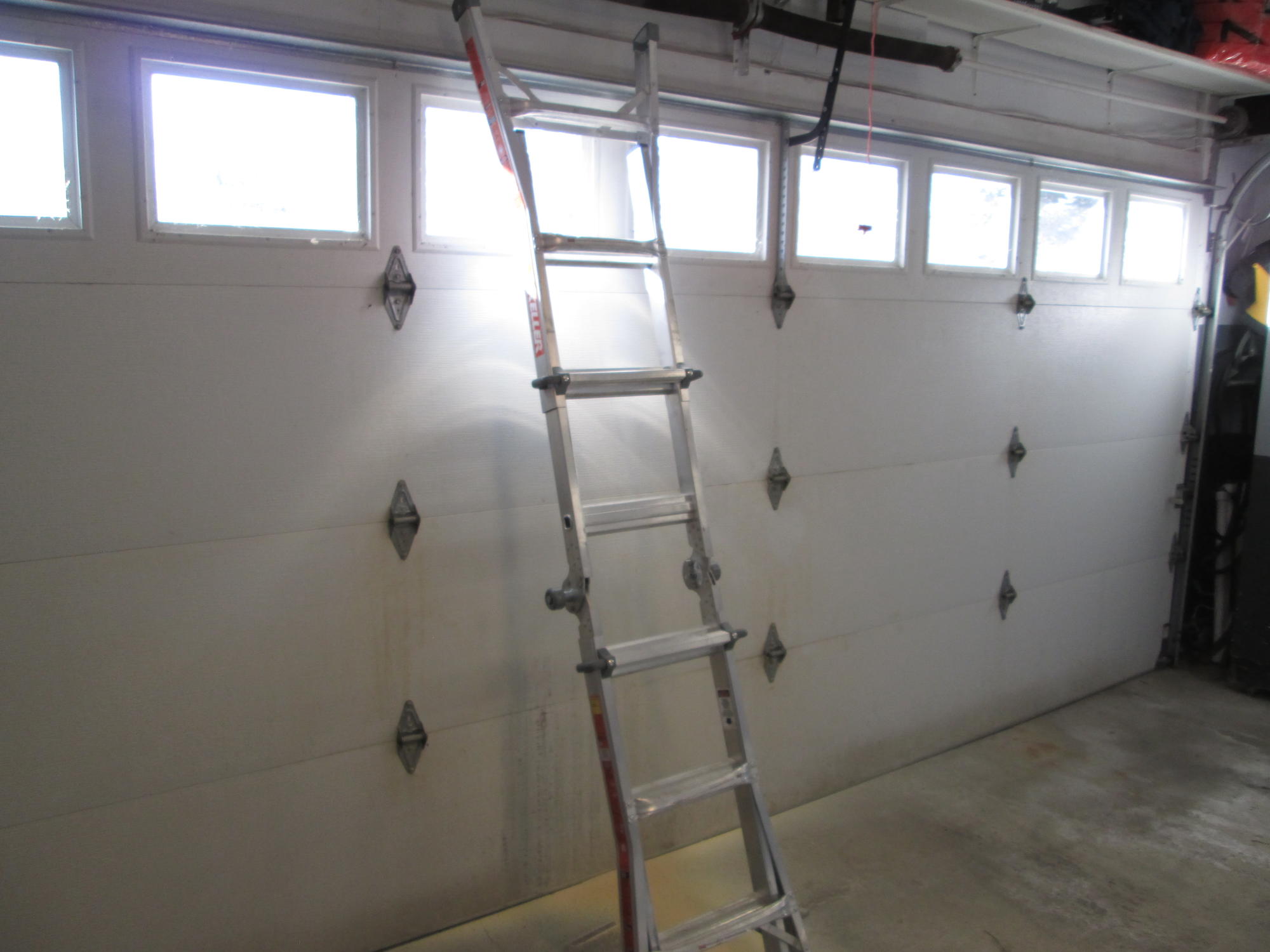

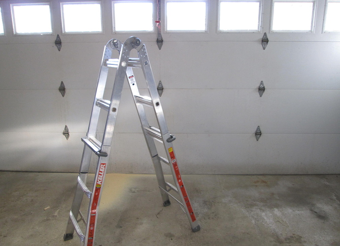

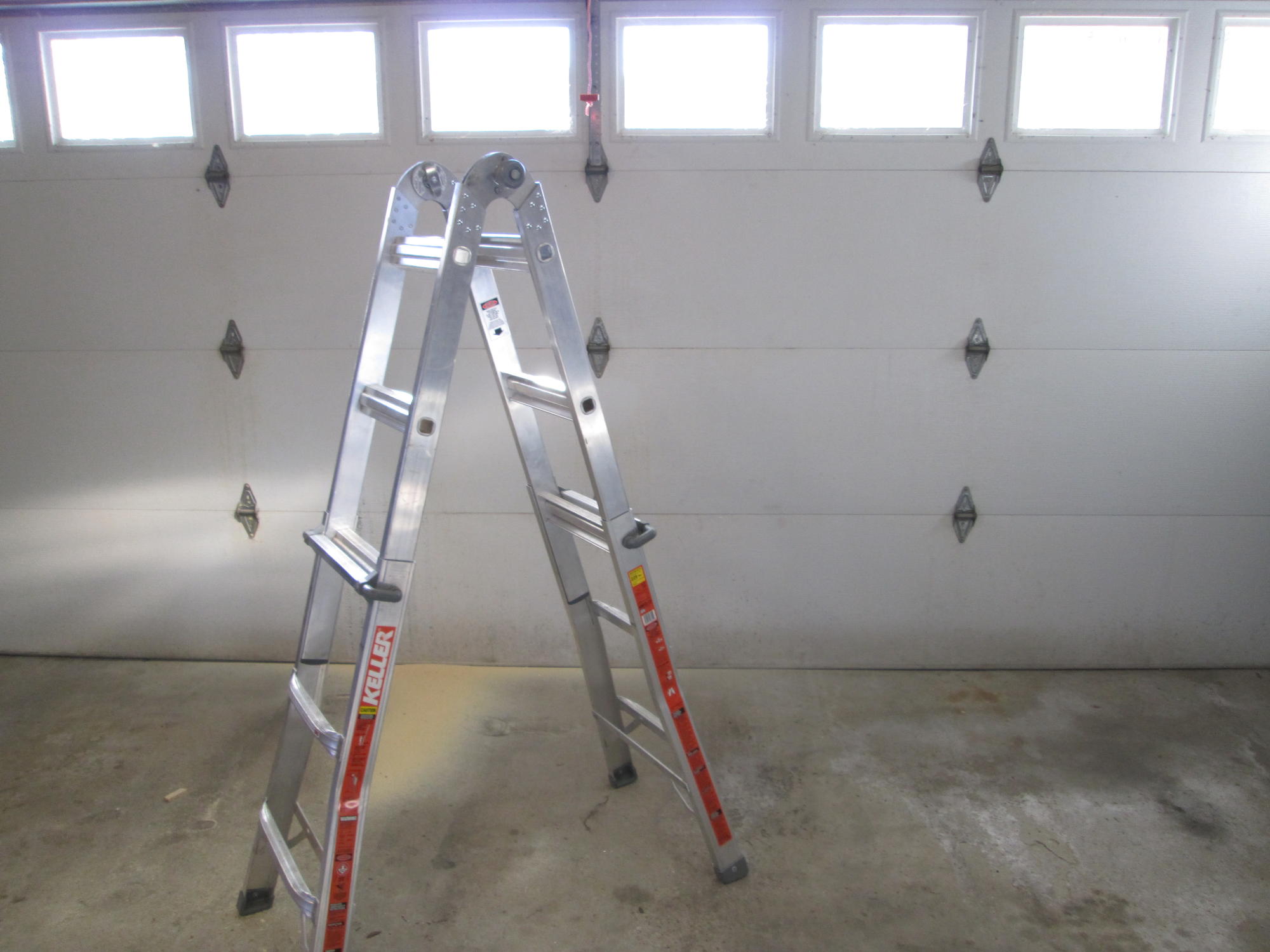

Articulating ladders
Articulatingladders are the best idea in ladders for many reasons. Storing them is easierthen Extension and stepladders. Here are two pictures of an Articulating ladderfor simple use in a garage. One as a stepladder second as an extension ladder. Theyare easier to transport in a pickup truck also. No need for ladder racks on thetruck.

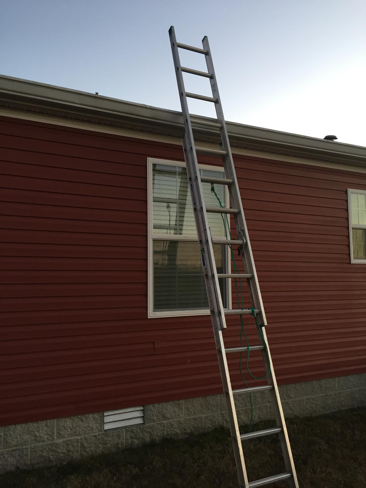

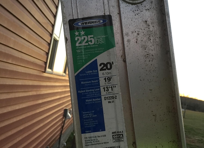

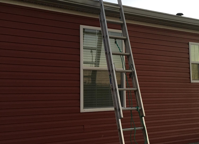

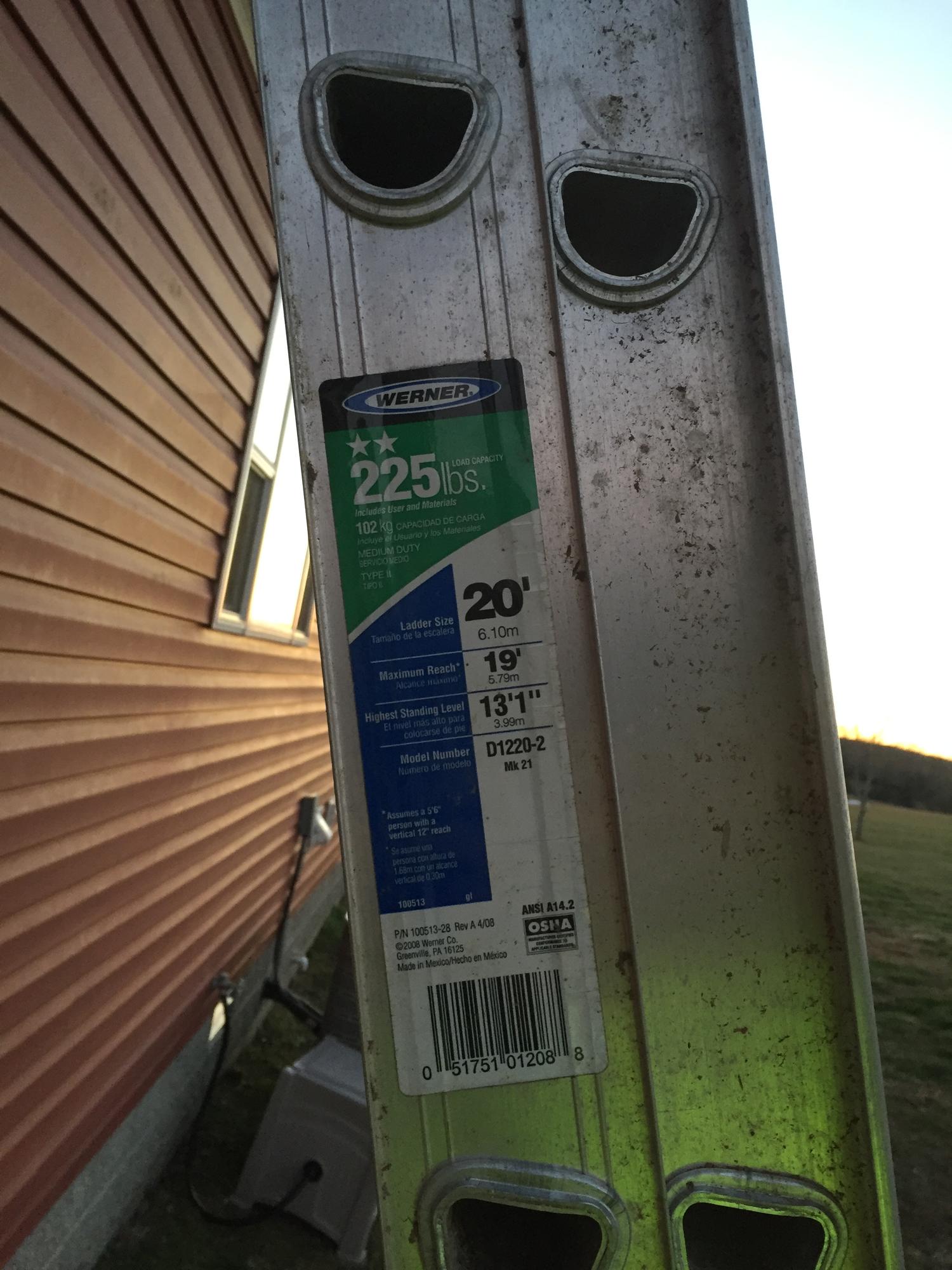

The ladder safety part was something I have had training on, so this was a nice break. I have to say this course is cut and dry on the ladder safety, this follows any 40hr osha training I have. This will help anyone who is not familiar with ladder use, and help keep them safe. I think the 3Ft rule of thumb for above the roof should be higher in my opinion for safety. I put my ladder 3 ft above roof and climb up and down safely and have pictures to follow, also my ladder is a II 225 rated. Thanks
