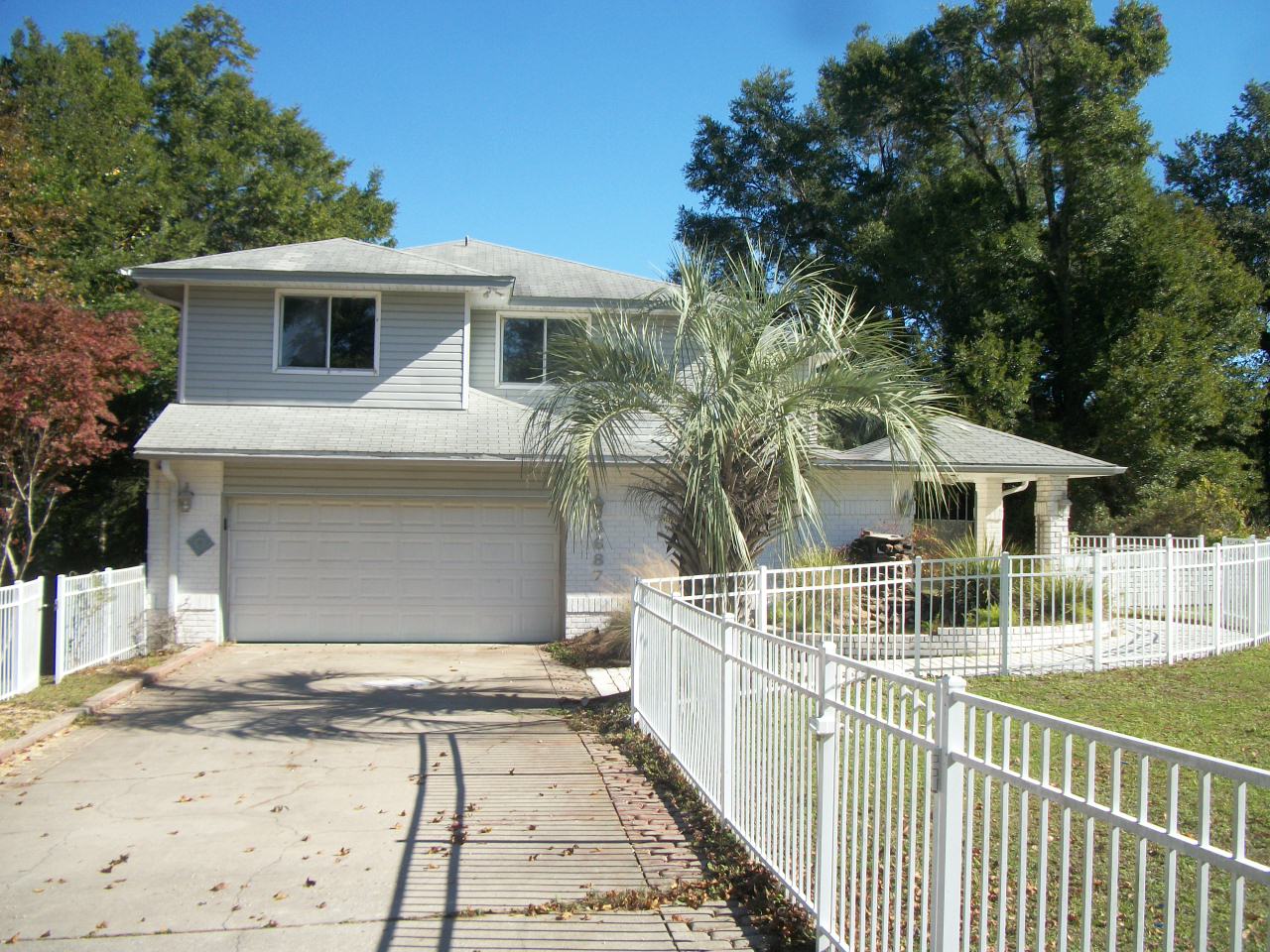

Ladder Safety Training course: Not sure what system or component to write an essay on for this but I would guess the roof? One of the things I have seen an inspector do is use a short articulating ladder on a two story house. This involves climbing to a lower roof section like the garage. Then pulling the ladder to the roof and using it to access the second story. I’ll let you use your imagination to envision the number of things that can go wrong with this plan of attack.

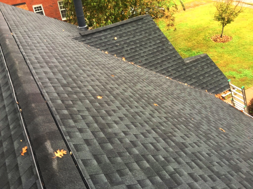

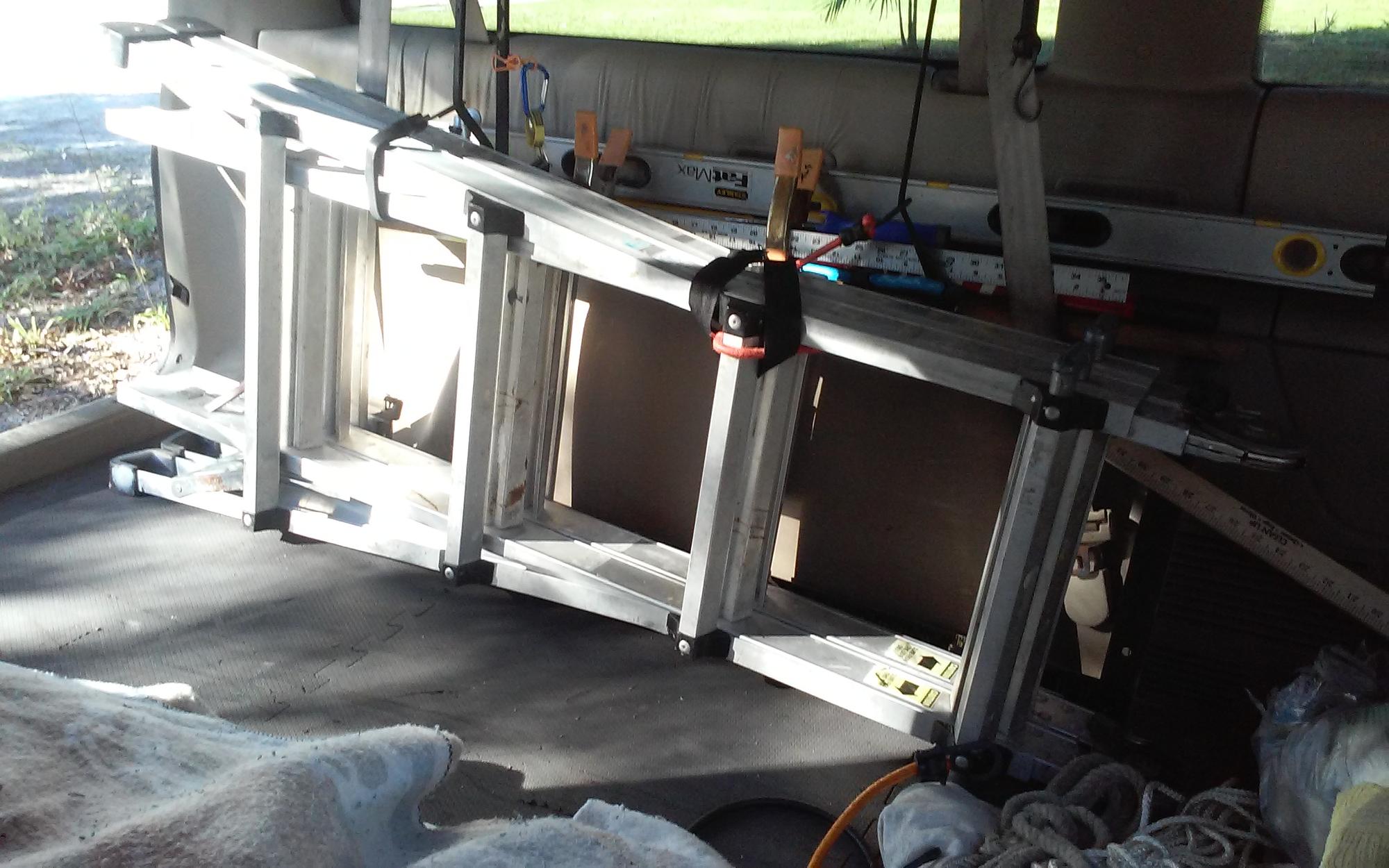

This is the view from atop my Xtend & Climb 780P Telescoping ladder. I have been very pleased with this ladder, it fits in a car trunk and can be carried through a four story townhouse without knocking over vases and picture frames. It is also more stable (less flex-y) than my 22 foot Werner or my aluminum extension ladder. I have the 12.5 foot model and once it wears out, I’ll get the longer model. It’s about 4 years older, so I’ll probably retire it next year.

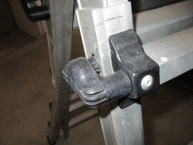

Enclosed photo is of a Rail Lock.
This rail lock is in functional condition and is used to adjust the height of the extension or step ladder depending on the configuration. Generally speaking this particular type of ladder has a rail lock on each side which should be fully engaged into the receiving hole prior to use.
The rail lock mechanism should be regularly cleaned and greased to ensure safe operation and prevent corrosion

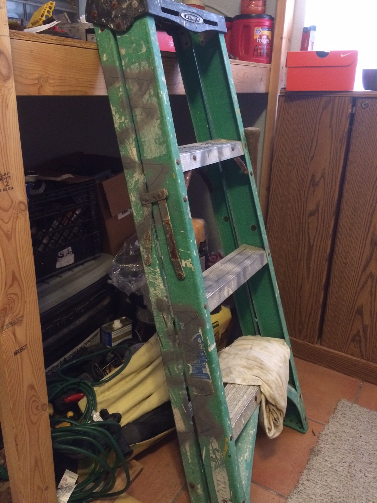

this my 4ft. step ladder .I use it most everyday, rite now it is in my office leaning on some shelves.

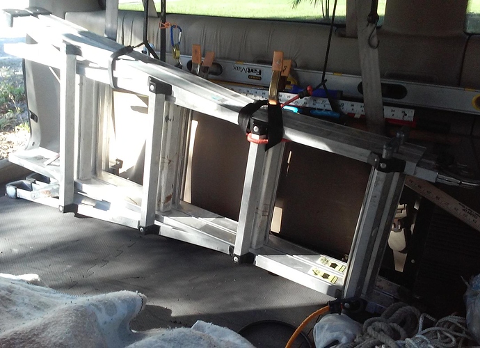

this is Carlos I mendoza here its a picture of my telescoping extension ladder.

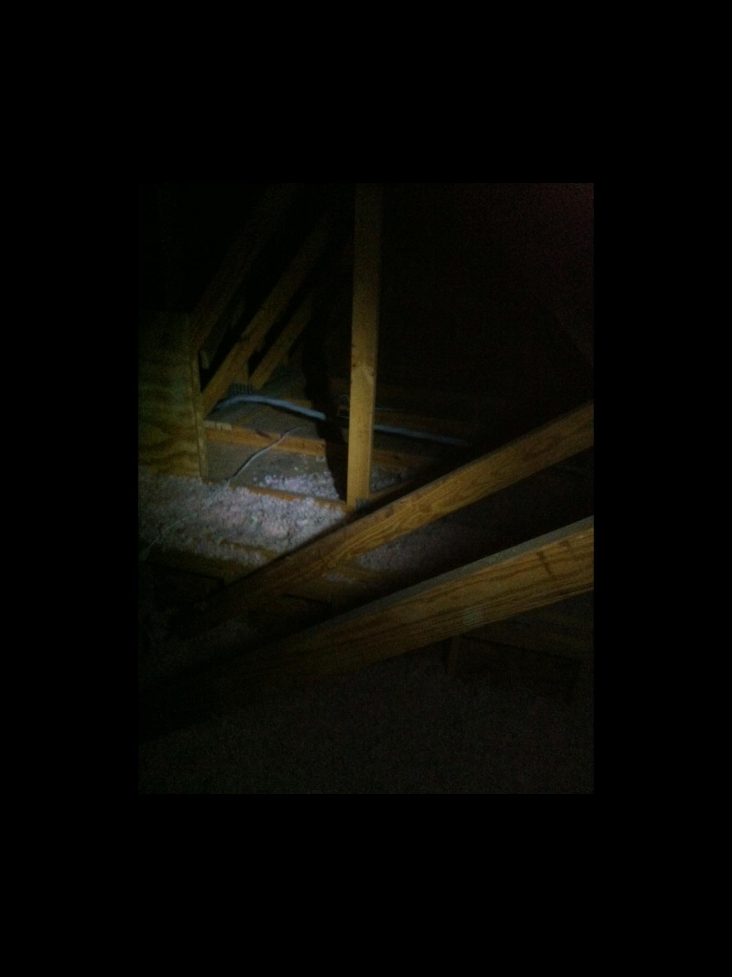

Starting with Installalling Attic Insulation Most of this attic was well insulated. The two issues were both at the far end of the home. The one is uninsulated over the dinning nook which explains the warm and cool drafts experienced in the dining nook. That is the attached photo. The vent to the soffit in another area had over blown insulation which impedes the flow of air.

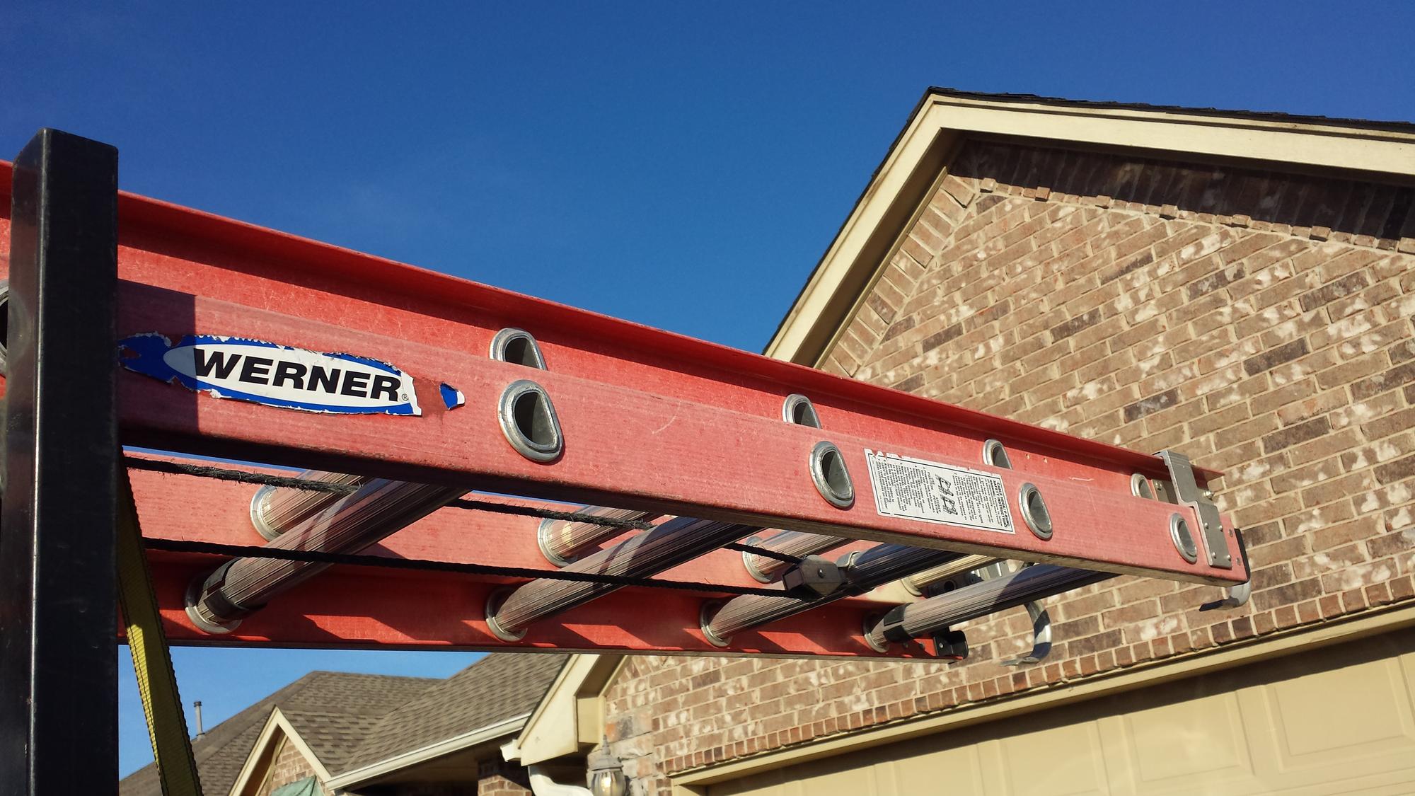

24 Ft Extension Ladder
I inspected my husbands 24 foot fiberglass Werner extension ladder. I first inspected the pulley system it moved accurately and freely and rung locks engage and dis-engage properly. I checked all rungs and side rail connections for tightness, as well as for dirt and debris. The ant slip safety feet were recently replaced due to wear and tear so are like new. The ladder was in perfect and safe working order passing my inspect. My husband works for a large cable company so his equipment must always meet or exceed OSHA guidelines anyway. But it was interesting to be able to perform my own inspection and learn of how his company performs their inspects.
