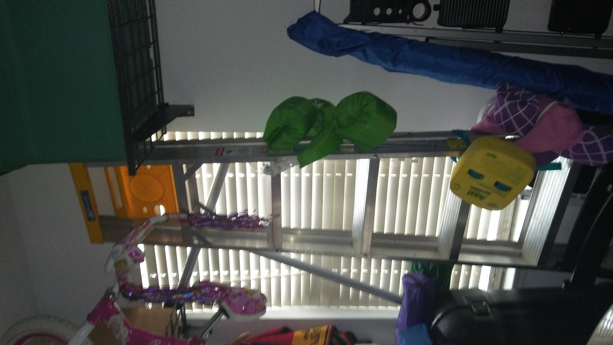

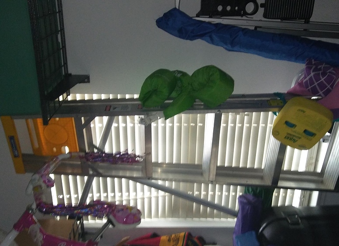

This was a great course! I learned a lot. The image is of a stepladder that will need to be inspected or probably replaced before use. We actually back into it in the garage on a regular basis. NOT GOOD. So we will be replacing that ladder and finding a better place to store the new one. Key points. #1 I never knew to rotate the bottom feet of an extension ladder to “dig into” the earth for a better, more stable foundation. That huge! I have always used the feet because I thought that was the right way. #2 the 4:1 rule Good to have a rue to lean by and it makes perfect sense. #3 The maximum working height of a ladder and 3-4 foot clearance above the roof for getting on and off the roof. #4 Tying off the ladder. This is another crucial point I have been neglecting that could save my life. Great stuff and I enjoyed the repetition driving the points home.

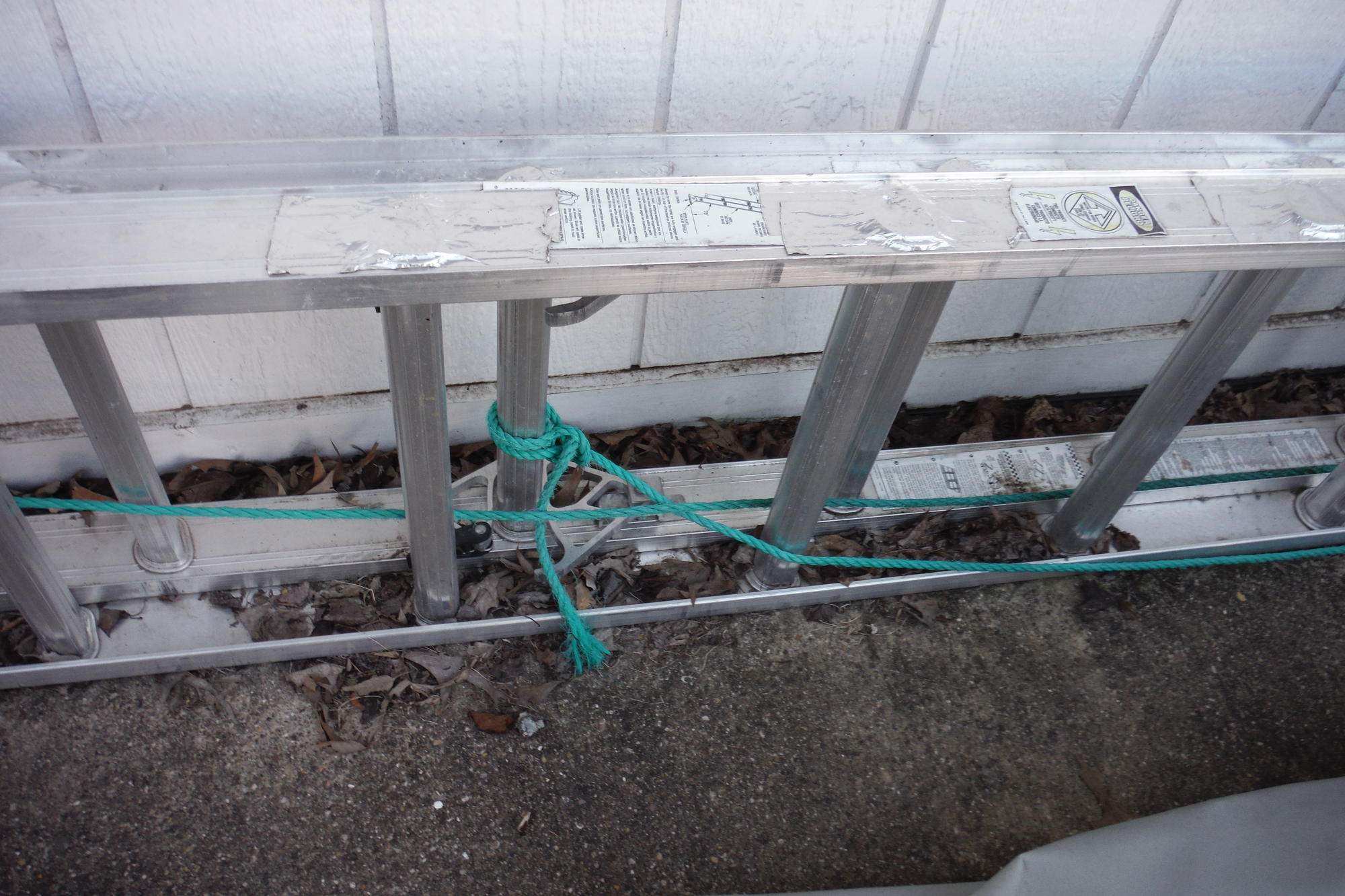

The photograph shows a two-piece aluminum extension ladder. The steps on the ladder are in good condition and are fastened correctly to the side rails of the ladder. The steps are knurled for slip protection. The pulley system on the ladder is in good condition, however, the rope for the pulley system shows signs of wear and deterioration. The ladder should not be used until a new rope for the pulley system has been installed.

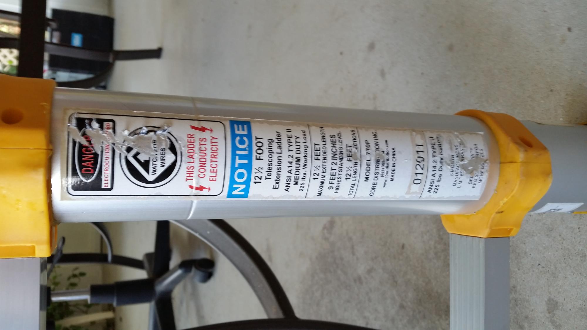

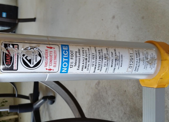

Telescoping ladders are extremely handy, lightweight, and useful for home inspectors. Extreme caution should be taken with this type of ladder due to pin system that is used to lock the leg sections into place. Routine inspections should be performed to insure that the telescoping ladder is clean and free from dirt, grease, and debris. The locking pin systems should be inspected for proper function. When using the telescoping ladder, verify each pin on each side of both rails to insure that they are locked into place before standing on the ladder and to prevent potential falls.

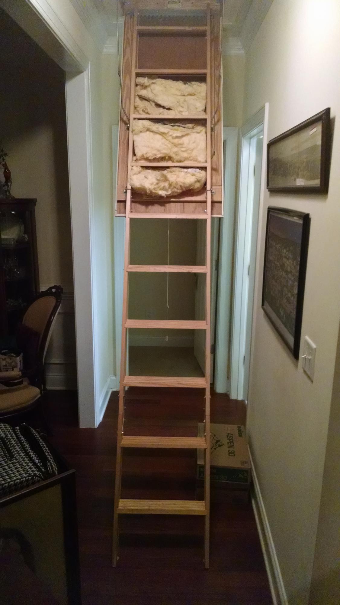

This is a pull-down attic access stairway. In the closed position, it appears to seal effectively, however, when opened, you can see that the available insulation is inadequate for the ceiling space.
