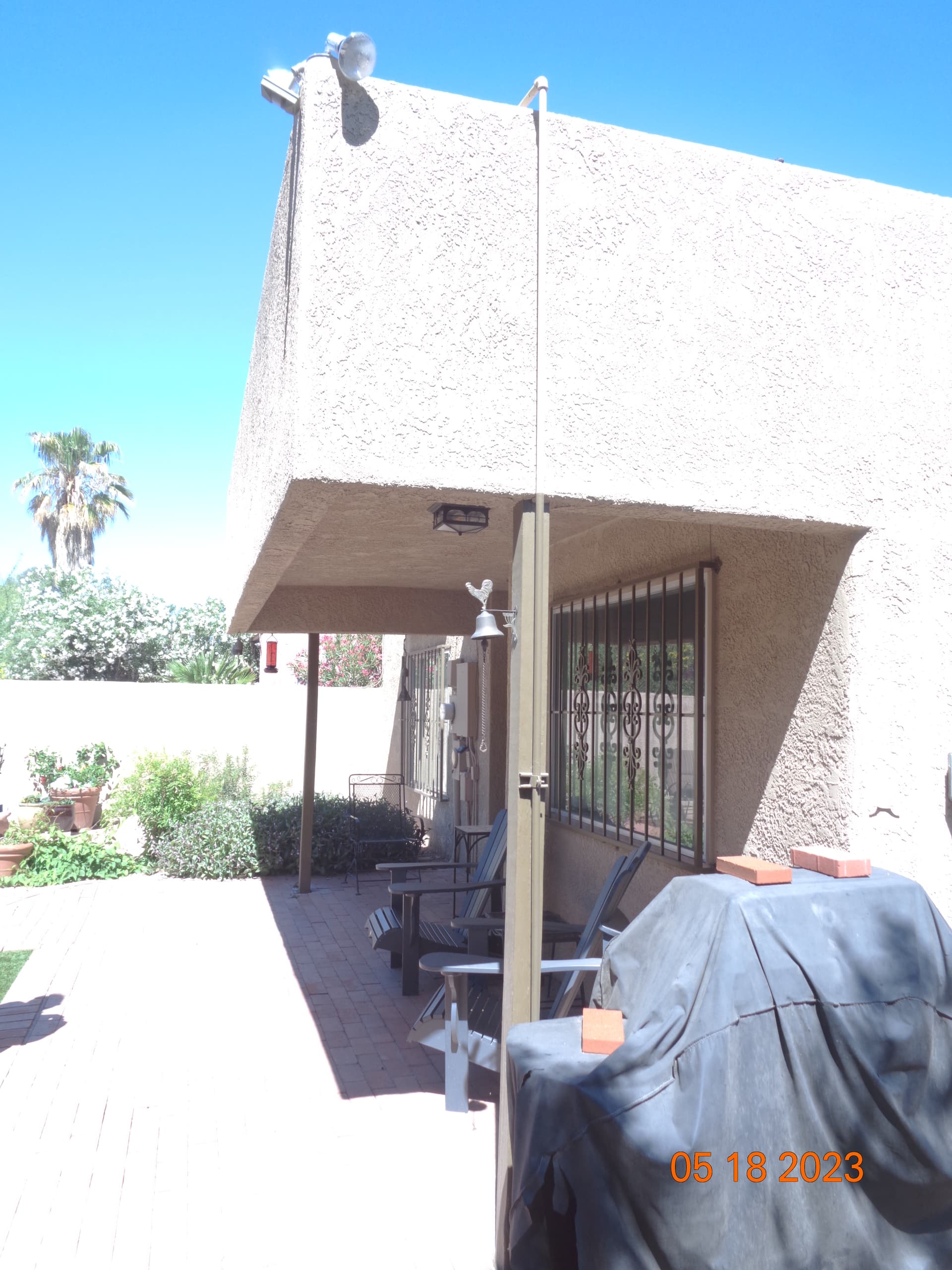

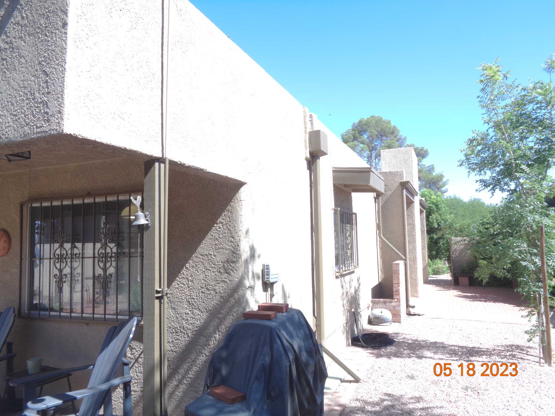

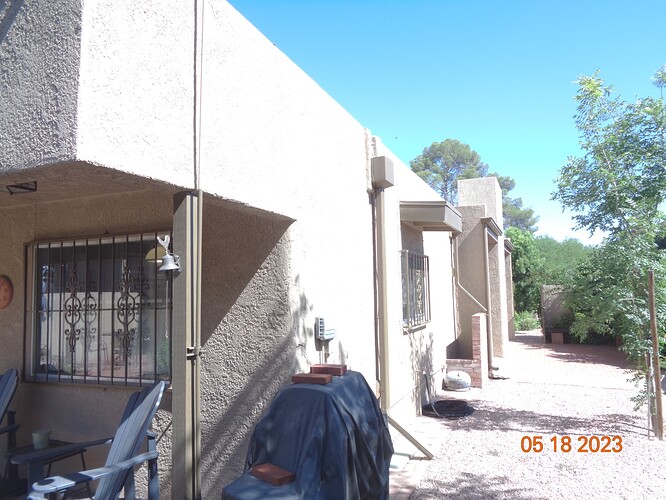

2 4x4s holding this entire roof overhang…
I would refer that out if it were my inspection, Mark… :flushed:
great idea, looks sketchy to me
Most likely an engineered cantilever with added support. :thinking:
The “added support” is what appears problematic, to me. :man_shrugging:
I mean, “why”? if it was an engineered system?
Maybe it was added to run their electrical conduct up to the roof? or hang their plant pot. lol.
