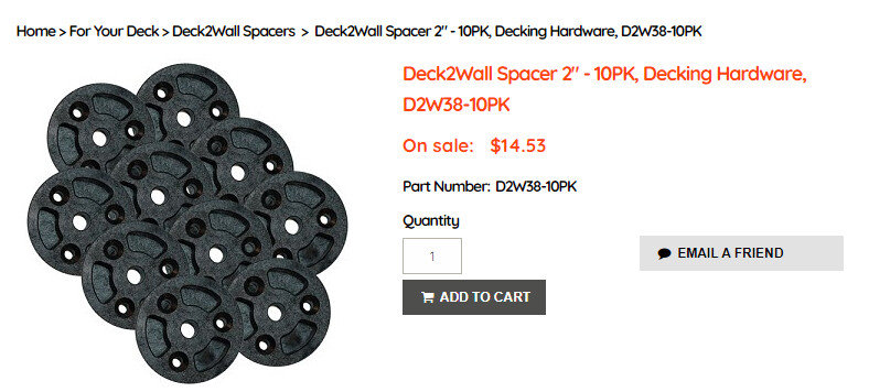

Yeah but, Back in the day, The ledger was attached over the siding with spacer blocks, water would run behind the ledger board and over the siding, no ledger flashing was required with this method. Not to say that this is the right method of installation, it is just to say that is how it was done back in the day.

Interesting, I didn’t know that was an approved installation back in the day, but can clearly see the reason why that method is no longer acceptable.

Who said that it was an approved method? That is how the old timers showed me how to attach a ledger board back in the day. And no, I do not use that method now, but you can still see this type of attachment used, probably by the stubborn old timer carpenter saying you are not telling me what to do, this is how I have been doing this for years.LOL. :smiley:
