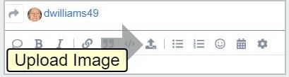

Be sure your images are JPEG.
I use Windows snipping tool.
Select the Start button, type snipping tool in the search box on the taskbar, and then select Snipping Tool from the list of results.
1: Copy an image and save to your photo folder.
2: In the menu bar, hover your courser over the upload tab, the tab with the arrow pointing up, left click and a drop box will appear. Images below.
Menue bar illustration
Popup Box
3: Choose/pick/drag and drop the image you wish to upload from your picture file and left click or drag and drop the jpeg over to the box and left click on the upload tumbball image.
4: Post a brief or long description and Bob’s Your Uncle mate. …“you’re all set” or “you’ve got it made.”

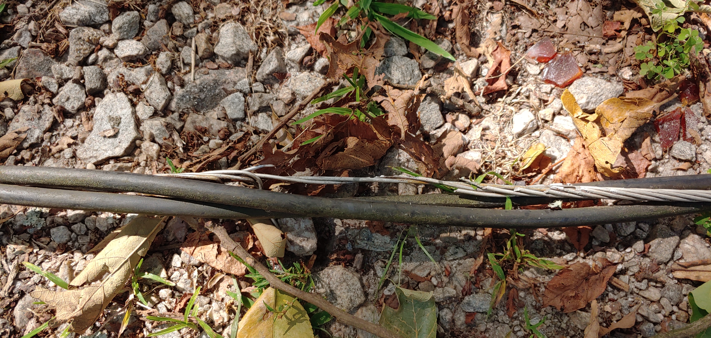

Well, I solved the problem of the pulsating lights today. Or, I should say, a young power company service tech named Matt S. solved it. I phoned Georgia Power about 2:00 pm and asked if they would have someone check my service coming in from the street. Some trees near the street were bearing on the overhead cables, and the transformer didn’t look to healthy either. Within three hours of my phone call, Matt had cut a couple of small limbs away and had identified the real problem as squirrels gnawing on the cables, particularly the neutral. At one location on the wire, there were only two strands of the aluminum remaining. And one of the ungrounded conductors fared almost as badly, with three strands remaining under the gnawed sheathing.
That one strand (center strand) is untouched because the neutral is these triplex cables is ASCR (Aluminum Conductor Steel Reinforced) meaning that the center strand is made from galvanized steel which is not as good of a conductor compared to the aluminum. That strand and what is left of the other one that is barely intact was carrying all of the neutral current. Your original problem with the washer was symptomatic of a bad neutral. Southwire actually makes a product called SquirrelShield Triplex for area where squirrels are a problem.
