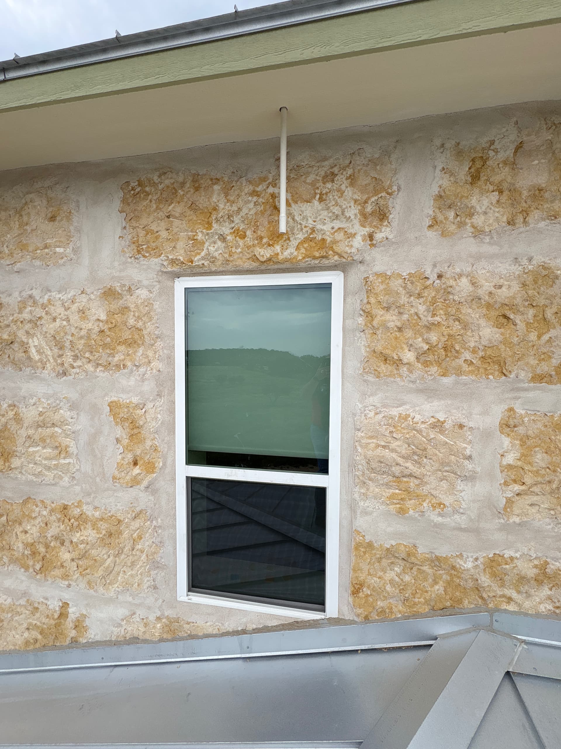

I’m heading over to a client’s new home here in the Texas Hill Country. It is constructed with large, limestone blocks and mortar. This is NOT limestone veneer! Has anyone inspected this kind of construction before?

Hey Robert, thanks for your help. In our part of the country, (Texas Hill Country) limestone is abundant and a popular component in construction. The home in question is using limestone blocks as a structural wall component. The blocks are approximately 18” thick.

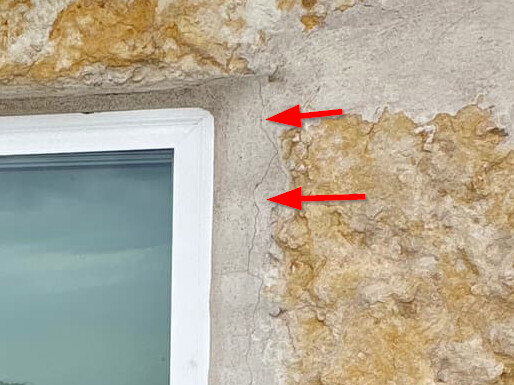

What sticks out to me is the lack of gap between dis-similar materials.
For instance, the windows and the limestone block mortar…
I would expect to see a gap filled with backer rod and the appropriate caulk to serve as an expansion joint.
A potential consequence is already emerging.
No window cap flashing required?
Condensate pipe clearance?
Gable Flashing cut into stone relief?
